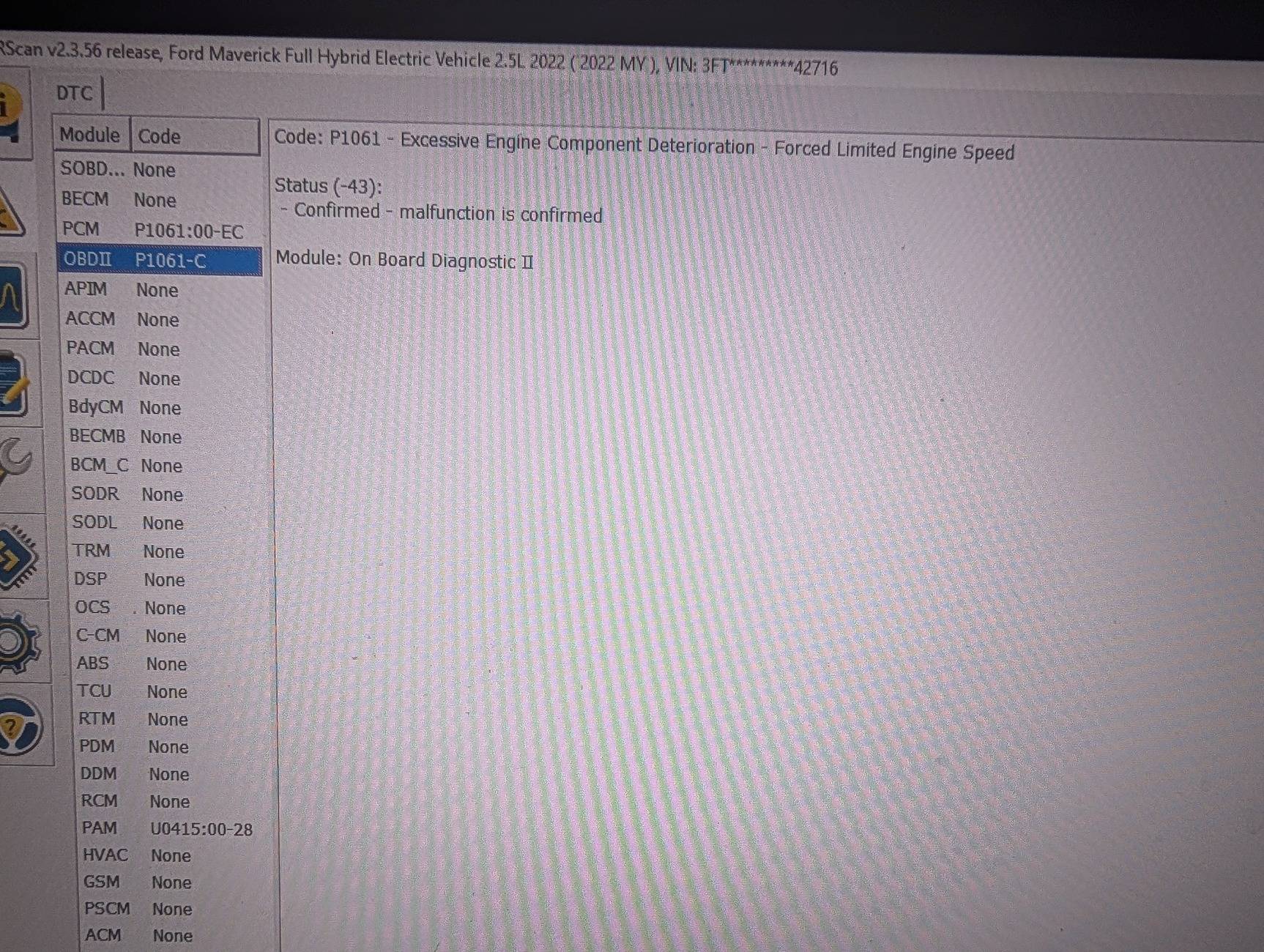

P1061 I can't find anywhere and Iooked through 10,000 codes.
My list is from 2022. P1061 did not exist at that time. So is it new? Or was it a typo?
It was defined as part of the bearing knock detection strategy PCM update.

Add me to the club. My 2022 Hybrid with 38k miles went into limp mode yesterday with P1061 code. Appointment made for Tuesday.

I heard back from the dealer today, engine needs replaced due to a spun rod bearing.
They "anticipate" the necessary parts to arrive on Monday. This may happen quicker than I was anticipating if I'm lucky.
Ford also told me they would reimburse the cost of a rental until I get my truck back. I'll be looking into that today.

EDIT: As of June 26th, it seems the problem relates to the recent CSP about the faulty rod bearing. My Maverick is getting the one-time engine replacement. Timing chain replacement noted below appears to have been unnecessary.
Engine swap was completed Aug 5th, will report if further issues arise.
I updated the title to better reflect the threads content.
TDLR timeline:
  • May 6th: Problem first occurred. Dropped off at dealer
  • May 8th: Vehicle returned after 'software resets'
  • May 17th: Issue occurred again. First dealership reset software to make drive-able, but did not offer rentals, so I took it to another dealer. Problem re-occurred again on way to second dealership.
  • May 22th: Vehicle returned, after dealership conducted 'diagnoses and software fixes'
  • May 23rd: Issue occurred again, and vehicle returned to dealer
  • June 5th: Buy back request submitted to Ford
  • June 6th: Vehicle returned from dealer. extension work conducted (replacement of knock sensor and all timing chain components)
  • June 14th: Problem occurred again. Vehicle dropped back off at dealer. Ford buy back 'still in review', should hear back in next 5 days. Contacted lawyer to review legal options in the event Ford denies buy back.
  • June 18th: Dealer called and said they haven't found anything, more updates EoW.
  • June 19th: Ford denies buy back request
  • June 21st: Ford buy back team denies my escalation, stating they will not reverse their decision.
  • June 26th: Dealer is now working to replace the entire 'long block' . Waiting on parts. They were unable to give me a time frame
  • July 29th: Crate engine received from Ford and swap begins.
  • August 5th: Swap completed and vehicle picked up. Will report if any further issues come up.
