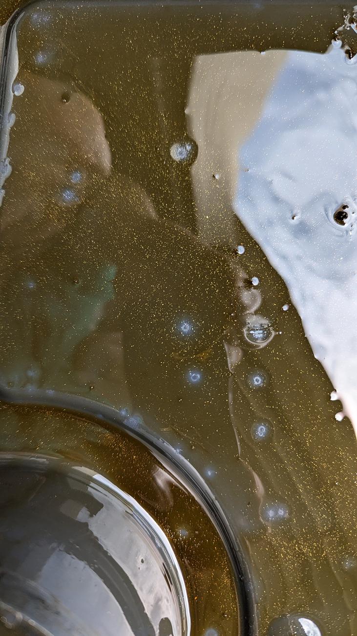

Thank you for posting. My Feb '23 XLT Hybrid w/ less than 15k miles went dead (got in one morning to start the car and no lights or power at all) under 2 months ago. I was able to jump it to drive to the dealer, did not really elaborate on the work they did, but had to order some parts and it was there for 1.5 wks (no rental provided). Was working fine until a few days ago, woke up, got in car and same problem. I have yet to bring it back to the dealer due to my schedule, but at this point, I don't have faith in my truck. If the dealer is going to repeat the same repair, then I think it is safe for me to assume it's going to fail again. Will post an update once I get things sorted out, but does not seem promising.
