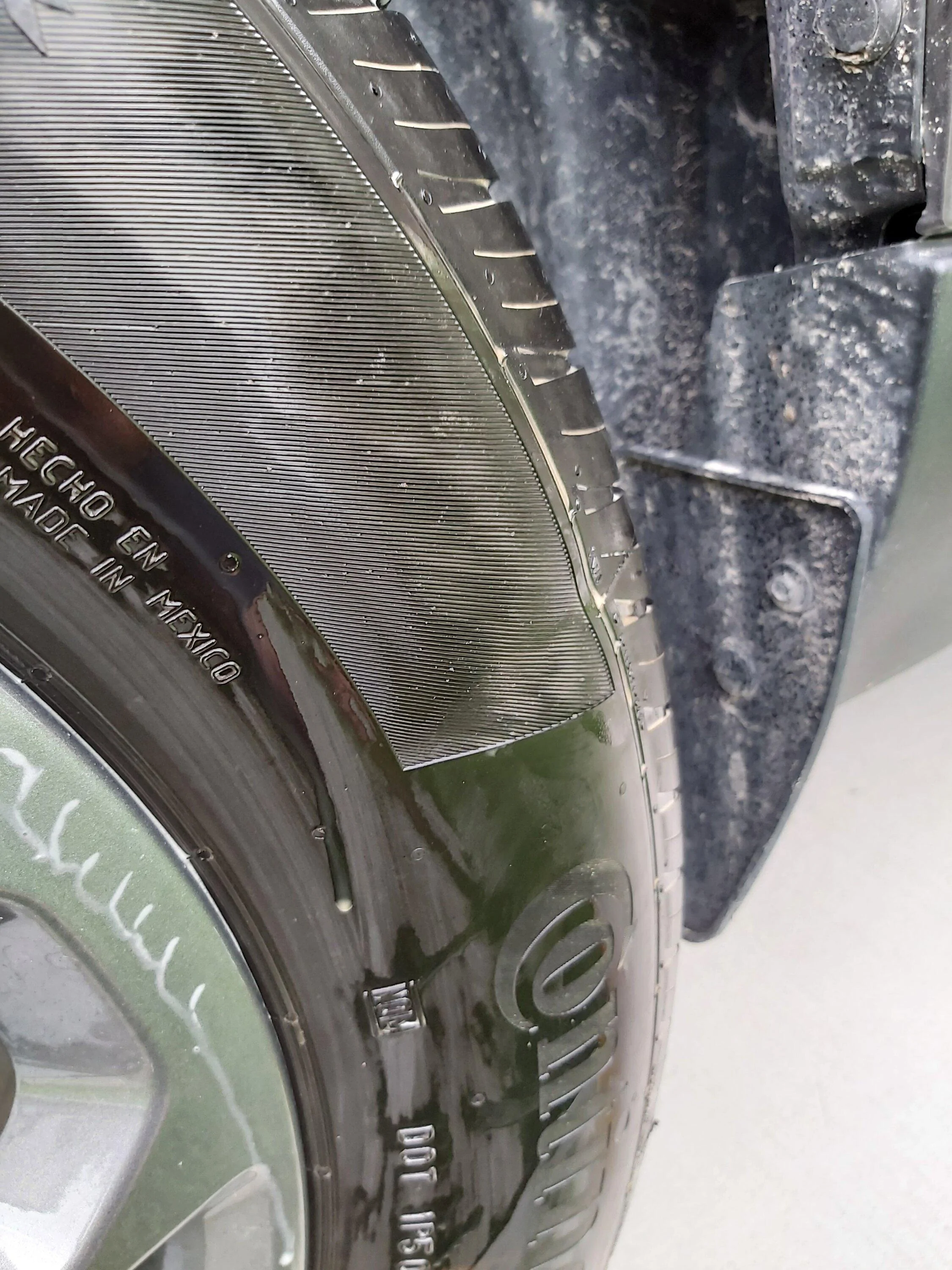

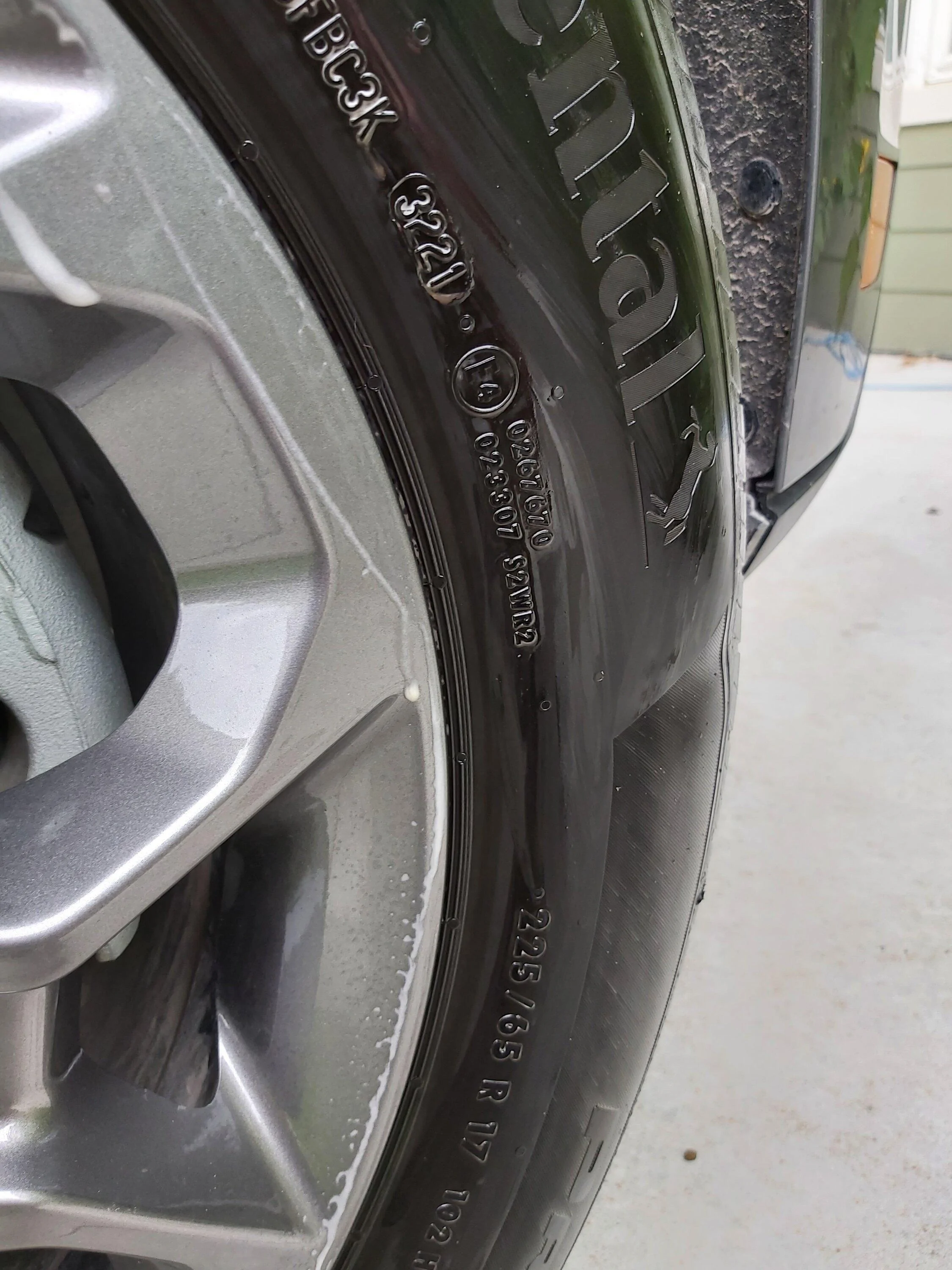

Very common on tires. So much so, that manufacturers almost all put out bulletins saying this is normal of radial construction. Many new vehicles have these indentations.

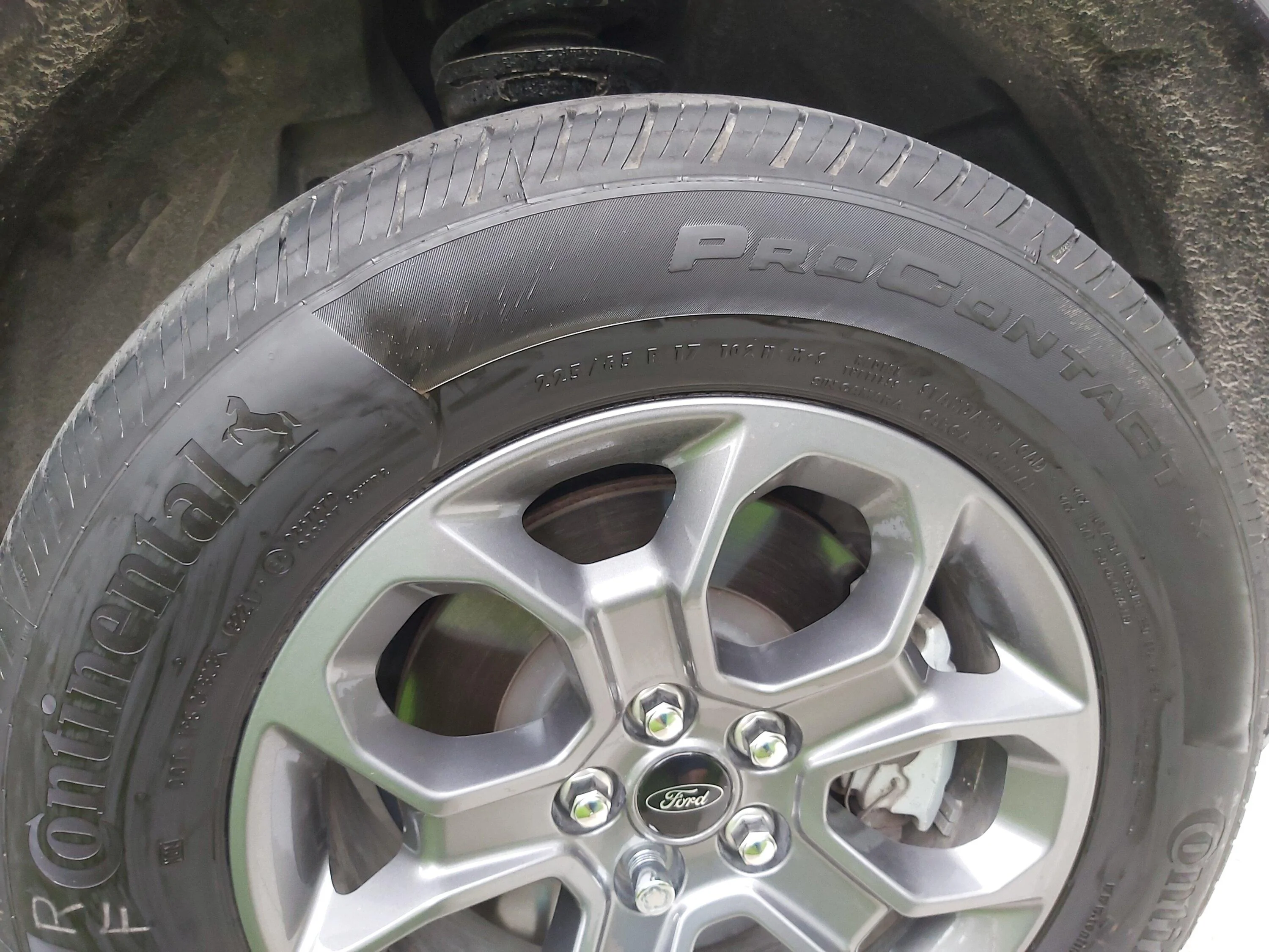

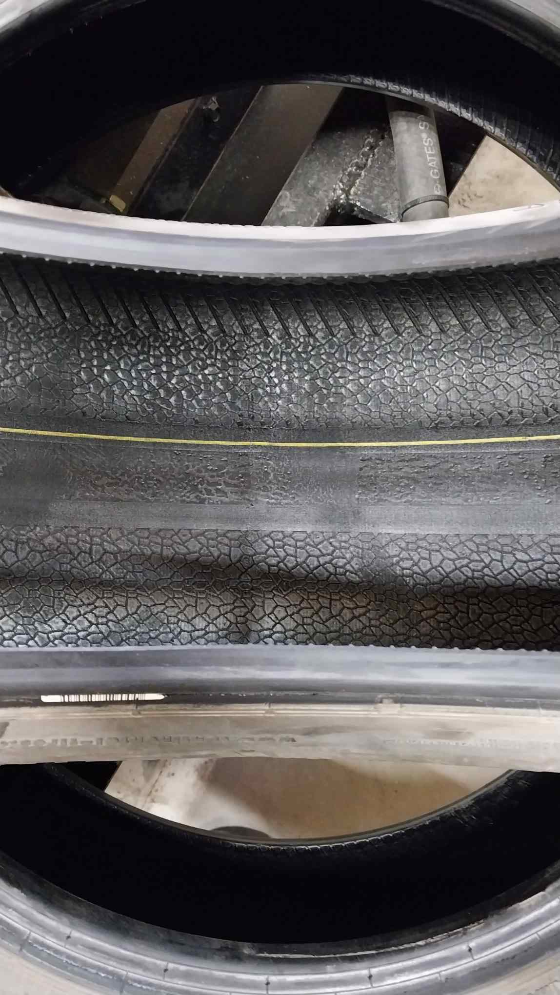

I've had our Maverick 3 months shy of two years now, have just under 13,000 kms on it now, and half that time on different rims and snow tires. Was just detailing the OEM Continental tires, noted depressions on the sidewalls on two tires. I don't think this a safety issue, and wonder if a dealer would consider this a warranty item? Dunno how well you can see it in the pics. Anyone else finding this on their XLTs?

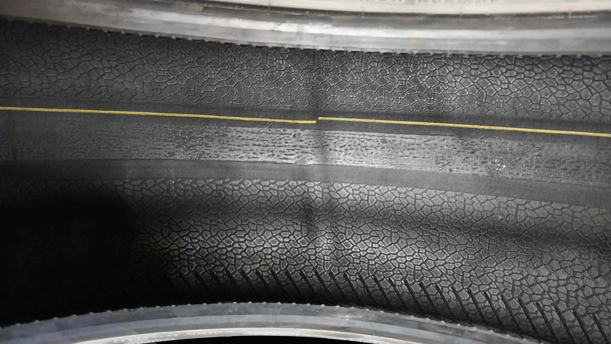

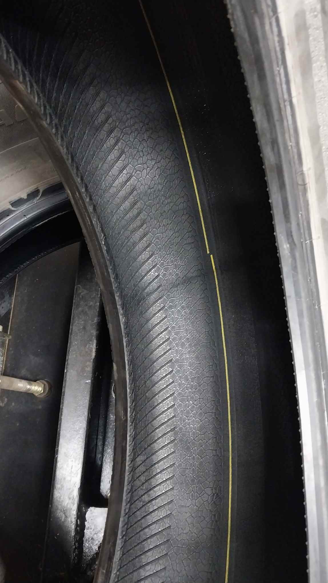

The divots correspond to the layers of rubber where they join and are vulcanized inside the tires. The dark bands below. Not a defect but visible because of how incredibly thin the sidewalls are. They feel like a bike tire.

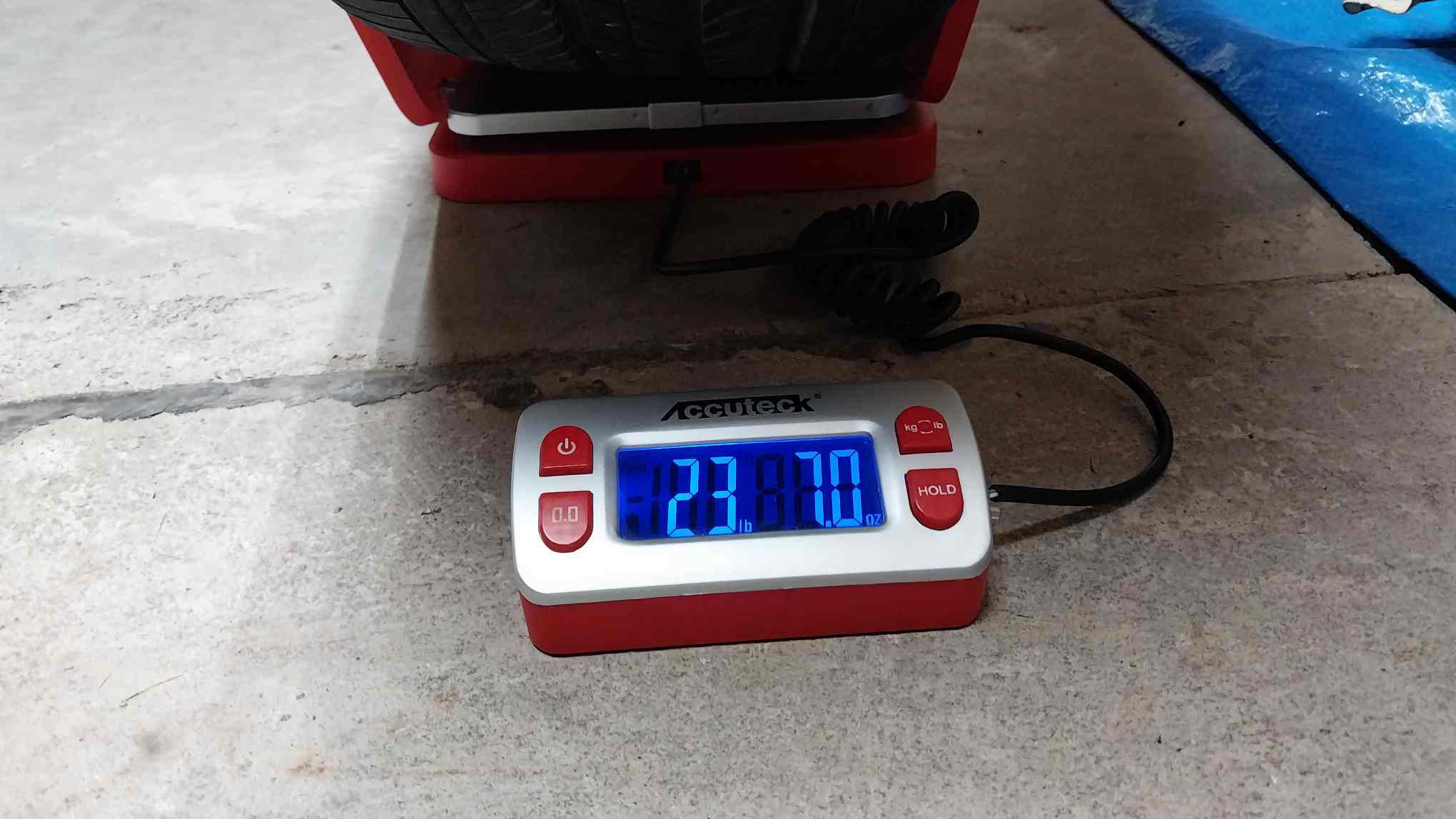

You can see by the weight there is not much tire there. The 108 load range tires I replaced mine with weigh 34lbs each.

Handling these tires unmounted is an eye opener. The area just off the tread as it transitions into the sidewall is extremely thin and flimsy. It feels like a hotel room vinyl curtain or a heavy shower curtain.
Yeah, they suck. I cant push a plug through because it keeps collapsing. I hate the idea wasting money by replacing them with something better, but then, seeing how thin the sidewall is, I have to question how safe these tires are....
