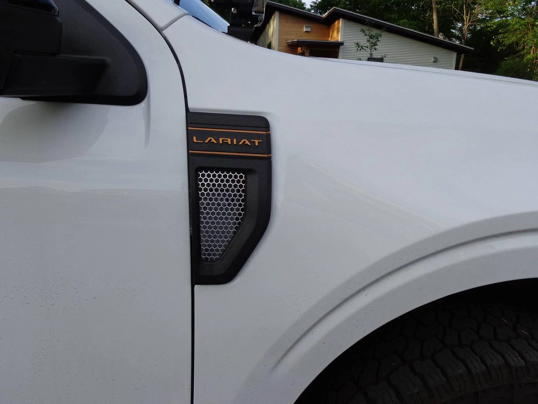

Would 5°F be a stretch? Yes.
The holes are tiny compared the big picture.
I agree. Consider the unsealed hood, and the existing seam between the fender and the front of the door. These vents would be a very minor addition even just considering those.
I get the idea of, "If there's going to be a vent-looking thing tacked on the side of my truck, it should at least be functional". I just look at it as a design element and not a fake vent.

Are you experiencing overheating issues? Is that why you want to vent under hood air?
No overheating issues. Especially with the 4K Tow Package intercooler bits fitted onto the Lobo.
When the redesigned Toyota/BMW Supra came out years ago - the only criticism was the fake side vents. “I’m sure there are cutouts underneath to add functional vents” the fanboys said. There were not. The kits available to make them functional cost big bucks & require much cutting.
I installed the OEM Functional Side Vents on my Maverick as a hat tip & homage to the Ford Engineers & Designers who put that huge cutout in place. Good on ‘ya mates:)

If by "bit" you mean 0.001 °F, then yes.
This is a cosmetic mod.
Ford carries at least 3 products from Air Design on the official Ford Accessories menu - front lip spoiler, rear tailgate spoiler, and the open side vents. Yes, all 3 add cosmetic appeal - but all 3 also have a measurable function however dinky.

OP, I think the vents look great and to your point, while it is minimal there is *some* measurable benefit to installing them.

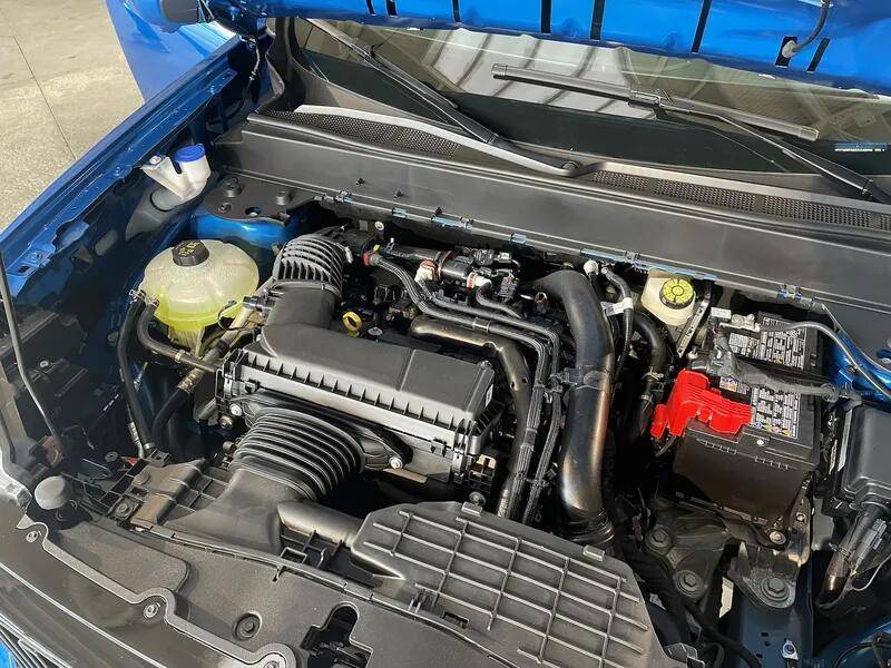

Not my cup of coffee but to each their own. I would be more concerned with the introduction of sand, since the OP lives in the desert, into the fenders. Sand clogs drain holes really well . Here I wouldn't want another source for the yellow pollen of death to get under the hood. As to lower under hood temps I doubt much air flow will happen past all of the stuff under the hood to get to the vent. If engine compartment heat was migrating to that area then it would be heating the door seals .
Take a flashlight and look back behind the windshield fluid reservoir to the backside of the vent. After only 300 miles on the closed vent I have some dust back there. The dust travels from the front/grille to the rear of bay.
While driving, the airflow should push hot dusty air flow out of the vents.
One thing I have already noticed on my new Maverick is how dusty the engine bay gets. My previous Corolla Hatchback and GMC Canyon would go months without accumulating enough dust to see. I know - a cowboy like me should not be worried about dust for crying out loud. Reminds me, need to pick up some swifter dusters when at store.

Doesn't fit in fender recess- looks tacked on. I doubt it has any functional advantage. I'll pass on this one

The purpose of heat extraction vents are to minimize heat soak. OP states he lives in the desert too.
Not totally cosmetic. Underwood temps will be lowered by a few degrees. Something like a 20 or 30 F difference would be a stretch, but could it be 5 F or so? Absolutely.
I could see 5 degree drop on an Ecoboost in a desert environment. And anyone who's ever driven in the desert on a 120 degree day knows how important it is. Maybe 2-3 degrees drop on a Hybrid on the hotter days.

5F decrease in underhood temps is overly optimistic. These vents are about 2 square inches each, or 4 square inches total. That is 0.0277 square feet. Guestimating, the Maverick currently has around 5 square feet of vent space out of the bottom of the engine bay and back of the engine bay at the transmission tunnel. So adding these vent will increase the ventilation capacity by 0.554%. That is not enough air flow to make a measurable difference in under hood temps.
This is why I have a set of the Air Designs for sale and went with my own semi-functional stockers. The ADs are just too big.

I have looked. And you agreed to my point that enough dust gets in there without creating more holes for it. I guess you did install a way to wash the dust out easier.
I’ll take an additional half a percent improvement:) Although I think it closer to 2.23% improvement.
