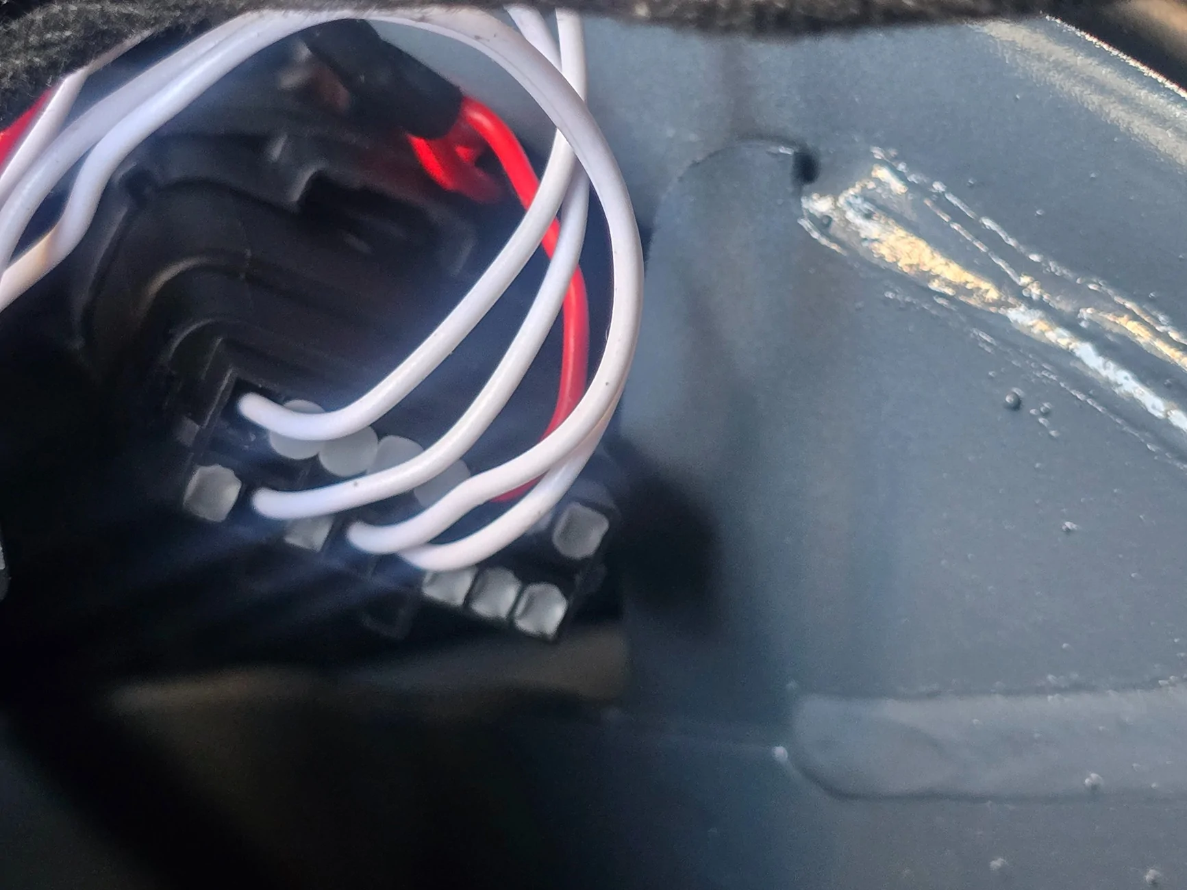

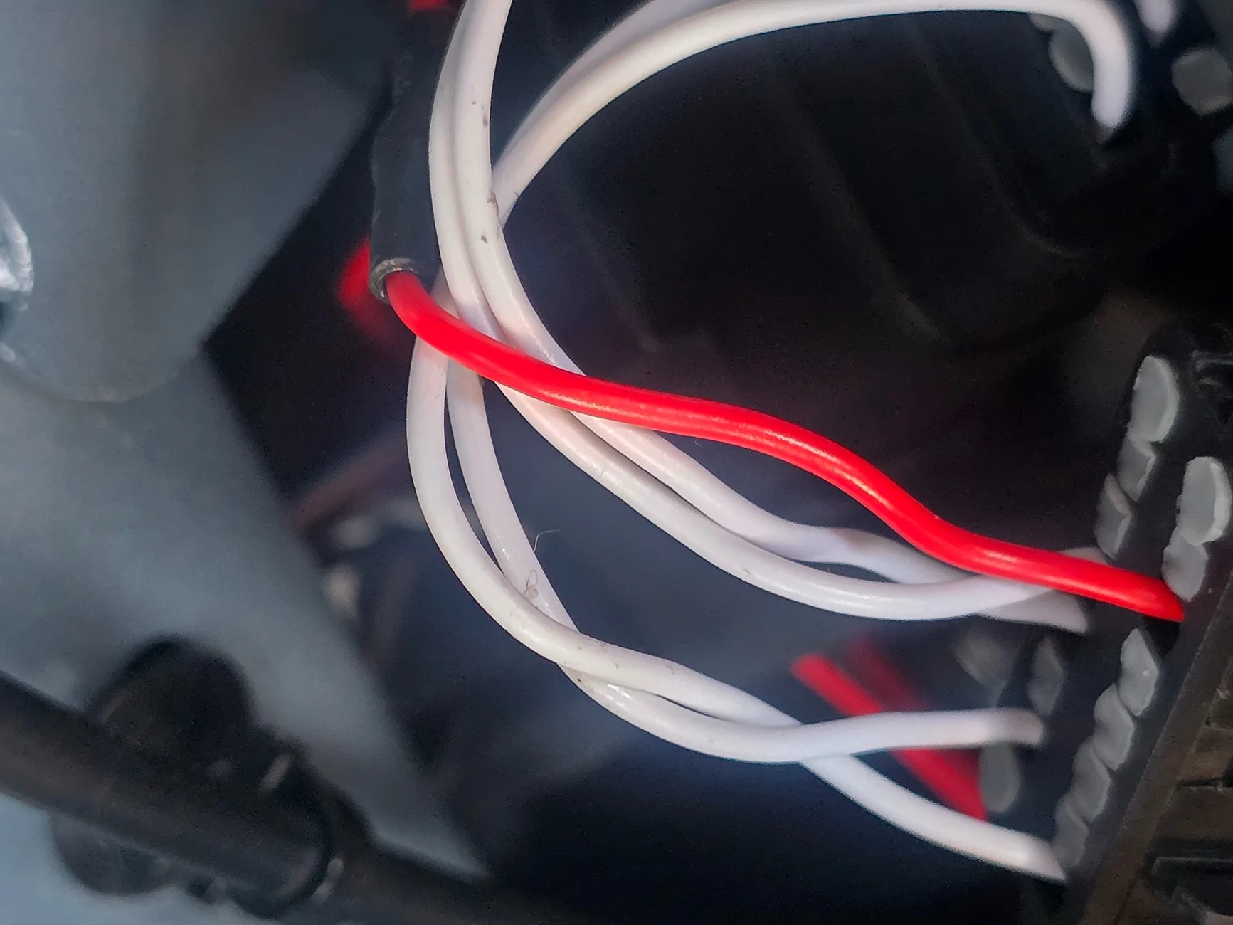

Did a quick search, but couldn't find this. The website says they specifically will not work on '25/'26 Lobo, Lariat, or Tremor. The thing is, the best I can tell, it's only the DRL portion of the piggyback harness that doesn't match, and that can just not be connected...? Happy to have someone tell me I'm late to this knowledge or that just running off the turn signals will burn the truck down, but it's working...

You are correct. They work for the signal lights but it’s the wrong connector for the headlight component. I have it on my 25 Lariat. So no running lights. I do get hyper flash with mine though also.

I don't have that issue. I had already replaced all of my turns with LEDs with resistors built in.
