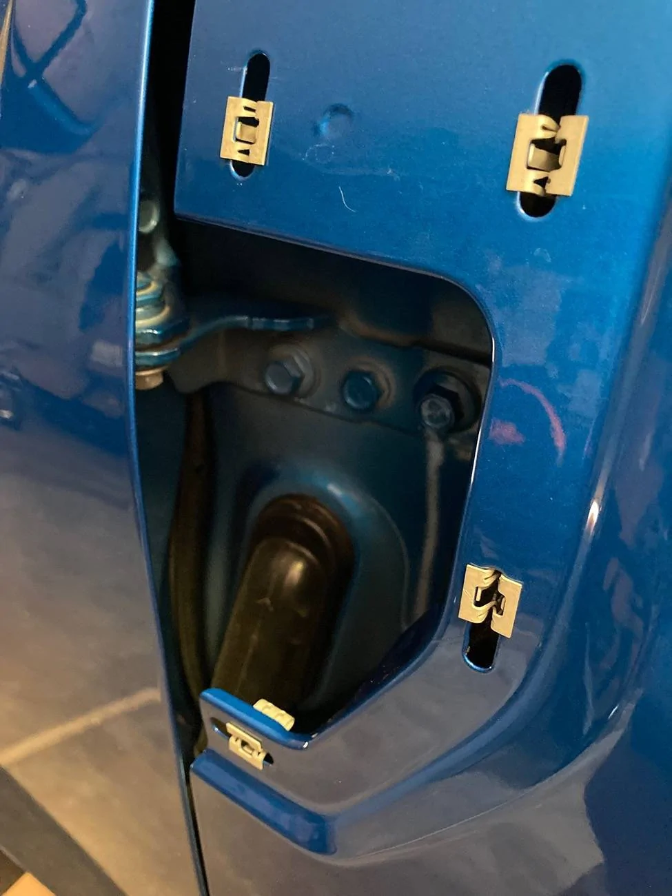

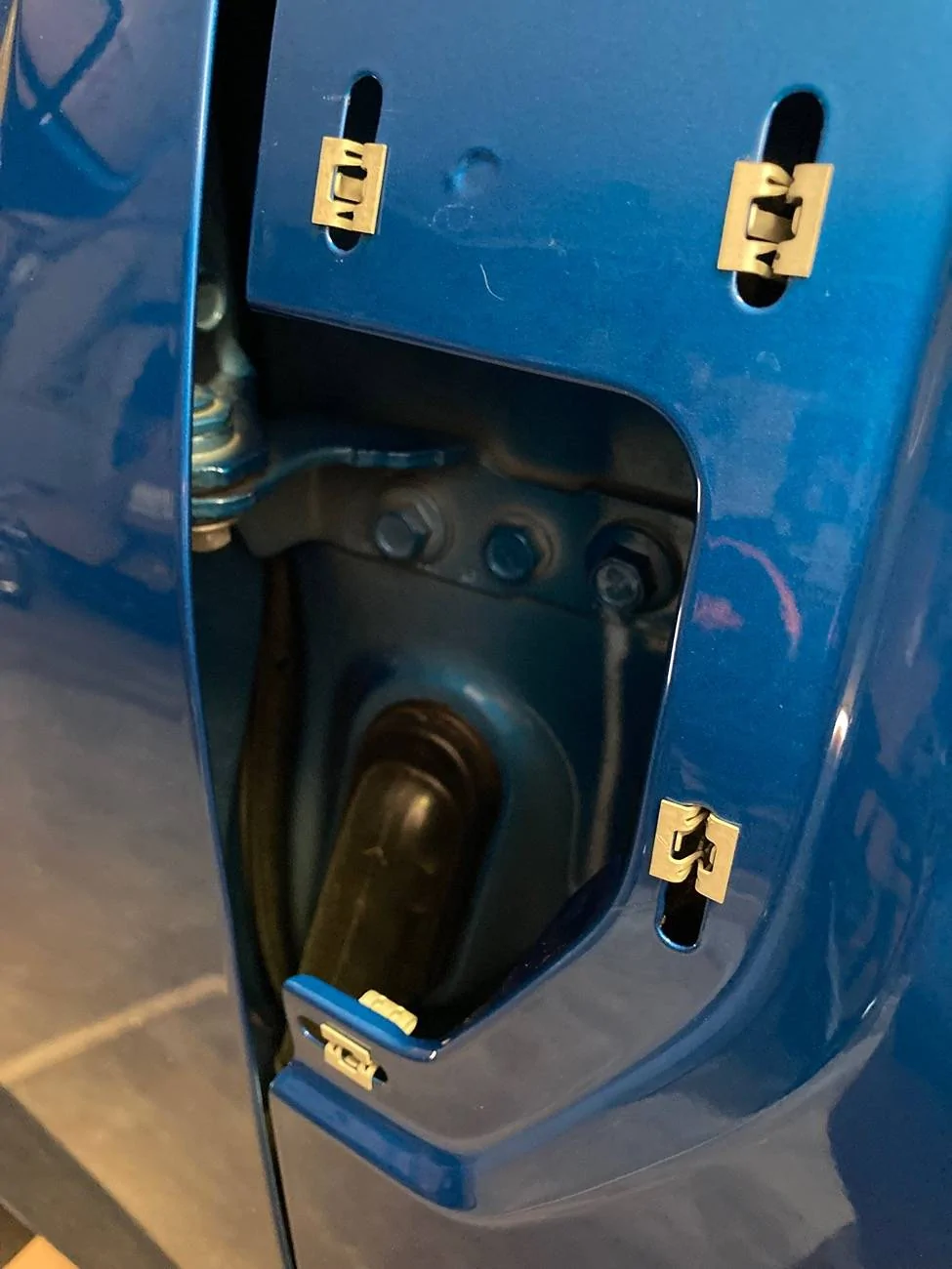

If you look at
Ford Maverick OEM Functional Side Vent Install Pics IMG_3078
VS
Ford Maverick OEM Functional Side Vent Install Pics IMG_3077
You can see that more than 50% of your potential airflow is being blocked by 3D printed plastic. If you wanted to actually know if there is any function at all, you could block them off, mount a WiFi thermometer under the hood, drive around for a half hour or so, then stop, pop the vents out and remeasure the temperature. Personally, I’m betting it’s no more than -2 F with wide open holes in sheet metal vs no venting.
Add in 3D printed vents that restrict more than 50% of the airflow and they are cosmetic only and not functional.

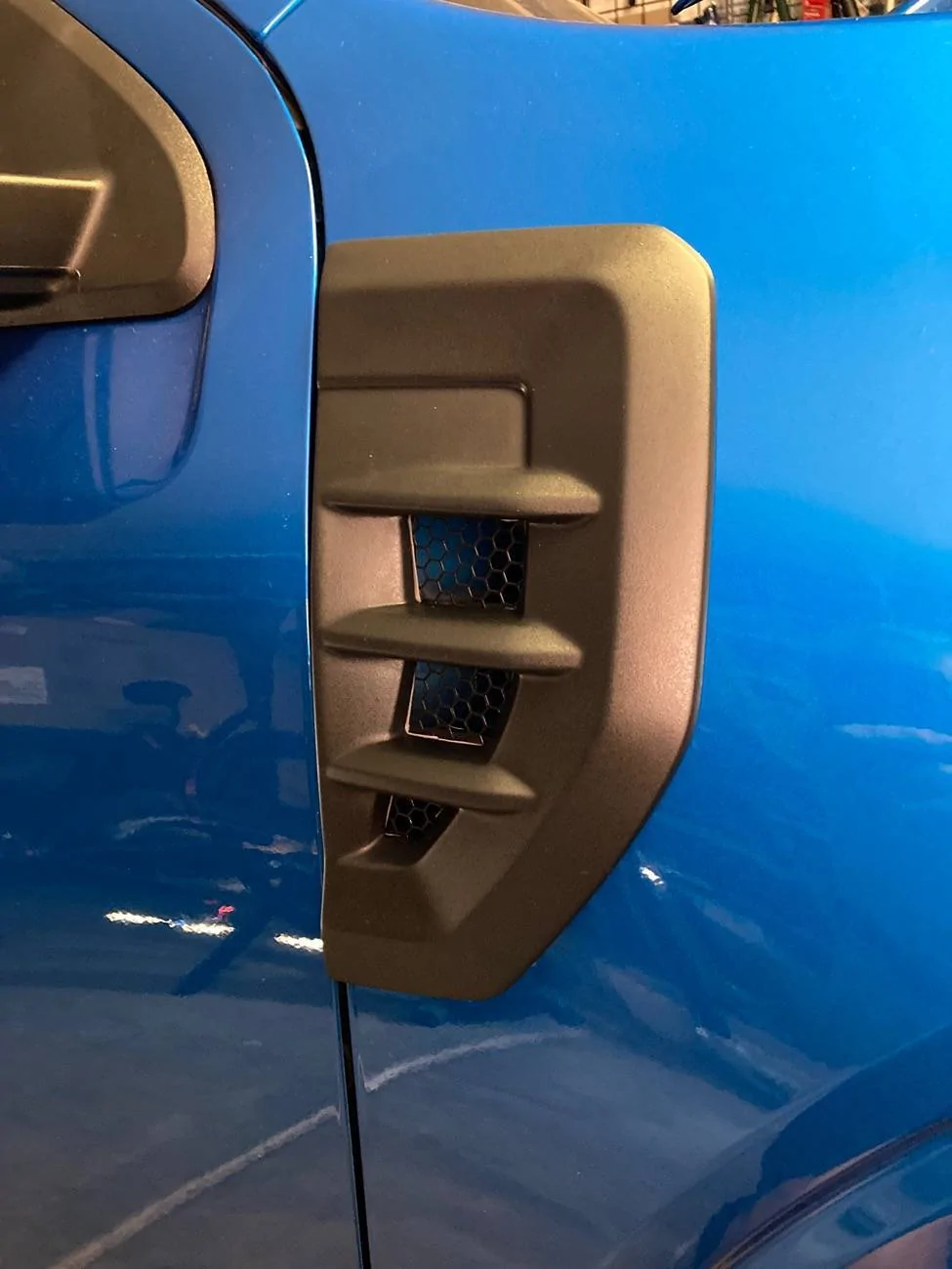

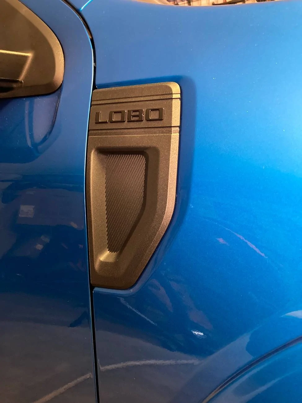

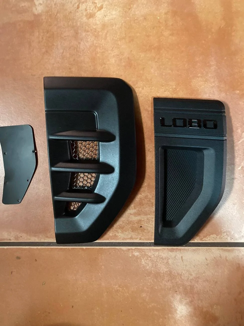

Took my first test drive with the vents. A bit concerned they might whistle/rattle/hum…but none of that whew. Got up to 65mph because still in break in period.
When I returned home to my garage, while letting the truck idle (as all good turbo owners should do) for a few minutes - I got out and felt the vents.
HOLY CRAP - heat was streaming out of vents. The high idle fan was blowing hot engine bay air out in gops.
When low idle kicked in the blowing reduced. I turned off my beast. 20 minutes of sitting in garage & heat is still coming out.
So I’m raising my engine bay heat reduction to 5%++
450 Fahrenheit to 425 or lower here in the desert driving “spirited”. Heat rises, the vents are up high, and if heat is blowing out at idle - I can only imagine the heat extraction at speed.
This is available from Ford Accessories fyi. Here are some before and after pics:
HOLY CRAP - heat was streaming out of vents. The high idle fan was blowing hot engine bay air out in gops. If I had a smoke machine there would be clouds of smoke exiting:)
When low idle kicked in the blowing reduced. I turned off my beast. 20 minutes of sitting in garage & heat is still coming out of the vents.
So I’m raising my engine bay heat reduction estimate up to 5%++
