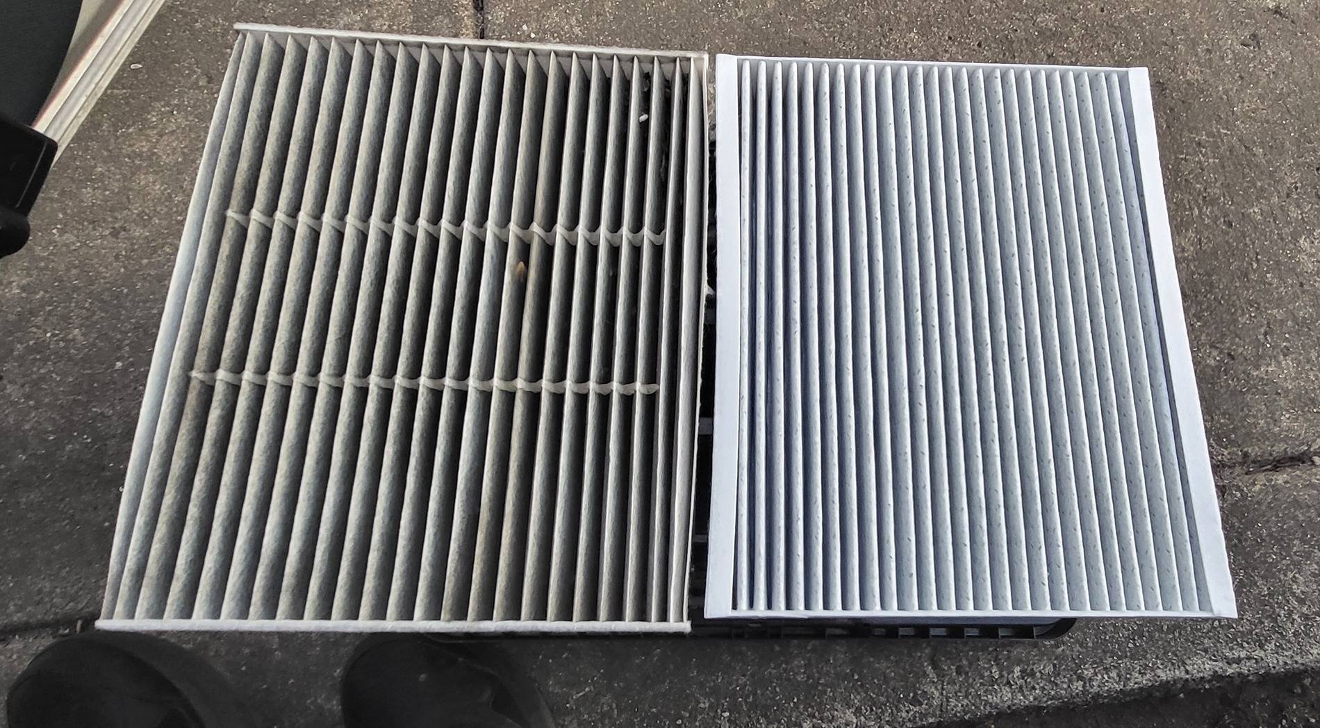

Replaced mine this week at 30000 miles when I replaced the (required maintenace) engine air filter.
Ford Maverick OEM cabin air filter thread with links and pics.  Premium OEM vs. regular OEM. 20250416_201848
⬆ Maverick cabin air filter - old / new.

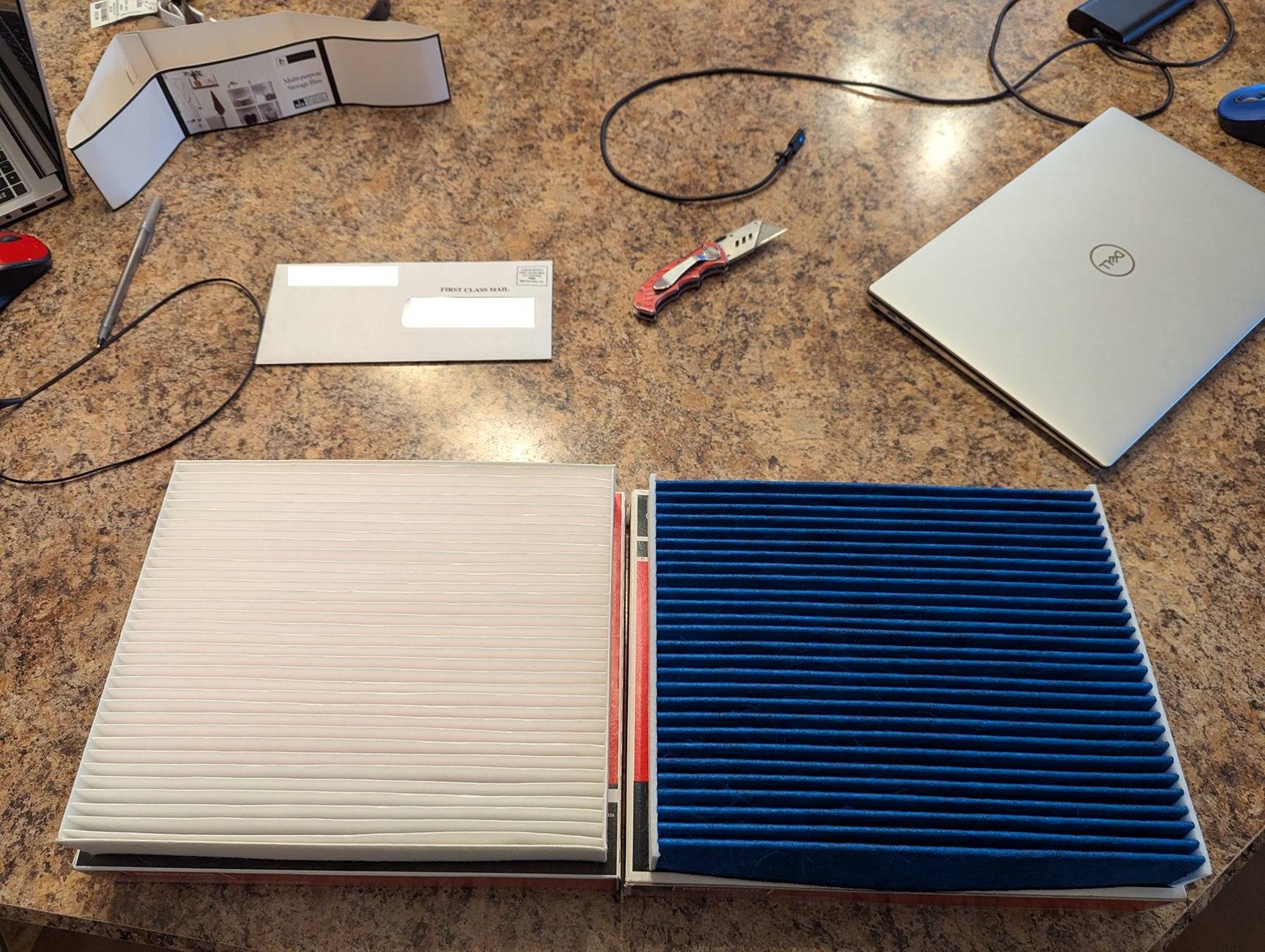

I will preface this by saying yes I know you can buy cheap non OEM filters off Amazon. This thread is not about that. This thread is about OEM Motorcraft cabin air filters.
So today I replaced the cabin air filter in my 2022 Maverick with around 18K miles(29K km). I purchased two filters. One was the stock OEM filter that came in the vehicle(FP-100-A)the second filter is Fords premium cabin air filter called micronAir proTect(FPP-89). This filter is a direct replacement for those looking for the fabled Refresh95 cabin air filter.
For those wanting a premium cabin air filter for there Maverick I hope this thread is helpful. I will post links to each filter for those interested. The links are to Fords official parts website but if you punch the numbers into a place like Rock Auto they will be cheaper.
Links here:
FP-100-A regular cabin air filer
FPP-89 premium micronAir proTect cabin air filter
Side by side box comparison of the regular filter on the left and the premium filter on the right.
Unboxed picture of each filter side by side.
Side by side comparison for size reference.

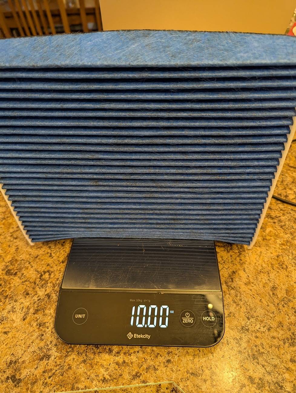

The regular OEM filter weighed in at just 3.7 ounces(105 grams).
The premium filter weighed in at exactly 10 ounces(283 grams). I was really surprised by the difference.

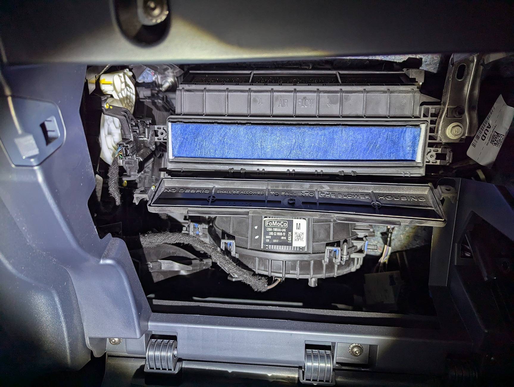

Here is a picture of the premium cabin filter fitting just fine into the Maverick. The lid closed fine I just left it open for the pic.

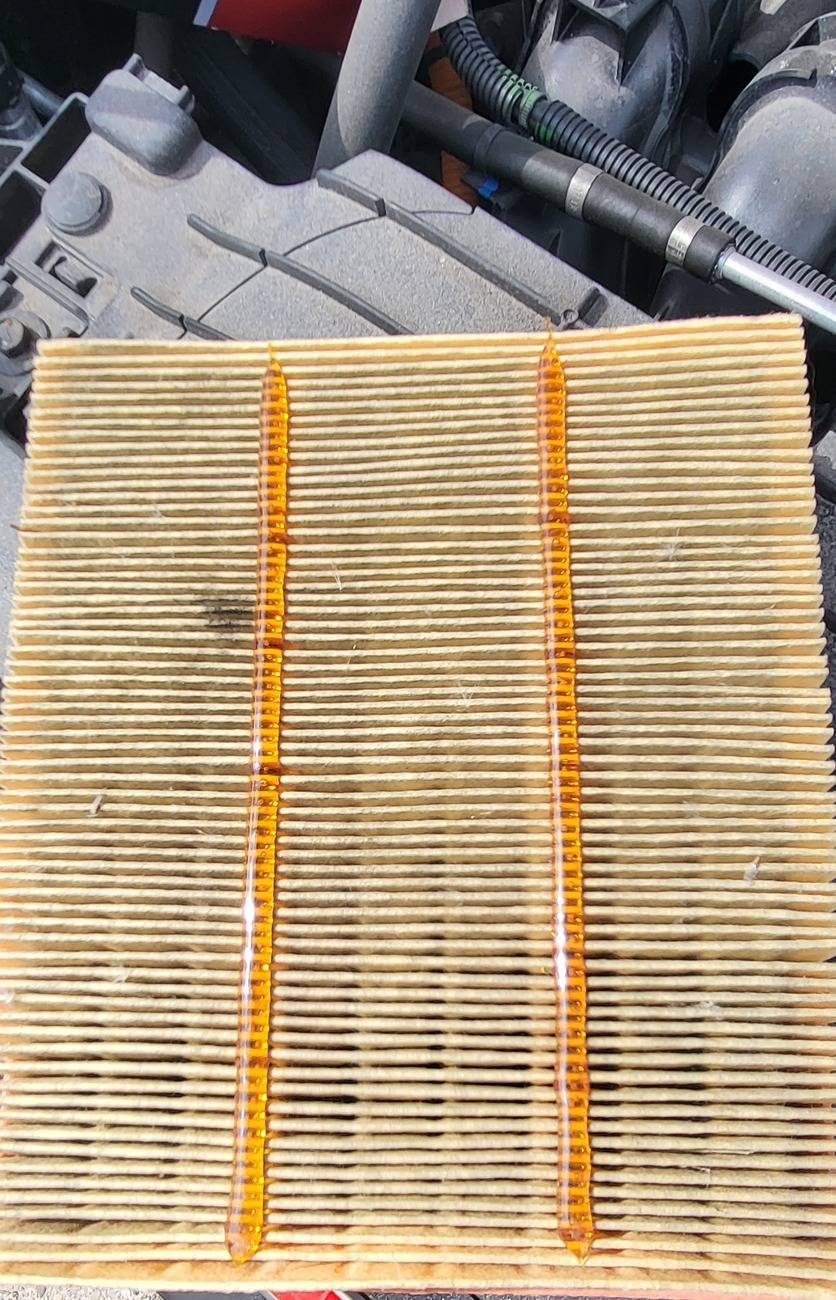

Here's my cabin air filter after 10K miles in Baja. Second replacement- dusty down here!
Ford Maverick OEM cabin air filter thread with links and pics.  Premium OEM vs. regular OEM. filter10k
:unsure: Isn't that the engine air filter?

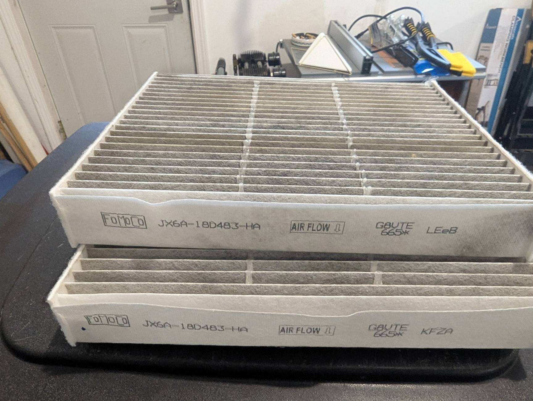

Changed mine first time at 36,000 miles.
Easy.
Old one did not look bad.
Did have fragments of electrical wire harness friction tape on it though.
I DO think you can Tap, Shake, vacuum or gently blow them off and put them back in. At least city dwellers could.
Added a CHEAP $9.99 charcoal one. Ya. Double the pleats and about triple the weight. Was just a few bucks tariff free.
