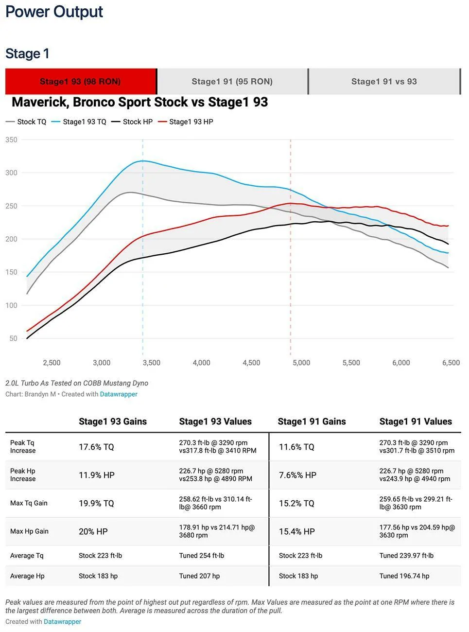

no their baseline is premium stock, not 87. I have not seen a 87 dyno plot.
Are you saying the "stock" curve here is run on premium fuel? I looked and could not find a citation about what fuel was used, but if I were a company marketing tuning I would want to show the largest gains, which would have obviously been versus the allowable 87.

...if I were a company marketing tuning I would want to show the largest gains, which would have obviously been versus the allowable 87.
That would be an irrelevant and possibly sneaky comparison. If owners can already get more power on the stock tune with 91, why would the baseline for comparison be 87? It's not like you're locked out of 91 without a tune, so the most straightforward and ethical comparison a company could show is apples-to-apples with the same octane rating.
Even if they were marketing a tune for 100+ octane racing fuel, they would still start with premium fuel as a baseline.
yes. the dyno chart compares the stock ECU map vs their tune, and they definitely use premium on the stock run because the truck specifically says premium for maximum performance.
Sure, the owners manual says premium for best performance, but it also makes clear that 87 is acceptable, and the fuel filler door (for the 90% that don't seem to read the manual) says 87.
I'm asking do you know for sure this curve is based on premium octane? If so, how do you know that? Could be, but I don't see it in the notes.
