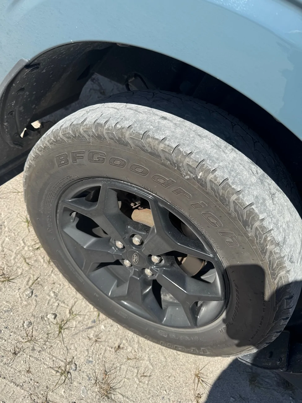

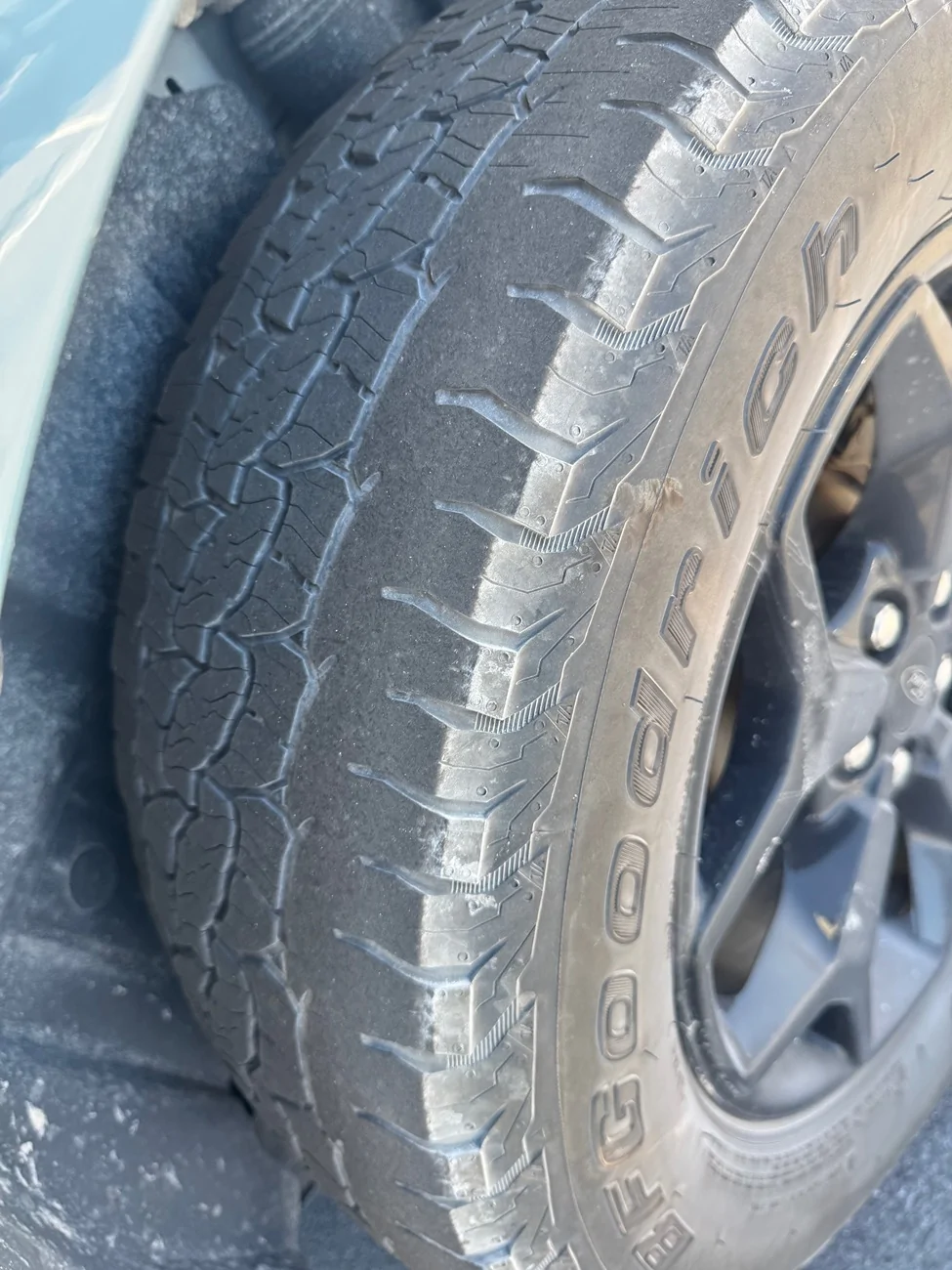

Hey everyone, I’m testing the waters here..
I have an issue with my ‘22 Lariat AWD (2.0l) where my rear right tire has worn exponentially faster than the other 3 tires. The tires are relatively new, <1 year old / 20k miles, and are BFGoodrich Trail-Terrain T/A 235/65R17/XL 108T tires.
Off the bat, I’ve noticed that the rears wore faster than the fronts, which I thought was odd since the front wheels provide most of the propulsion. But, within the last 3 months, the rear right has been wearing down at an extremely fast rate, and primarily on the outer side of the tread. Notably, the wear is not completely uniform throughout the circumference of the tire, but it is close to it and no cupping can be observed.
Now, the redneck handyman in me would suggest this to be the result of too much positive camber, but I can’t seem to find a means to adjust this nor any reason why it would have just started out of the blue.
So I’m here to crowdsource some ideas from you all, the hive mind. Thanks in advance for any constructive suggestions you can offer!

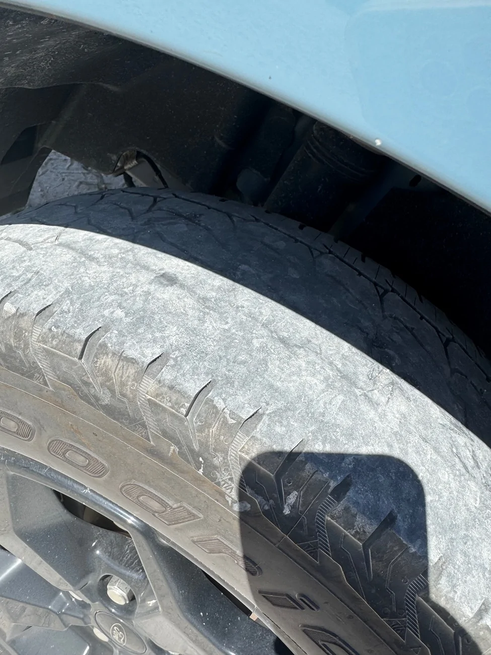

*For reference, the first two photos are of the right rear tire in question, and the third is the left rear tire for comparison.*
Ford Maverick Odd tire wear, possible alignment issue(s)? IMG_4992
Ford Maverick Odd tire wear, possible alignment issue(s)? IMG_4993
Ford Maverick Odd tire wear, possible alignment issue(s)? IMG_4994

Rear tires are not driven tires, so odd wear pattern indicates alignment issues.
Take it to a reputable alignment shop and have them check all mechanicals, nuts and bolts.
If it has been curbed or you found a deep pothole, well, now it's bent under there and some rear suspension components may need to be replaced.
I have the AWD, so the rears are driven, albeit intermittently. I also don’t know of any specific events of any acute trauma to that wheel (curb, pothole, etc.) that could’ve caused anything to have gotten bent.

Kinda looks like the tire has a slipped belt in the carcass....

I would say you have damaged suspension component(s), and/or alignment is bumped out of spec.
Time to find a reputable alignment shop....
I put 65K on my OEM AT3W's, rotated every 5-10K, perfect wear patterns, FYI...
