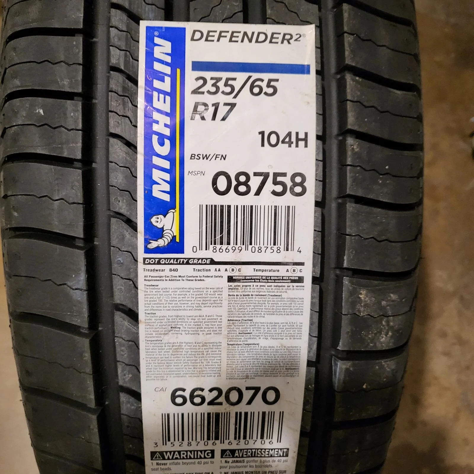

Mar 21, 2023
77
el cajon
2015 Fusion Hybrid
I know this an old post, but wanted to thank everyone. All of you were correct in the diagnosis. Someone recommended the Michelin Defender2's which I just had mounted today, a world of different, no wandering whatsoever, very quiet and handle well!
Anyways, thank you all for your time and input🙏🙏
