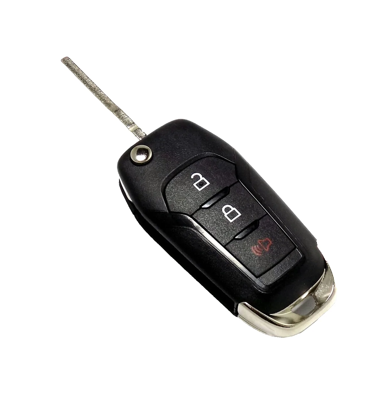

Don't the keys have codes that the vehicle recognizes? I ask because today we went for a ride and stopped a few places then stopped to walk the dog. I locked the doors. On the way back I clicked unlock on the key fob and the doors wouldn't unlock. I used the key to unlock the doors manually and got a message that said something about the vehicle alarm going and to stop it to put in key and turn car on. There was no alarm but I did just that and everything was fine.
Maybe the car didn't recognize the code from the key fob

Yes the fob sends the transponder code over wireless to confirm the fob unlock is allowed.
Yours must not be a failed transponder, or the ignition wouldn't have seen it either, and the alarm would have gone off as it said it was about to.
If you want to recognize the alarm just in case, perhaps somewhere remote or not late - do the same thing, but don't turn the key until the alarm sounds.
Nothing worse than a neighbor late at night not seeming to recognize their own alarm and it going off for minutes on end.
Don't be that neighbor.
And don't let dog chew on fob!
