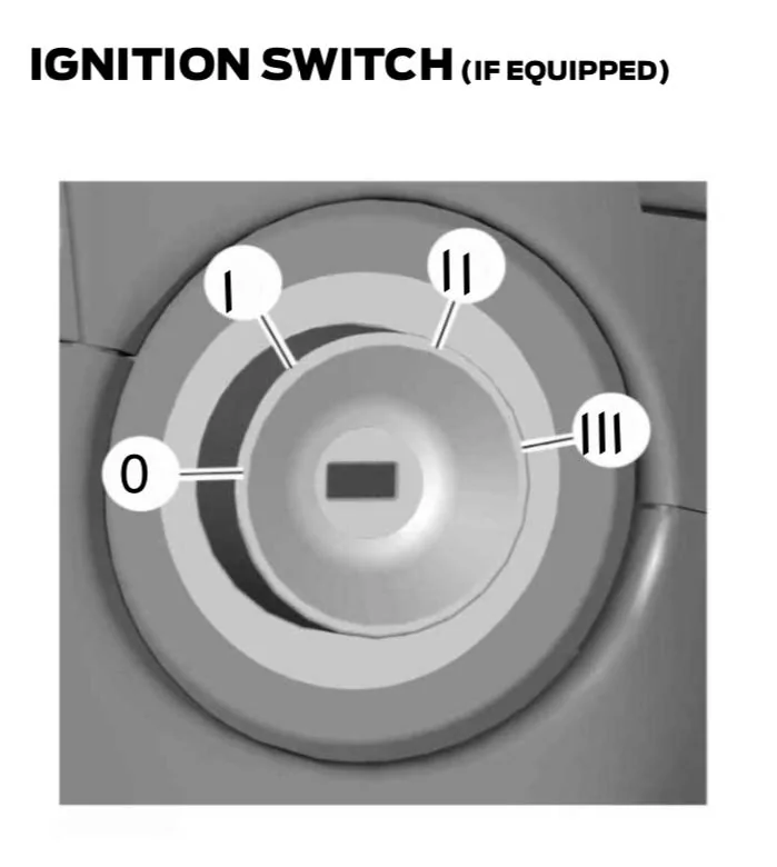

Makes sense so no on can jump in after remote start and drive away. It says to turn key to on position to drive right on my little screen, but it shut off engine. I did edit a post above that it worked this time when I tried it but instead of turning key to on, I went a little further almost as if I were going to start the car, but stopped just before and it kept running. the engine didn't shut off. So I wonder if I just wasn't turning key far enough.
Carlitos_92
Mar 24, 2024
2,518
5,293
Bingo. That is probably it. Position I only gets you accessories. Position II is where you need to be to drive away.

That's a great thought! I will try it later and before putting key in ignition I'll disable the auto start/stop and see if that makes a difference. I'll post how it goes.
EDIT: I could not turn off the auto start stop button but I remote started it this time and put the key in and turned it and it worked. It kept running.
Don't know what I did. The other times I would put key in and click it to the ON position and that was it. This time I went a little further than the ON position, almost like I was going to start it again, but I let it go just before that and it kept running. Maybe that's the trick. I don't know...
Good morning.
I see you have figured it out. You have to turn the key pass the ON position. Welcome to the Maverick family.

I wasn't sure if I should update this or not as it's not a big deal as I'm sure no one else has this issue, especially because it's my stupidity. And it'll make me look like an idiot.
Here we go. I went to the dealer last Wednesday to have some rust proofing and fabric protection etc. I told him how the car shut off when you turn the key and he jumped in after remote starting and put the key in the on position. I said see it shut off and then he put the car in reverse and backed up.
I said I thought the engine shut off, he said no what happened is when you remote started it's hot So the air kicked on high to cool it. When the key is put in the on position the vehicle goes back to your auto settings which I have the fan set lower. So what I was hearing was the fan going from high to a lower setting and that's why I thought the car was shutting off cuz the fan stopped. The engine is so damn quiet that I can't even hear it so I was basing it on the air conditioning fan.
Since then I have done several remote starts, put key in and driven away.
I'm really not as dumb as this 😂
