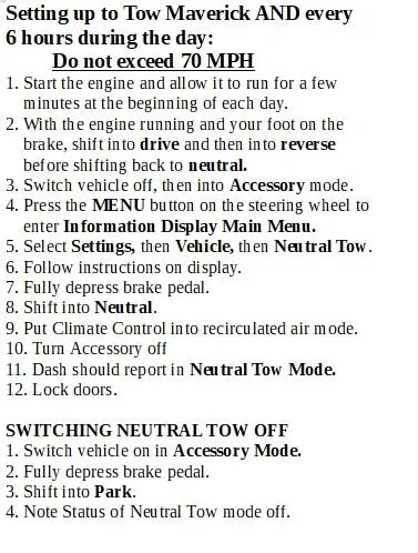

I'm now on the road towing my Maverick Hybrid.
Twice, I’ve gotten it stuck in Tow Mode and had to disconnect the battery.
Any word on a fix ?
BradnChristine
Any word on a fix ?
Are you an XLT? No issues for me with a Lariat. I think the push button start makes it easier to follow the EXACT instructions. Every problem I have seen seems to come from an XLT owner. I made and use a card like this to make sure I remember to do all the steps properly.
Ford Maverick Neutral tow mode - HELP! tow card - no brake buddy
