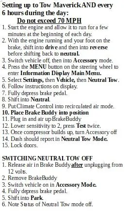

I'm on my second long trip (1350 miles so far since Monday. I follow my cheatsheet card and no issues.
Ford Maverick Neutral tow mode - HELP! tow card pictur

I have towed my 2023 Maverick over 5000 miles . It has faulted out coming out of Neutral Tow after disconnecting 3 or 4 times. I just lift the battery cable for 10 minutes and it clears.

On a road trip now. After two Ford dealer fixes and 2 lost days and one tow truck. I have followed instructions on this forum with no more failures getting out of tow mode. Your break idea with the pressure regulator is working out great.
