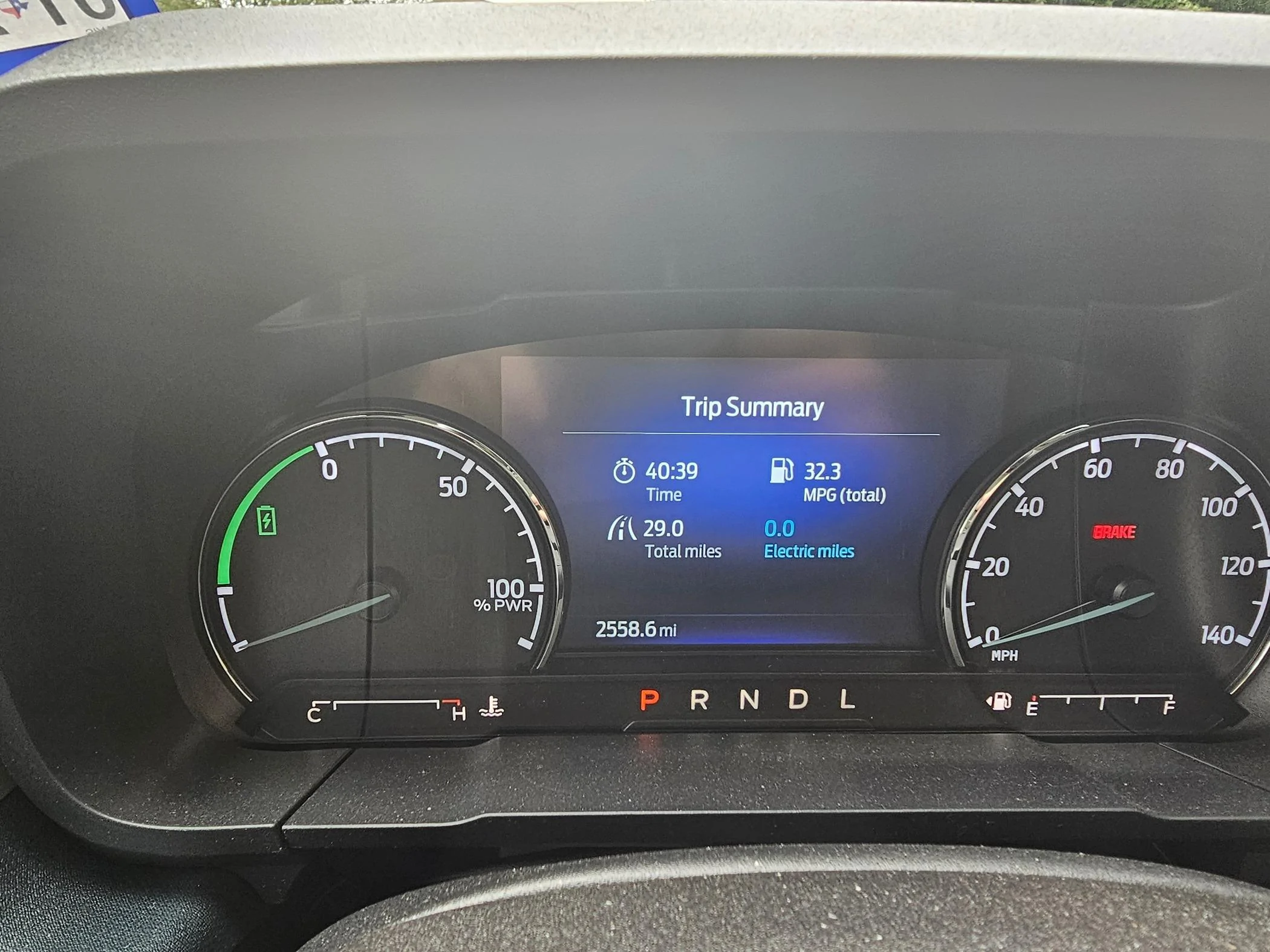

I used tow mode when I was hauling a bunch of dirt in the bed. It used regenerative braking it felt a little more than eco and it never ran in full electric.
Still got better mileage than I thought hauling a yard or more of dirt.
