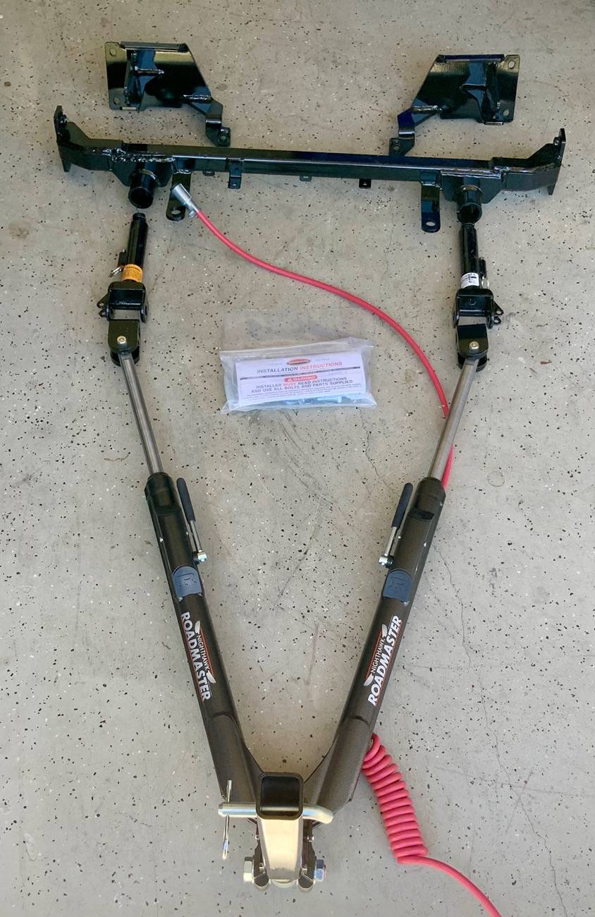

I’m installing my RoadMaster Base Plate this coming weekend I also purchased a new RoadMaster Nighthawk Towbar and a “charge line” good to know the charge line works without any issues - first trip towing my new 2025 Maverick first week of May
