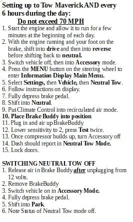

I know that there are folks with XLTs who are successfully towing... I think the procedure is really exact and sensitive, and easier with the Lariat's push button being either off, accessory or running. I made myself a card as I don't want to trust my memory. I use a brake buddy, so it's instructions are in the middle:

Odd as my my owners manual doesn't look like this. Basically, turn switch on, bring up menu, go to NT, hold button down to engage, shift to neutral, turn key off.
This is my compilation of the Ford 2023 manual instructions and incorporating my BrakeBuddy instructions.
The Ford instructions fail to note that Neutral Tow is NOT a menu option in Settings, it is a menu option in VEHICLE, which is the next menu under SETTINGS. Again, this is a Lariat.
Item 6 screen instructions are simply to hold the ok button until the bar is complete.
Note that returning to Accessory after setting up NT to set up the Brake Buddy laves it in NT and you can simply press the button to take it out of accessory and leave the NT uninterrupted.

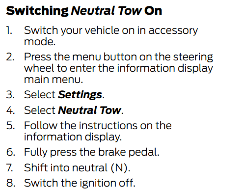

Ford only says:
Ford only says:
