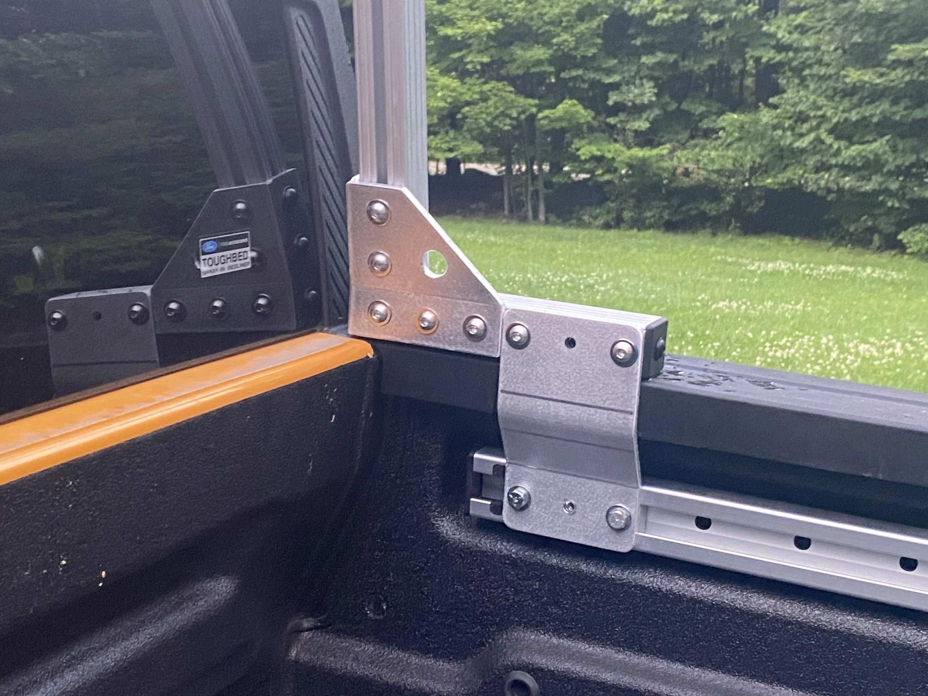

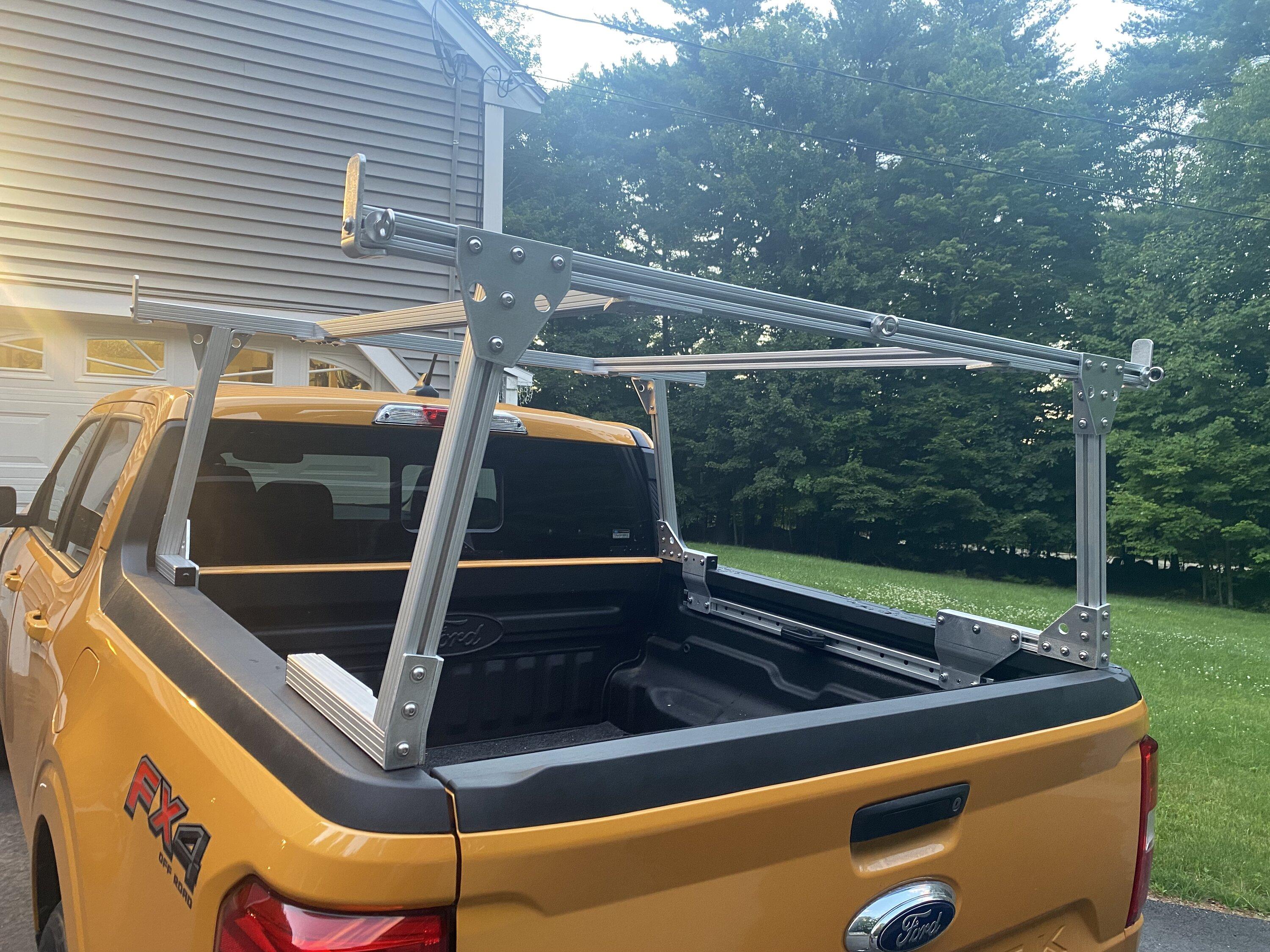

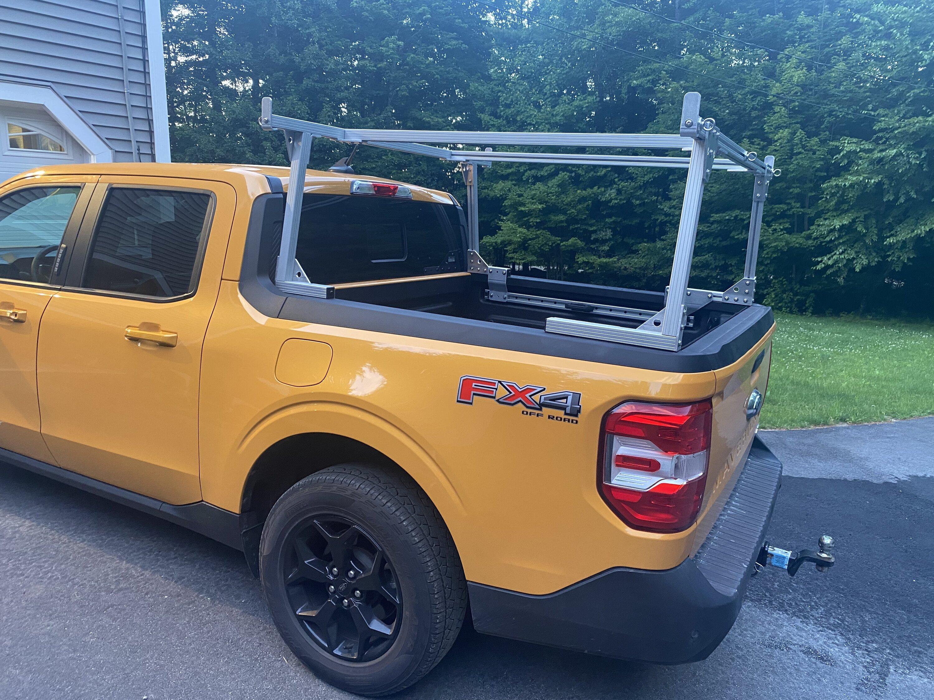

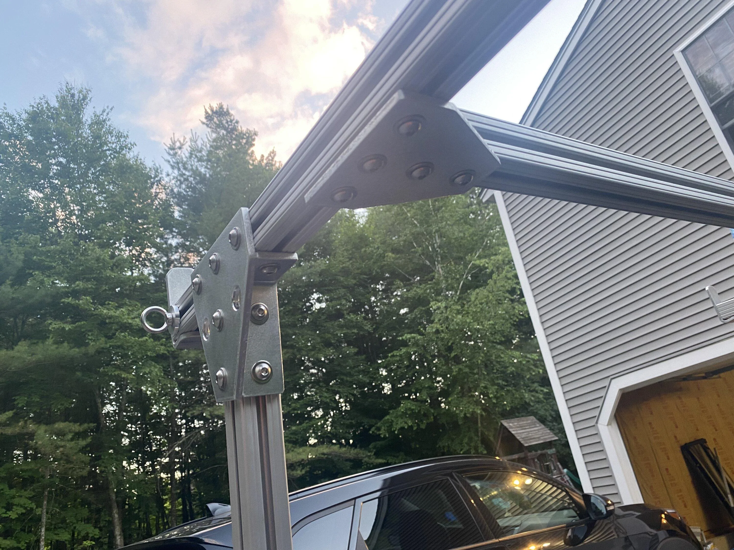

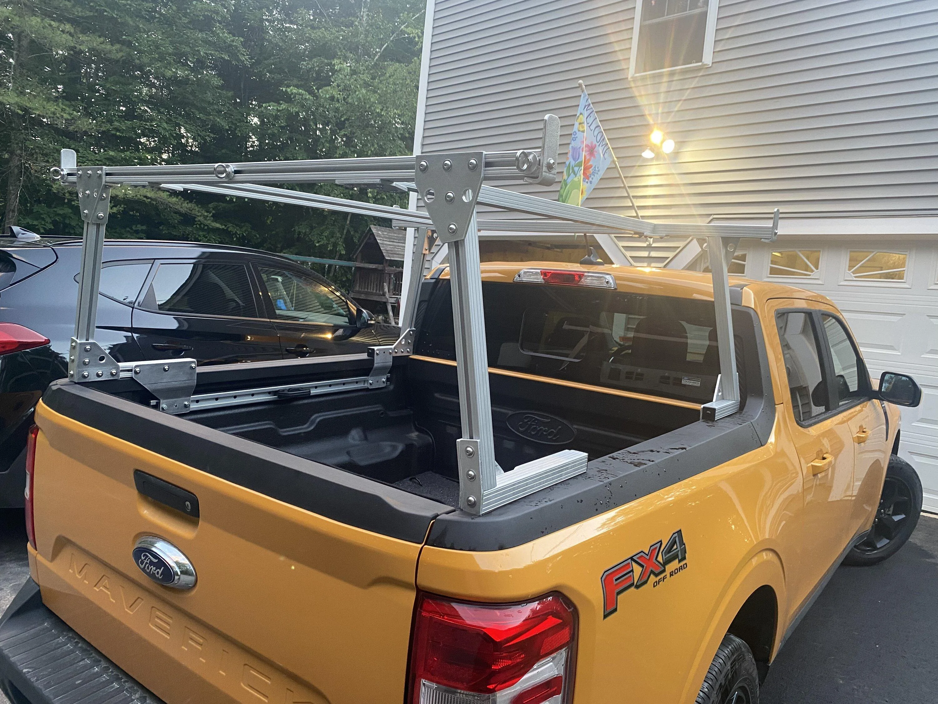

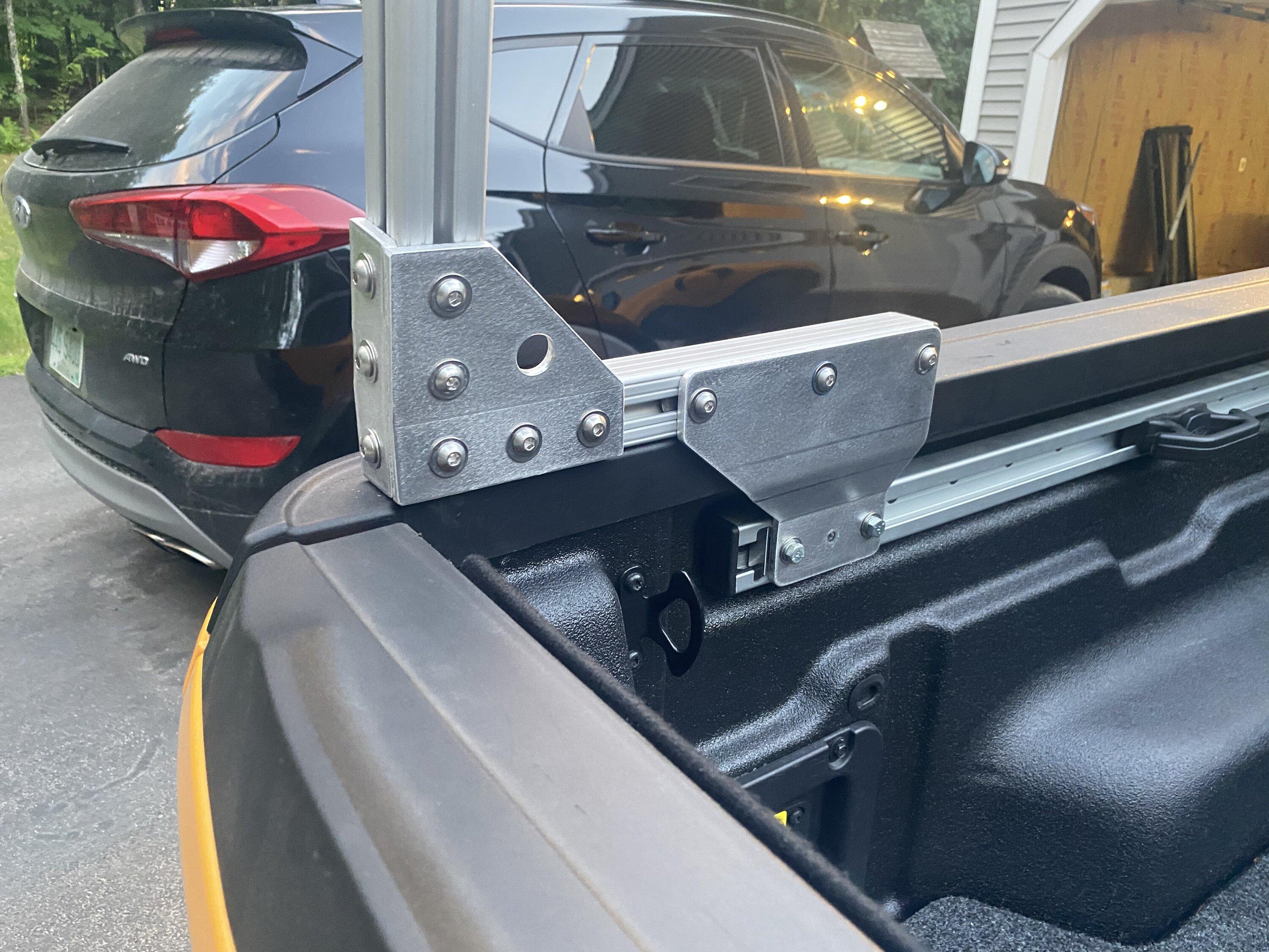

Finished up my homemade rack recently. Built from 1.5” square 80/20 anodized aluminum extrusion and 1/4” aluminum for the brackets. Built it mainly for when I need to haul my kayaks around but will be good for just about anything I need to carry.
Very Impressive and the anchor points on the bed rails are ingenious. Thanks for posting.:cool:

Looks great.
Oh I’ve already had plenty of weight on it and plenty of shake tests. The rack is completely rigid. I tend to over engineer just about everything that I build.

Nice work. We use this product frequently for work. If you replace some of the button heads with the hand twistable fasteners you could have a tool free removable rack 🙃 theyre more money… but if you made a bed rack outa this stuff you clearly dont care about that part 😂 nice project

Ya they have crossed my mind, McMaster Carr has some T-handle bolts for $3-$4 each.

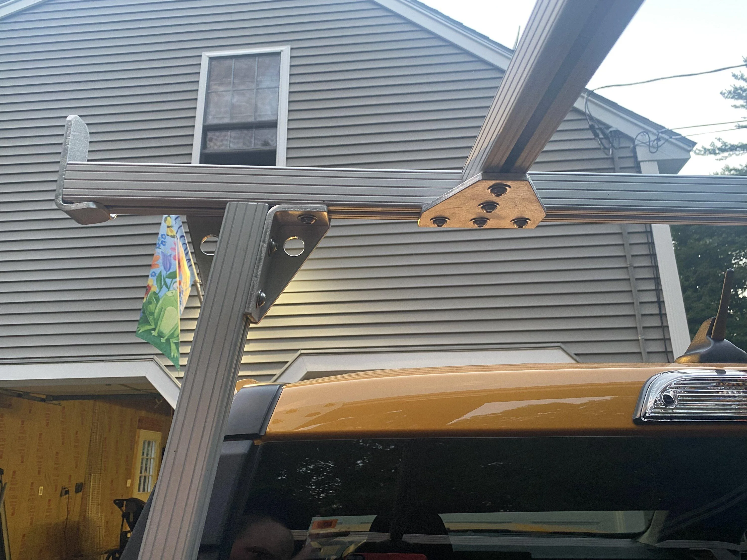

Could you share the angles of the joints (if you have them). The intersection from the crossbar to the upright specifically. Is it 100°? 108°?, or did you just eyeball it?

You may not get a reply. It has been over a year since the OP "Chandonnet" has been active on the forum. You may try sending a DM.

Wow this looks awesome! Wonder if it would be possible to make something similar but to work with a hard tri-fold, and Elevate rails as the connecting piece.

I think that would be a no-brainer. Look at a site like 80/20.net for all the corner and connector options.
https://8020.net/
