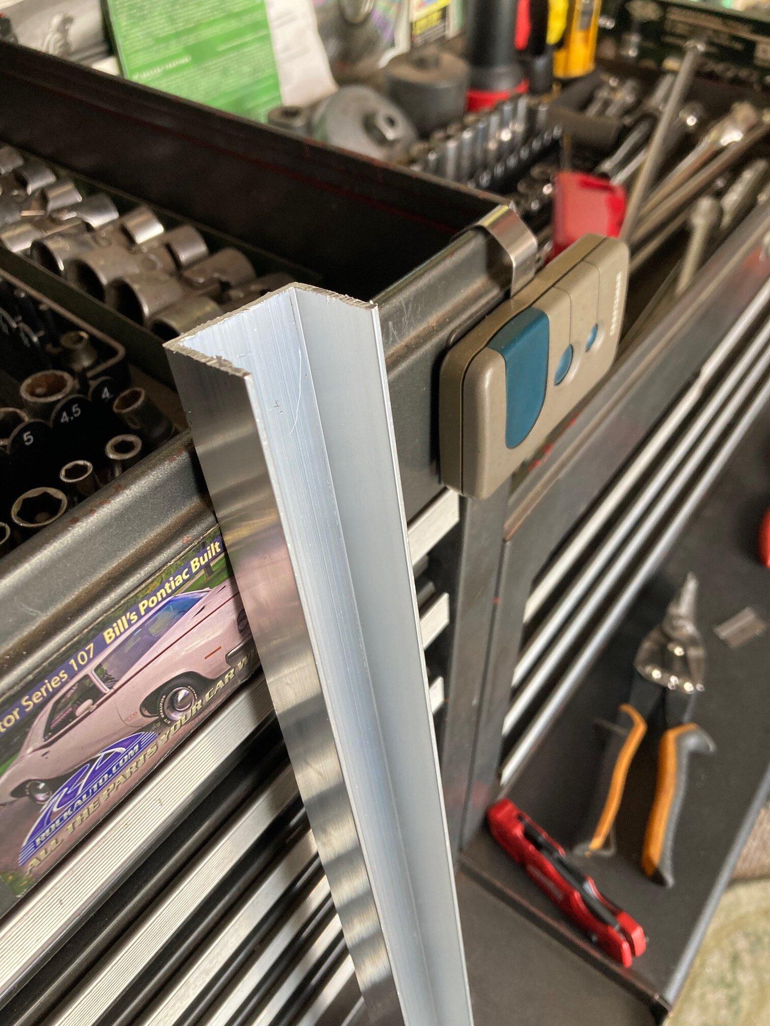

I made this bed cover using a 6 by 8 foot vinyl fence section from Home Depot, 1 roll of 3M double stick tape, and 4 six
foot lengths of aluminum "U" channel. It took me 3 hours start to finish and cost me roughly $225.00. I am very pleased with the results. The panels ( individual ) slide out from front to rear and are trapped by the tail gate. It won't be water tight but will keep things from getting soaked.

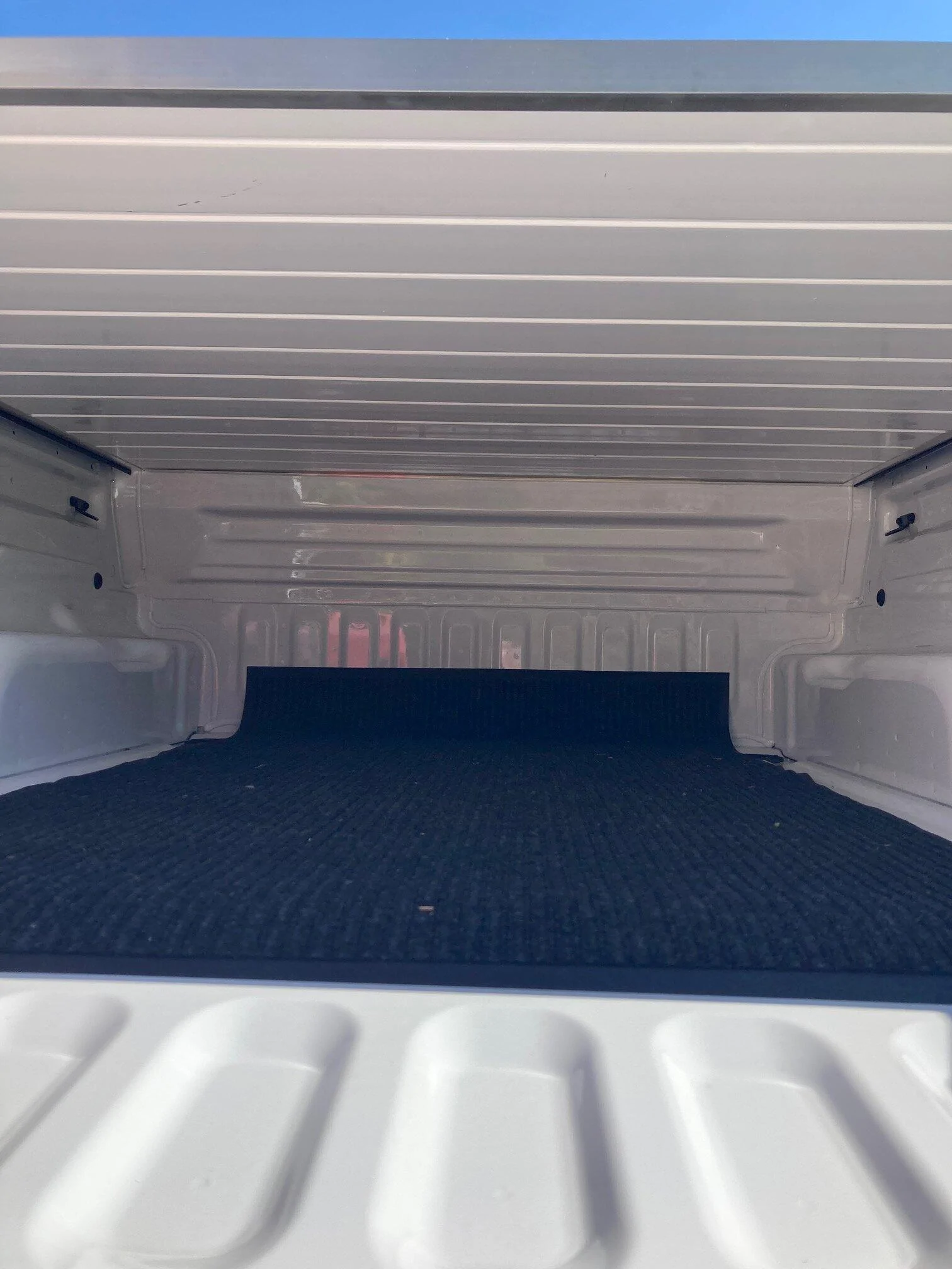

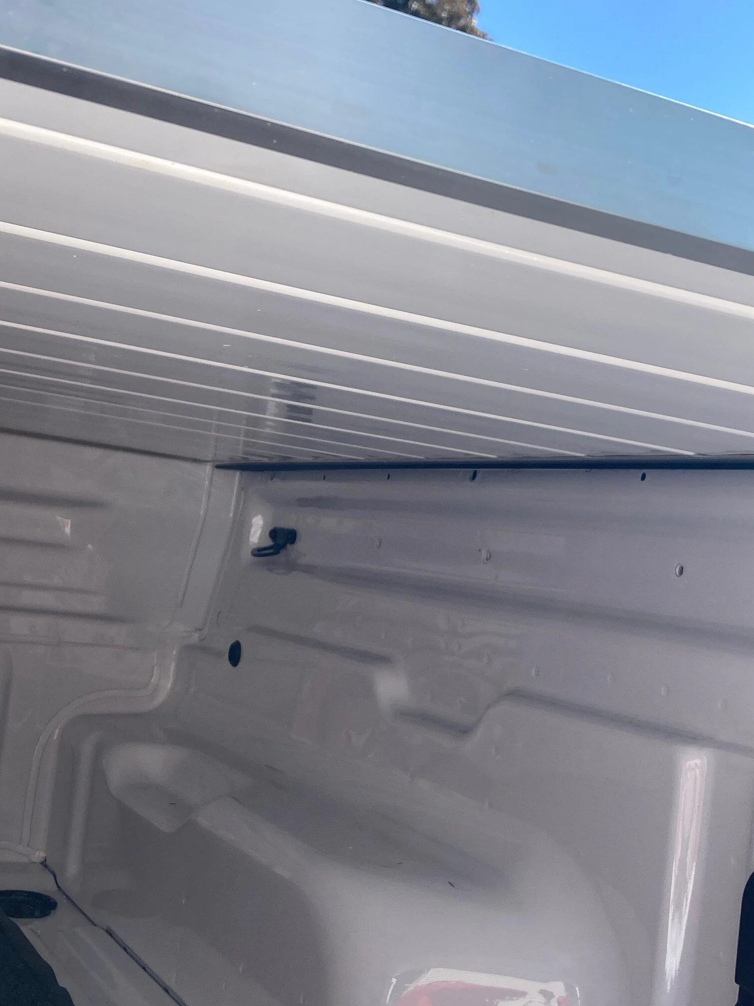

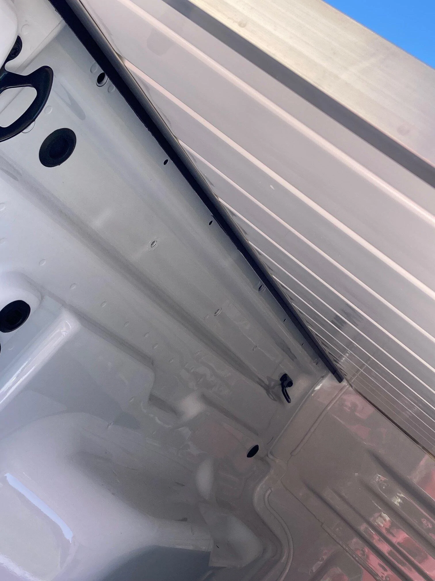

Here are the pics of the inside. All attached with 3m double stick tape.
Ford Maverick Homemade tonneau cover IMG_5670
Ford Maverick Homemade tonneau cover IMG_5668
Ford Maverick Homemade tonneau cover IMG_5667
Ford Maverick Homemade tonneau cover IMG_5673

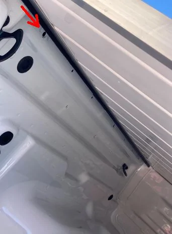

Hmm... I never noticed that row of holes hiding under the black trim piece in my Maverick. Looks like a good place to bolt on aluminum channel or angle; could be stronger than 3M double stick tape.
I don't have a tonneau cover for my XL, and I don't need one 99% of the time. But if ever I travel far from home it would be nice to secure the bed so I could leave stuff unattended, maybe slide in some panels per the patented Motorjunkie design.
Ford Maverick Homemade tonneau cover t1
