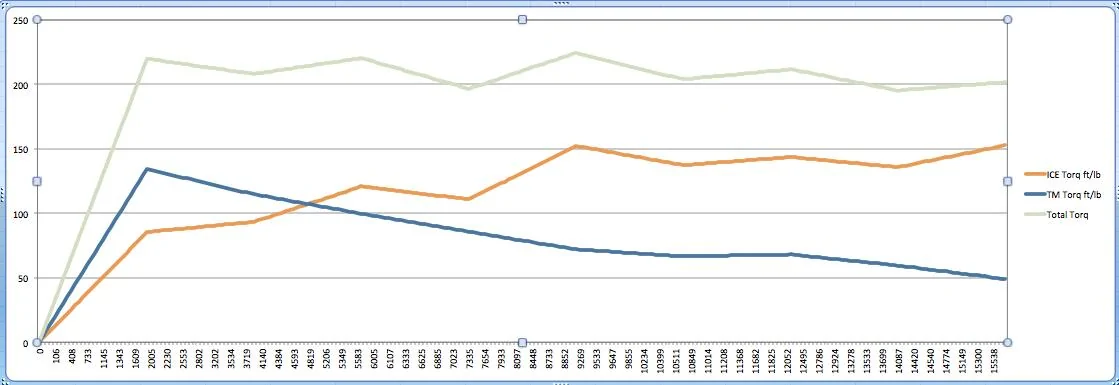

Here's a datafile for 2024 Sport Mode since the TM seems to be used more, and the HVB is certainly attempted to be kept charged up better when not being used (not in this data though).
This was actually part of a coast down test to compare modes for regen (still working on making a post about it).
So I wasn't going flat out acceleration (pedal only at 44% max), rather I just wanted to be at 60 mph at a certain point so all the coasts were over the same ground.
Steps: Turned to Sport Mode (ICE off when stopped of course), turned on logging, foot off brake so ICE on, jammed pedal.
So 16 sec almost, so not getting max values here. I'll have to find a road to do that and log it.
Graph of torque curve for time.
So perhaps telling enough.
Oh - why not a smooth ICE curve?
Sport Mode, the simulated shifts with a real change of ICE RPM with change of Generator Motor RPM so actual "gear" change.
There's an extra graph in the attached data file if desired to see anything else.
Like HVB Amps staying strong the whole 16 sec, GM torq/RPM changes, DCDC Conv Hi Amp changes.

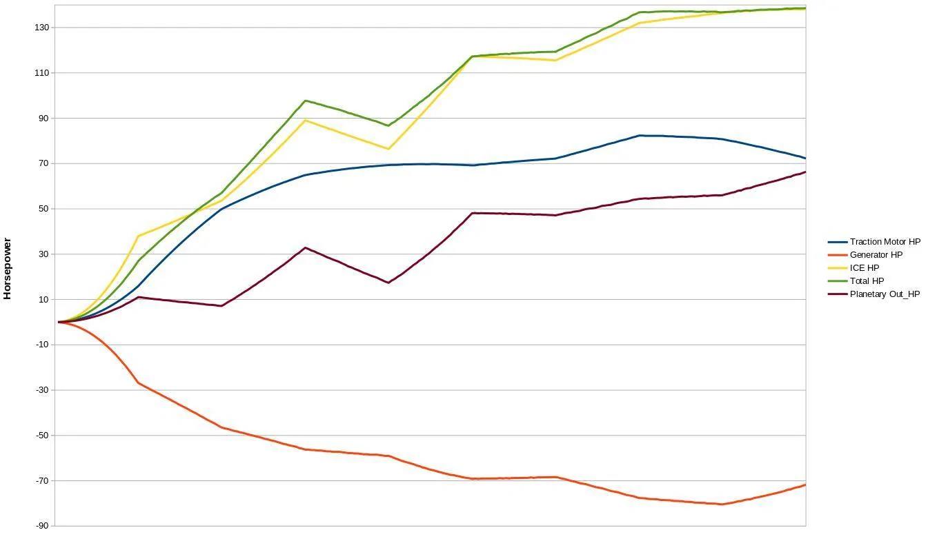

I made another quick graph from your ~16 seconds of data to demonstrate the power flows through the transmission, and how much power came from the engine vs. the battery, I hope you don't mind:
Ford Maverick More Torque Than Specified? Screenshot from 2025-07-04 17-25-02
The green line is total HP, any time it is higher than the yellow line, some horsepower is coming from energy drawn from the battery, any time it is lower than yellow, energy is flowing into the battery. The other lines demonstrate the power split through the transmission, how much is being transmitted electrically from the Generator to the Traction motor through the inverter, and how much is being transmitted directly through the gears mechanically is shown by Planetary Out_HP. Generator HP is shown as a negative value because it is being used to regenerate power out of the planetary gear set and onto the high voltage bus, where the energy is then sent to the traction motor or battery, electrically.
edit: I looked at your logged HV battery state of charge and amps, and it looks like the HV battery was being used slightly to provide power the entire acceleration run; in that case the PCM is just making a measurement error when it is calculating the ICE torque value, and the battery was never actually charging during this short datalog run. ICE Torq ft/lb in column K in your spreadsheet is probably a torque demand request instead of a back-calculated value from the mechanical torque ratio in the planetary and the measured power from the generator motor; I verified that the torque ratio, while close to the actual mechanical torque ratio of 3.53:1 in the planetary, does have some measurement error in it and it the computer calculated ratio ranges from 2.9 right at the start of the run to as high as 4, with an average of 3.63 in the data.
It appears up until about 27 mph the HVB and TM were providing the majority of torque right?
Amp increase to 55 A finally stopped about 31 mph.
I don't think there was any charging of the HVB until coasting started, which is off the graph in the hidden data rows.
Positive reading is Amps from the battery, negative not shown in acceleration is to the battery.
So you mean it's likely the ICE torque is not correct?
I can totally believe they math out several figures being obtained in these PIDs, or as you say the requested value.
I know getting timely figures isn't being helped by having that many PID's on display.
When I added the 4 wheel brake pressure, each if those entries is like a delay in the logs by one increment extra per wheel, I'm removing after some brake tests. Some of the others are notable delays. Seems to depend on the module the figure is pulled from - I've tried to use the few same modules. Like VSS in 3 different modules, but used the one is same module with other PIDs I'm logging.

No, most of the torque was still supplied by the engine, in your torque graph there is one small error, you need to subtract the GM torque (it's negative in the sheet so you can just add the torque in column M to the other two columns) from the total torque, so you total torque is reading about 20-40 ft-lb too high on your graph in many sections. You can calculate roughly how much of the TM torque was supplied by the battery by making a ratio of the GM kilowatts to the battery kilowatts, that will basically be the percentage that was supplied from the battery/percentage supplied by the engine through the GM power pathway. At about 798 milliseconds, the GM is providing more than half the energy for the TM, and the ratio supplied by the GM increases throughout the run - which is energy drawn directly from the engine. At ~5.7 seconds the battery kW peaked at just under 12kW, at that time the GM was providing 42kW to the traction motor. There was no direct datalog for amps from or to the motors that I saw, so I converted HP to kW using the RPM and torque data you logged from each motor, so (RPM * Torq / 5252) * 0.7457
*Oh I just saw you asked about what I meant with the ICE torque, but yes that is not a strictly measured value from what I can tell; although the transmission can act as a dynometer since we have an electric motor we can measure the output of, when I added up the power values it showed early in the run a point where engine power was greater than total power (generator output was bringing the total below the engine-only value) - normally you'd think this was because excess energy was going into the battery, but not in this case since we know the battery stats separately.
The other possibility I can think of is that at low generator RPM the efficiency is low, and so the missing power from those simple addition calculations just might be lost power from low generator efficiency at those speeds, too. Since we are being given a motor torque and RPM from the PID's, it's quite possible that motor efficiency is already taken out of those values to provide a more accurate torque reading, this is calculated and stored in many motor controllers during the motor characterization process. In that case, the engine torque reading could be quite accurate, as it's basically hooked to a calibrated dyno at that point.
