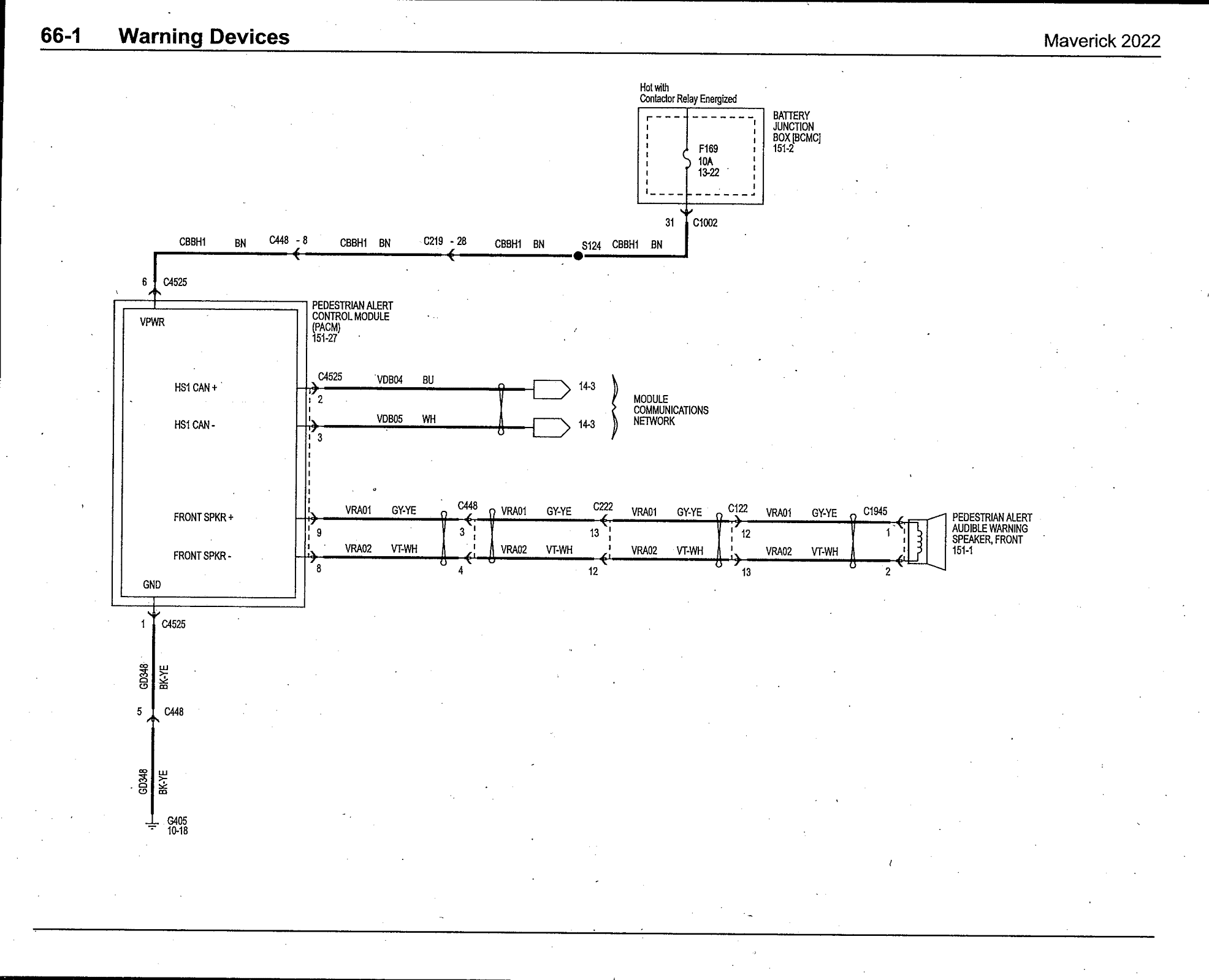

WOW! 🤩 Thanks for taking the time to post that info. I see my ancient Mouser account is still alive! (LOL) I'm impressed: You have uncommon insight into the arcane world of automotive connectors. Perhaps you can share your intelligence sources and methods to enlighten and empower lower proles like myself. 🙏
I see the "Pedestrian alert audible warning speaker, front" in the Maverick Wiring Diagrams. The wires at this location are circuit VRA01 (GY-YE) and VRA02 (VT-WH), which pass thru several connectors before terminating at the speaker in connector C1945. There is a "causal" number of 14B446 shown, which I'm guessing is the part number for that wiring harness. It seems (another guess) that the term "causal" is used so warranty claims involving the wiring harness will include a trackable ID. Ford says that the connector P/N is N/A. So... is there some magic way to determine a Molex P/N for any given harness connector?

Here's a bit of additional info for you.
The Pedestrian Alert Control Module (PACM) is real close to the battery, and covers need to be removed to access it. Not sure what's easier: bypass resistor at the speaker or accessing this module for a switch or relay ON/OFF-with-bypass operation. If the speaker is not found by the PACM, the PACM tattles on you via the CAN bus and sets a Diagnostic Trouble Code, so if you turn it off with a switch or relay, a resistor needs to be substituted into the circuit to keep the nannies happy.
Ford Maverick MegaOhm external speaker bypass kit installed PACM_location
Ford Maverick MegaOhm external speaker bypass kit installed PACM-schematic
