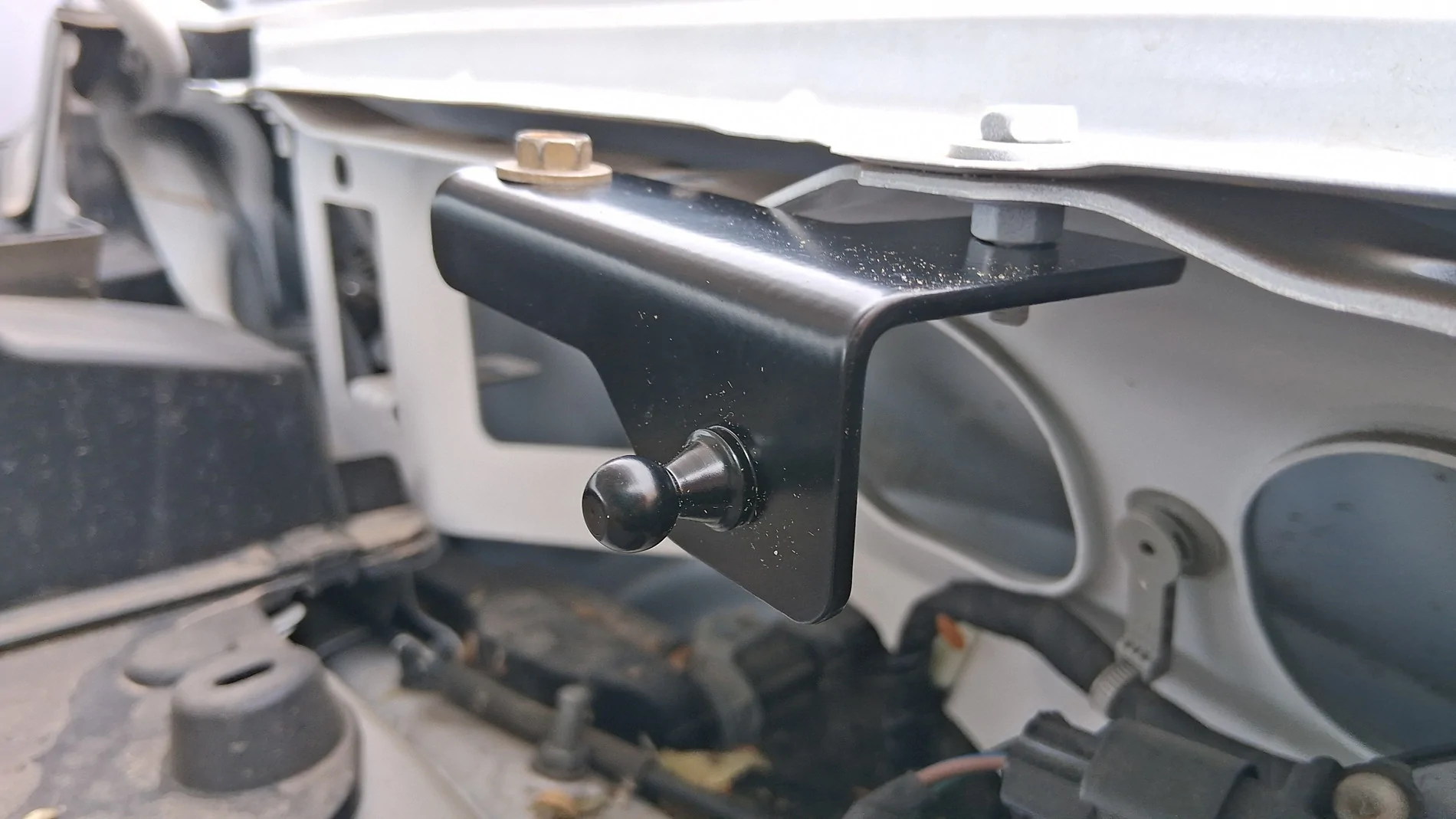

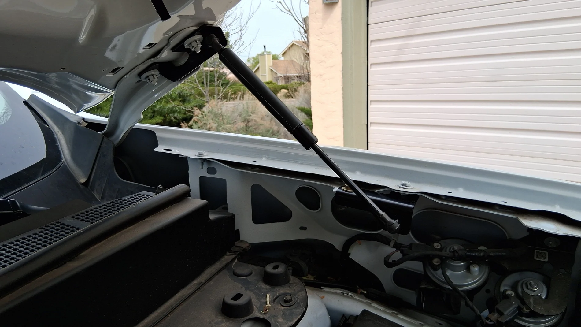

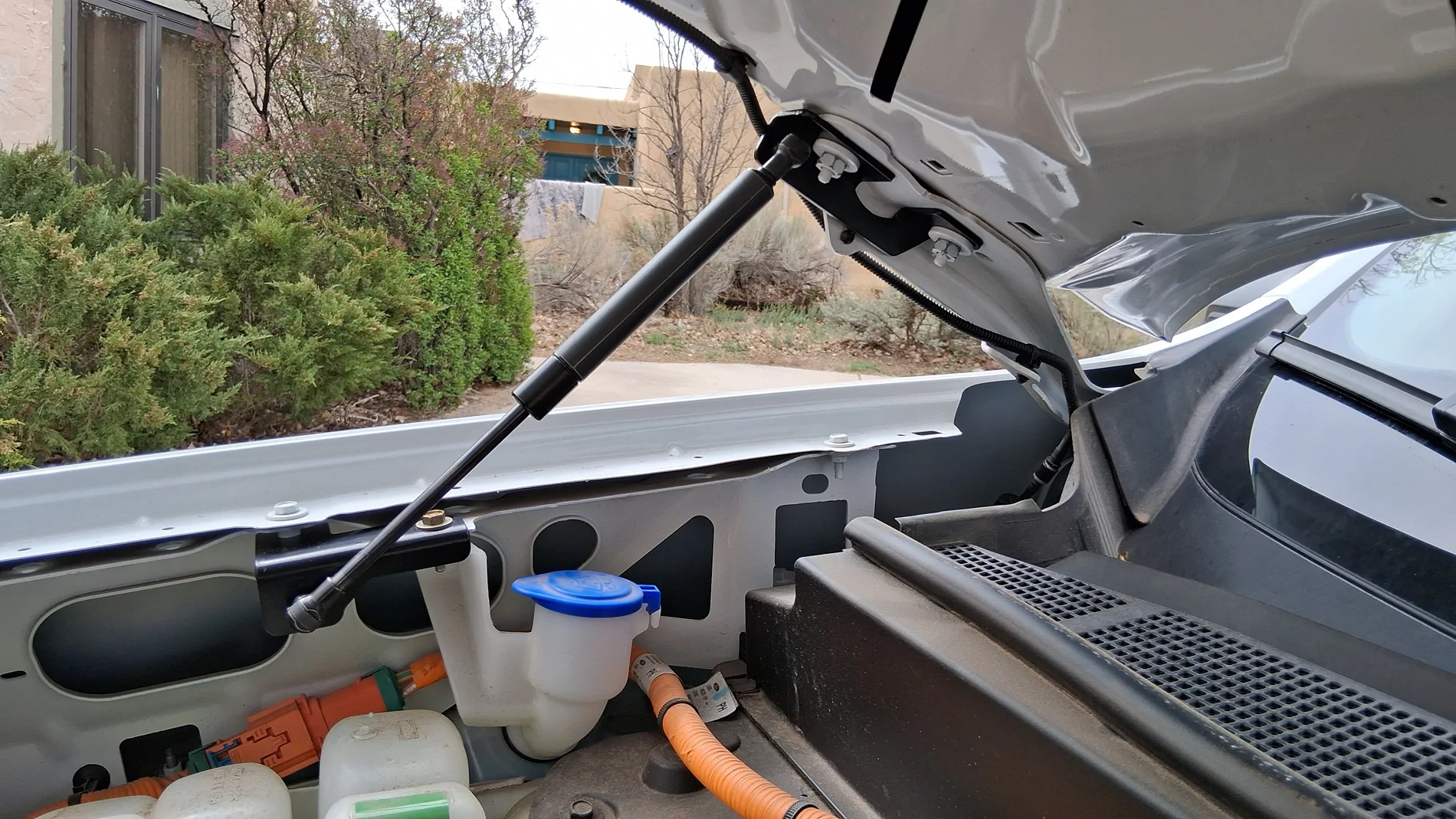

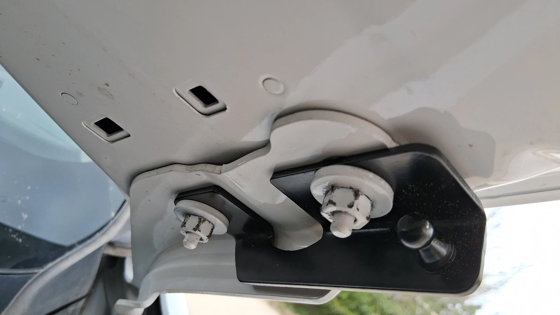

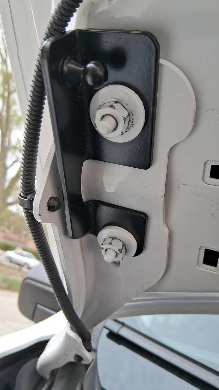

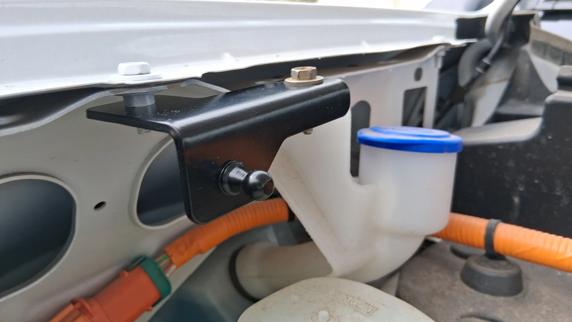

I'm a doofus, so at the first opportunity I couldn't make sense of the brackets I'd received compared to the v 1.0 design, and seeing the one pic of MRT's in this thread showing the install of the redesigned ones... I got thoroughly mixed up and bailed on the install -until today. See pics if you get similarly confused:
What I've learned in the process:
  • the redesign moves the ball joints for the struts pretty far forward compared to the prior design, out away from the hinge
  • brackets go in with the joint as far forward as can be, keeping r/l on the passenger/driver side accordingly even if it's tempting to swap them -MRT knows what they're doing
  • 10mm socket for fender bolts, using an 11mm box wrench to hold the new nut underneath on the driver's side; 13mm socket for hood bolts. Using the prop one last time, hood did not shift when undoing on driver's side, but sure did on passenger side
  • despite what the video shows, there doesn't seem to be any way or point to having the driver's side fender bracket 'clear' the fender nut. Seems like a correct install clears the bolt and rests below the nut just as on the passenger side -trying to confirm this with MRT now
  • with struts in place the hood opens MUCH shorter than it did with the prop -about 4" if not more. Not for the first time in my life, Tall Hobbit wishes he was Short Hobbit.
Hopefully this helps anyone similarly confused with this kit. My Oxford White does the best possible job contrasting the brackets from factory parts under the hood.

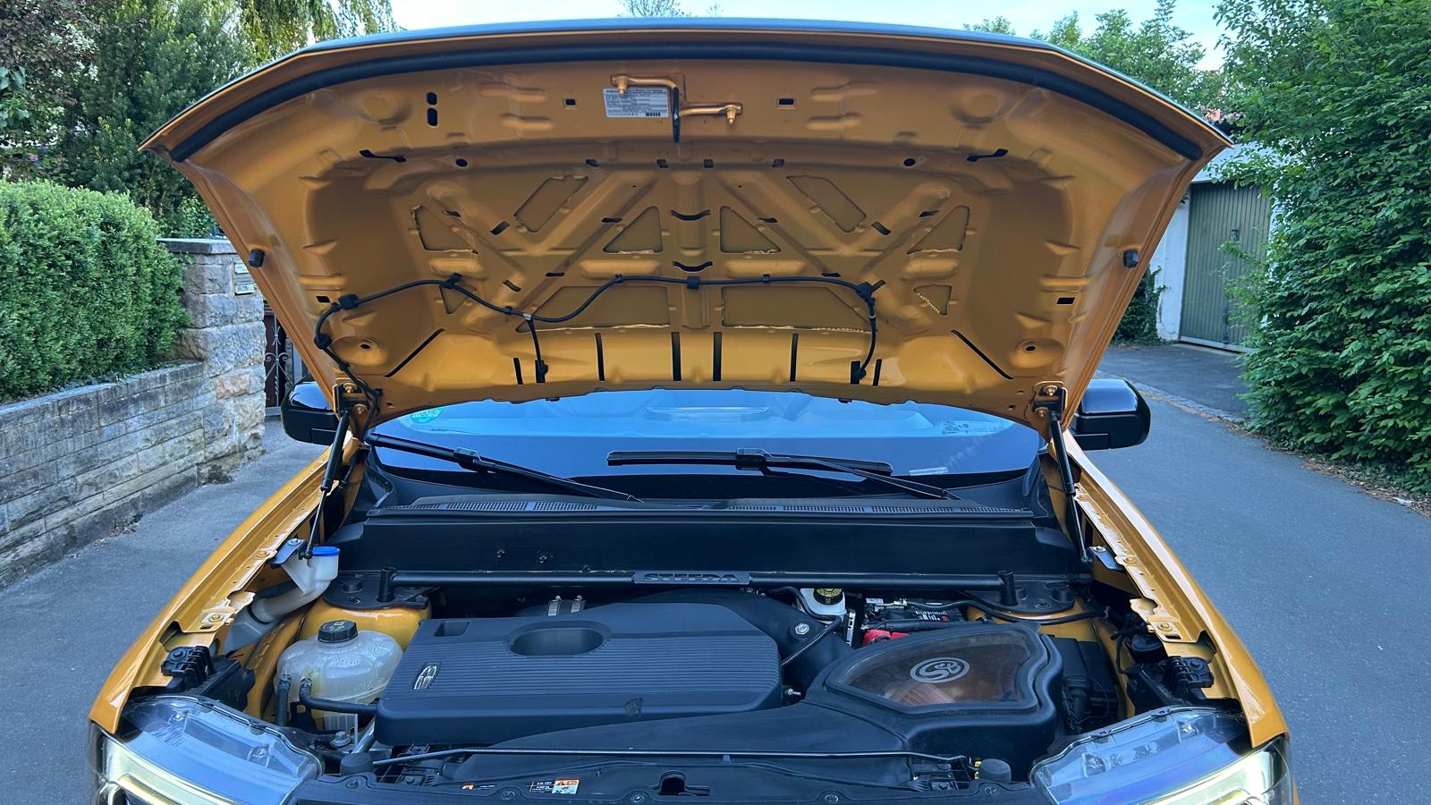

Does anyone know what the correct height the two adjustable factory hood dampers need to be? I've been trying to adjust them but can't seem to find the right height but also don't really know exactly what they're supposed to do...Just provide a resting place for the hood or apply pressure for the latch???
BTW, I think I'll be ordering the $8 jeep spring that my klutchtech kit didn't come with since I ordered it in april 2024 which is probably prior to them including it. I've been using a small box to help open my hood....

You basically want the bumpers to be tight, but not so tight that it is detrimental to closing the hood. Keeping them tight not only adusts latch tension, but also reduces hood flutter and improves hood stability during high speed buffeting on the highway.
The bumpers can also be adjusted relative to each other to align the hood height where it meets the top of the fenders if it is off one side vs the other.
