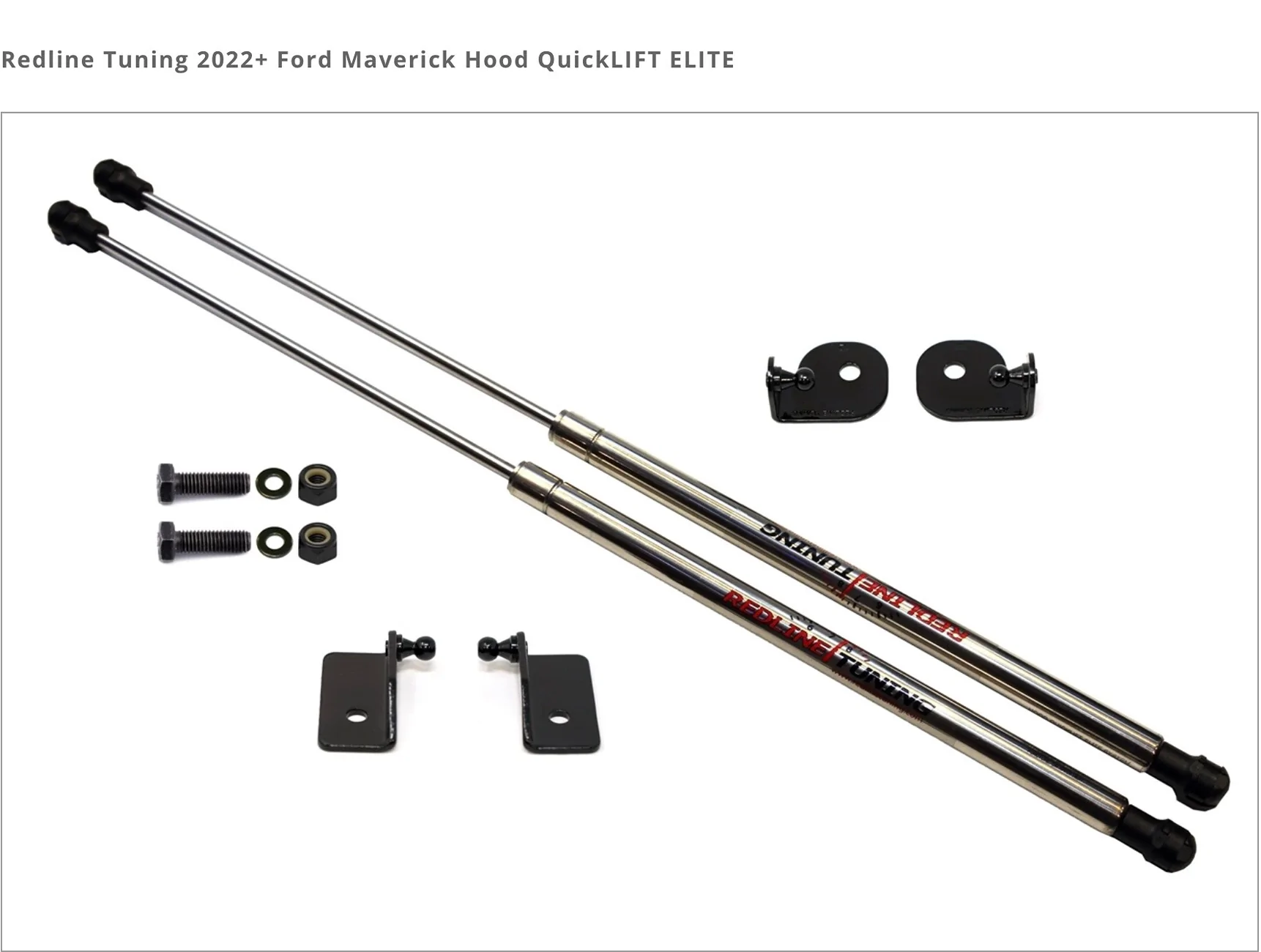

You may want to consider Redline Tuning Hood Struts. Their awesome imo, installed them way back in 22 when I first got my truck, Zero issues and super easy to install has been my experience

I just pulled the trigger and ordered the Redline Tuning Elite Series on sale for $139 plus $8.95 Shipping (2-6 Days Delivery) thanks for the information Craig I appreciate it I do like the open position is 2” greater than the Prop Rod position👍

Awesome. Think you will really like them. Another great thing is their design only requires removing 1 nut on each side of the hood mount instead of 2 like the other brands, so the chance of misaligning the hood is eliminated.

Wow by design, surprising most design objectives are to improve functionality. Well my Redline Tuning Hood Struts shipped this morning so we’ll see but I’m really happy their design increases the hood opening by 2” over the prop rod position.

Yep I’ve been extremely pleased with my redline ones and they did increase the opening some but I don’t recall the exact amount
