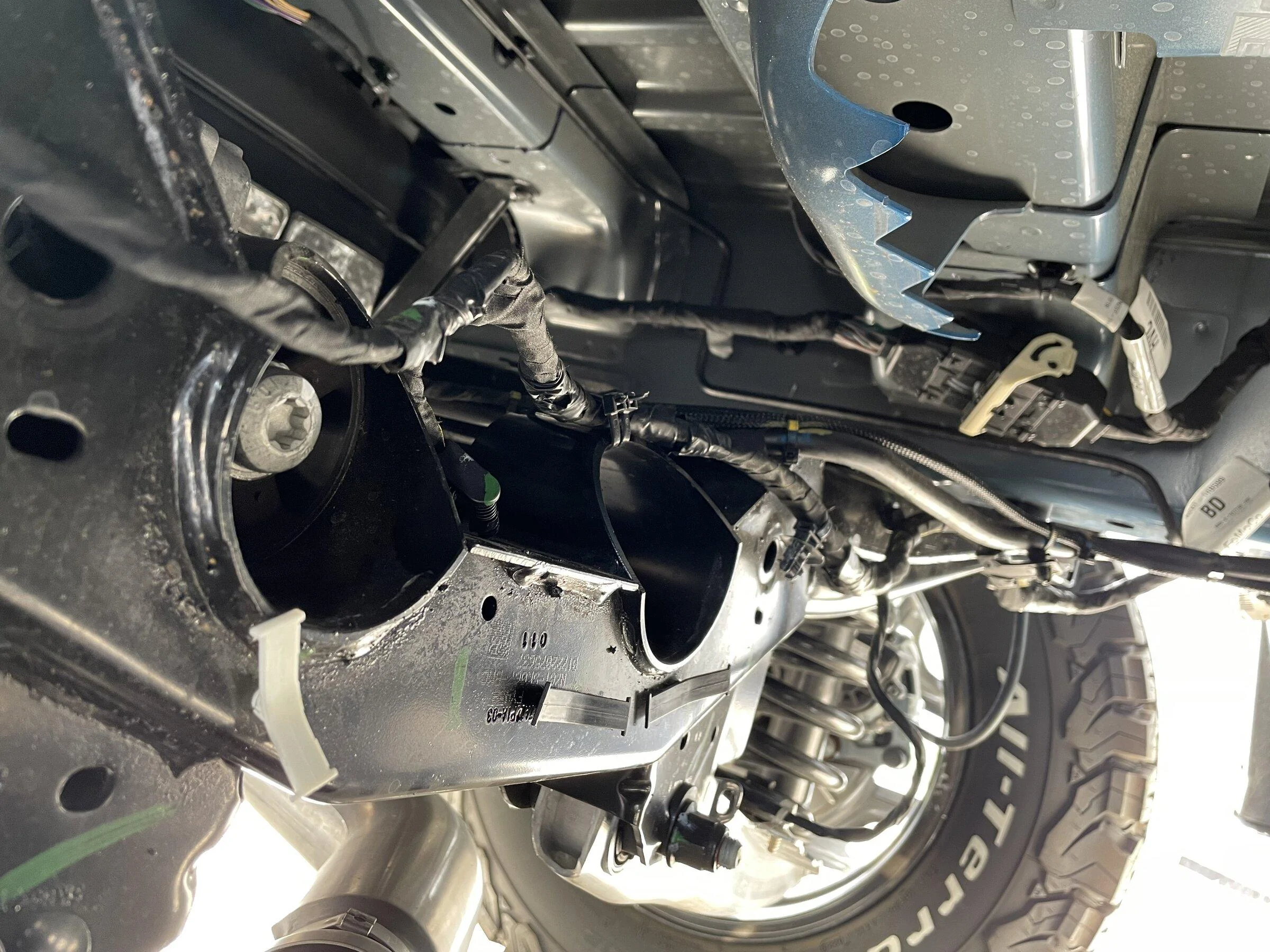

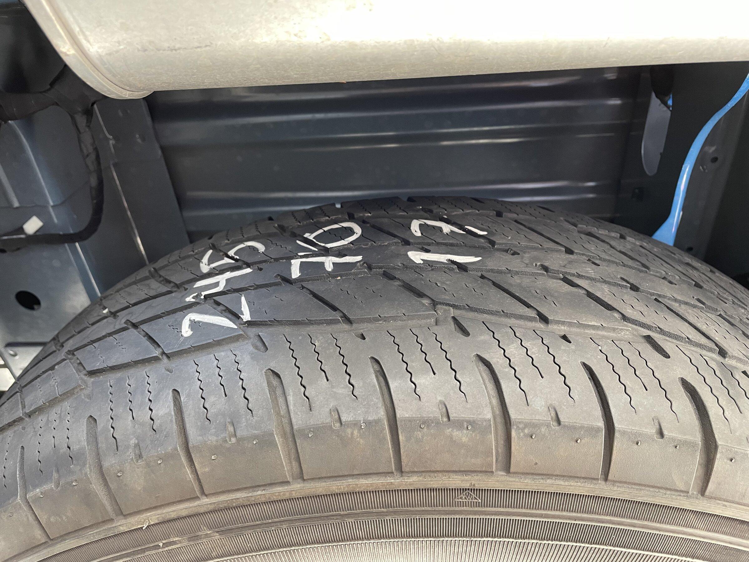

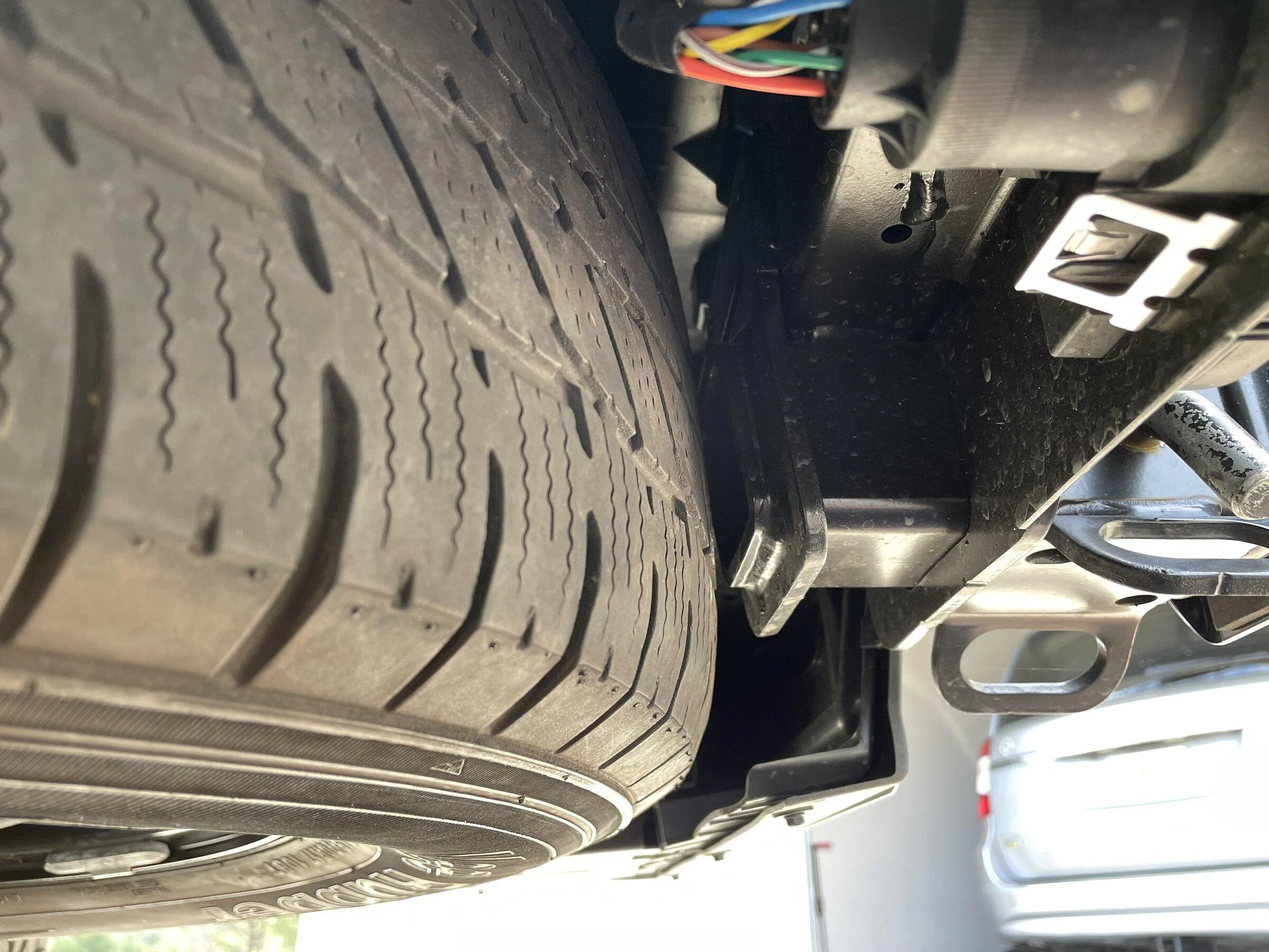

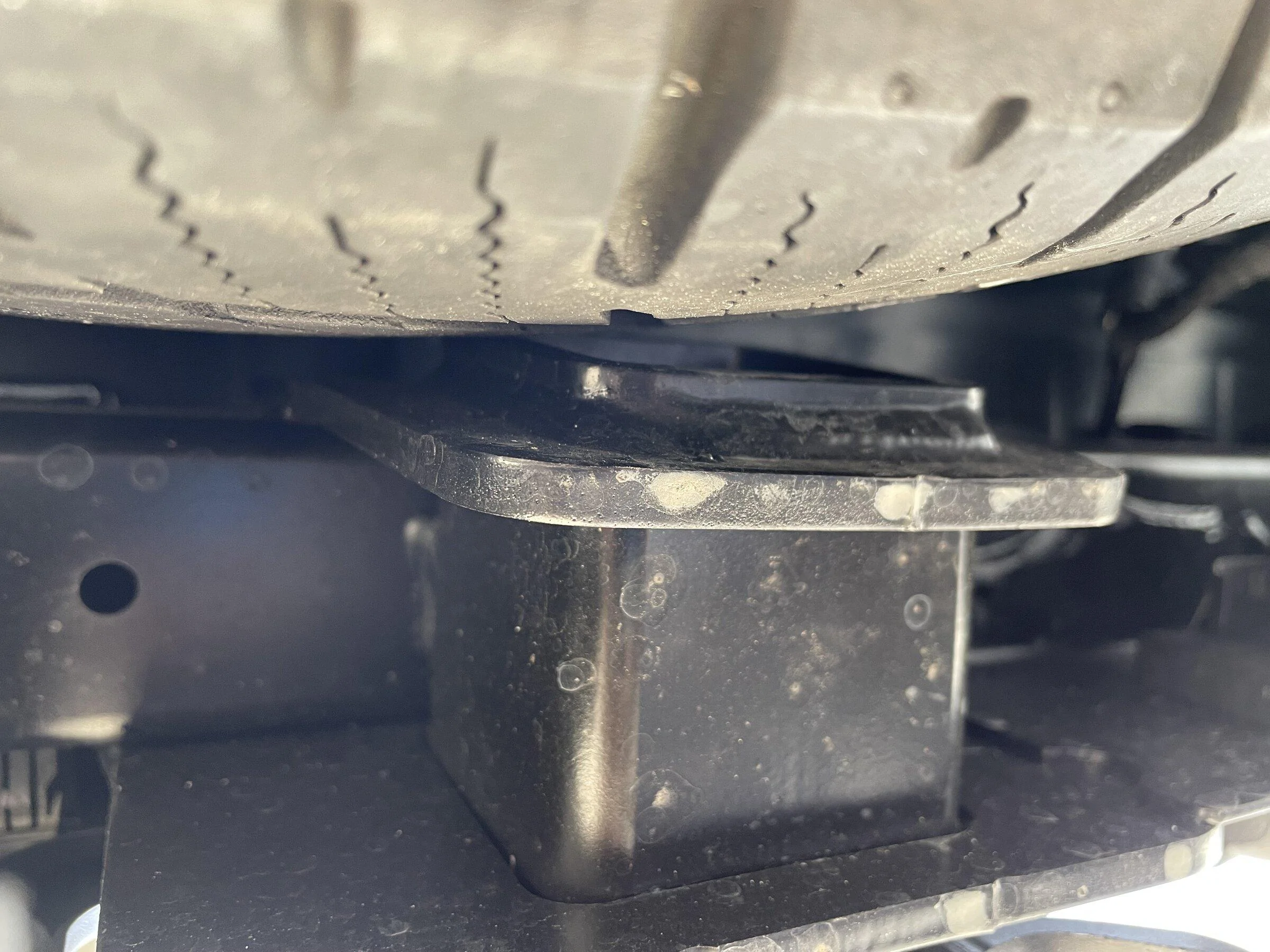

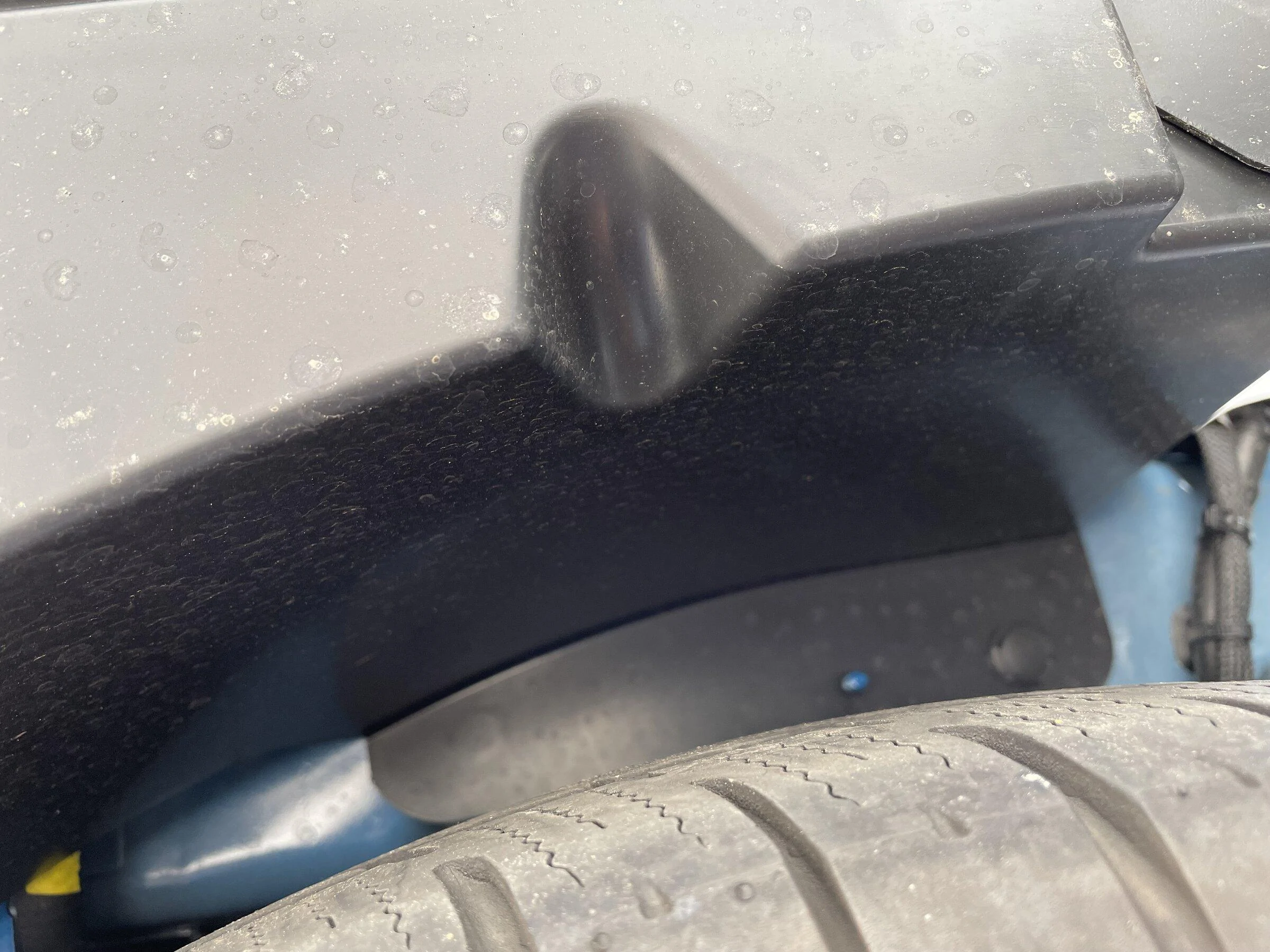

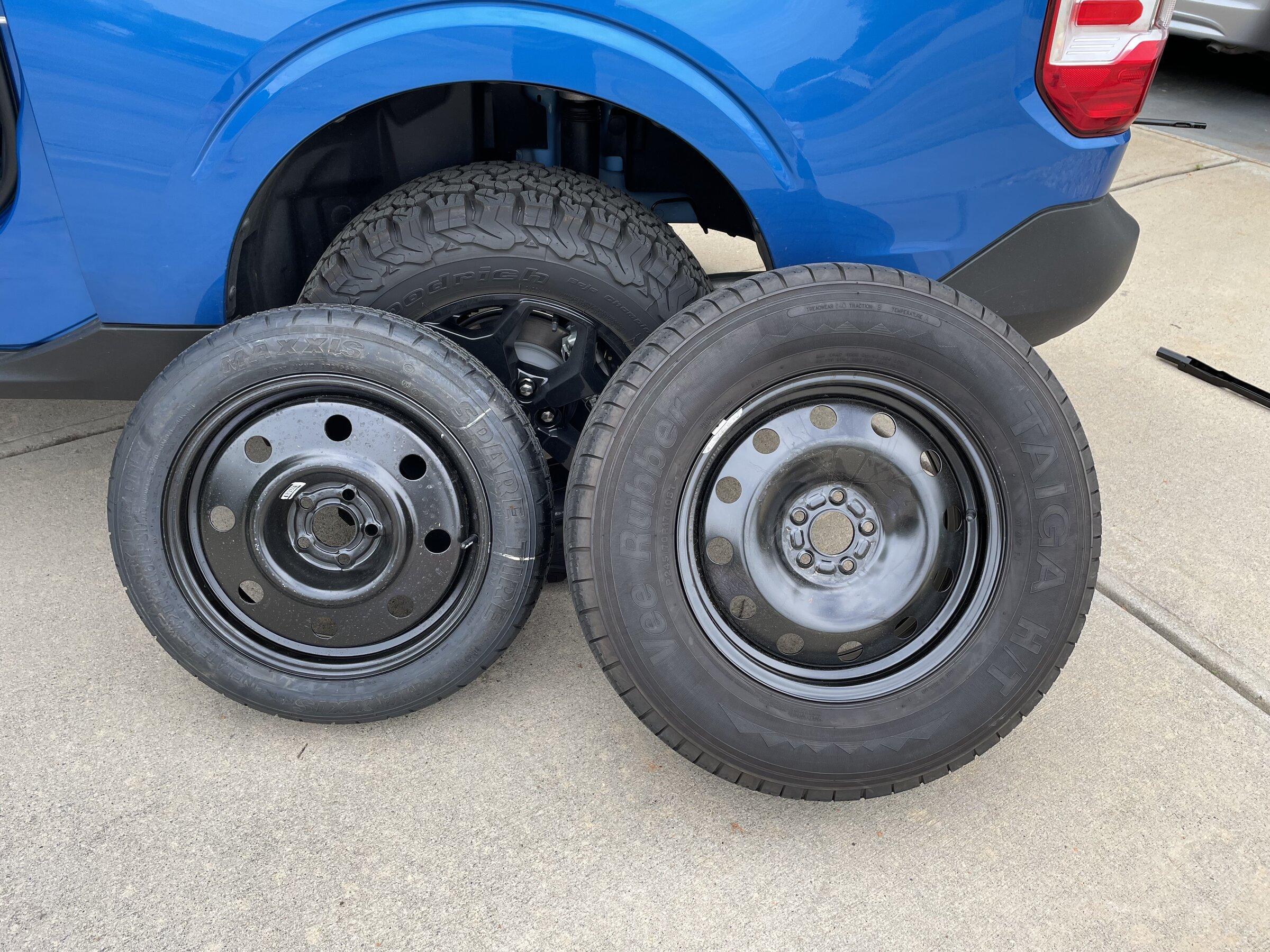

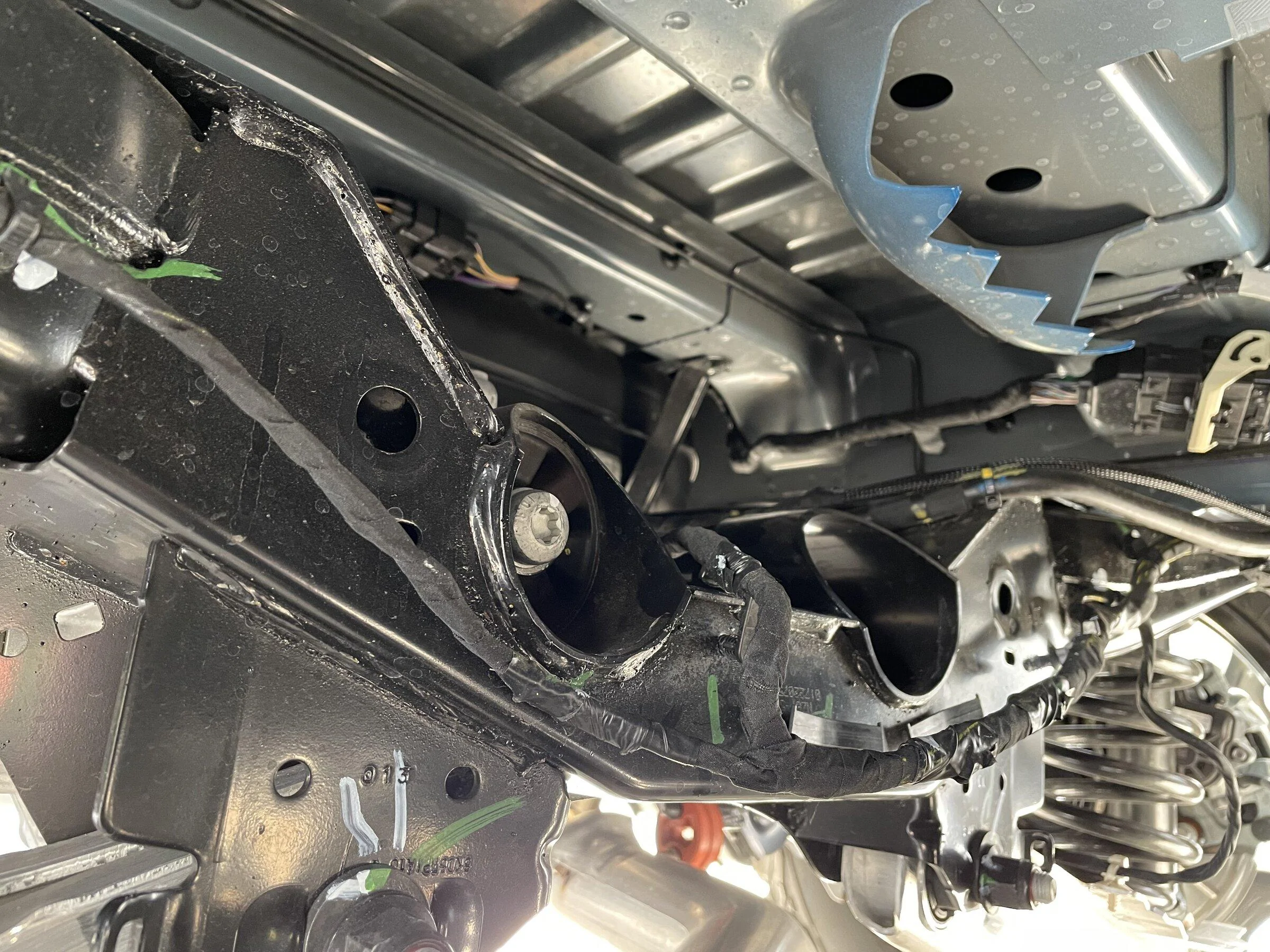

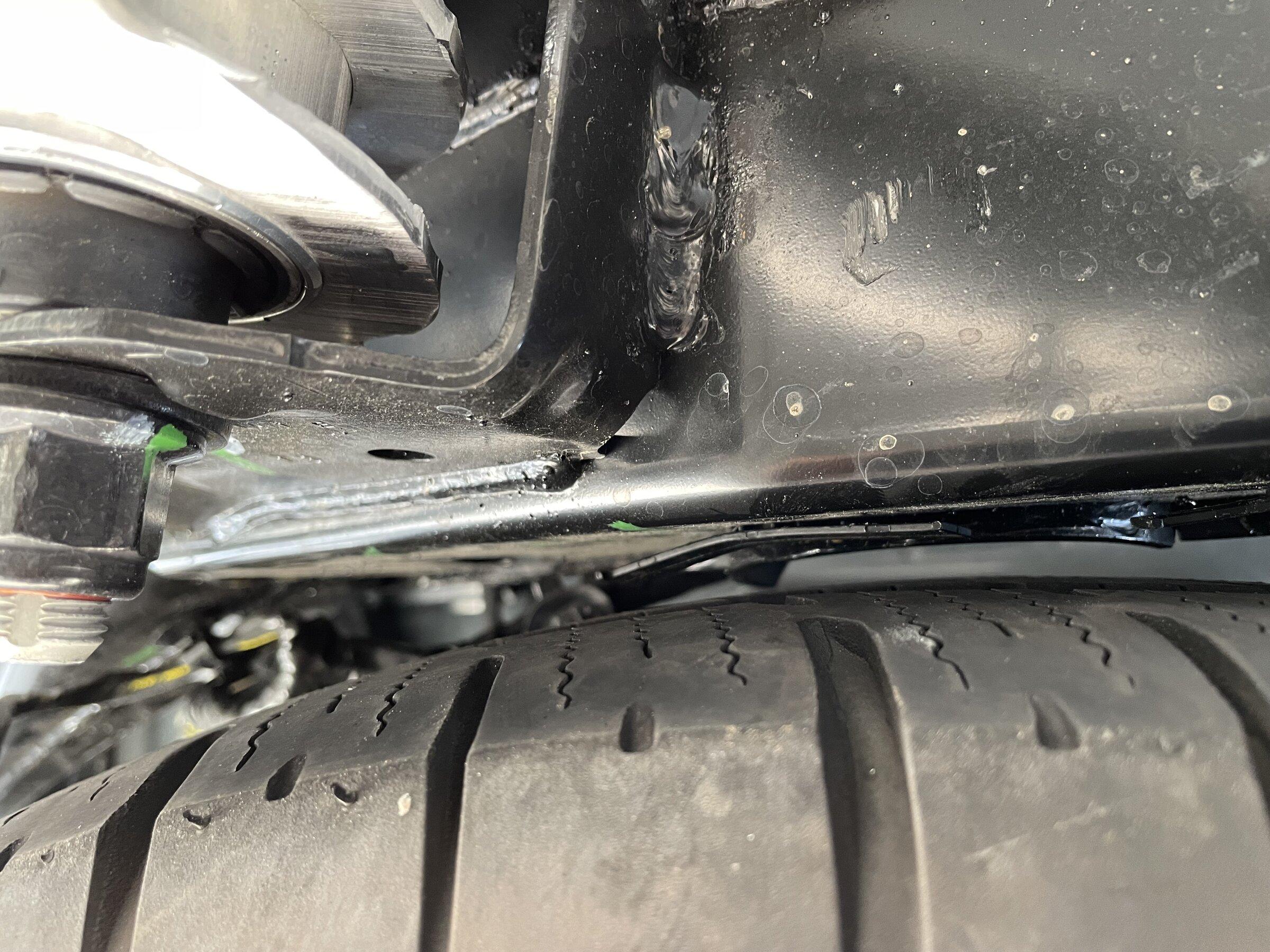

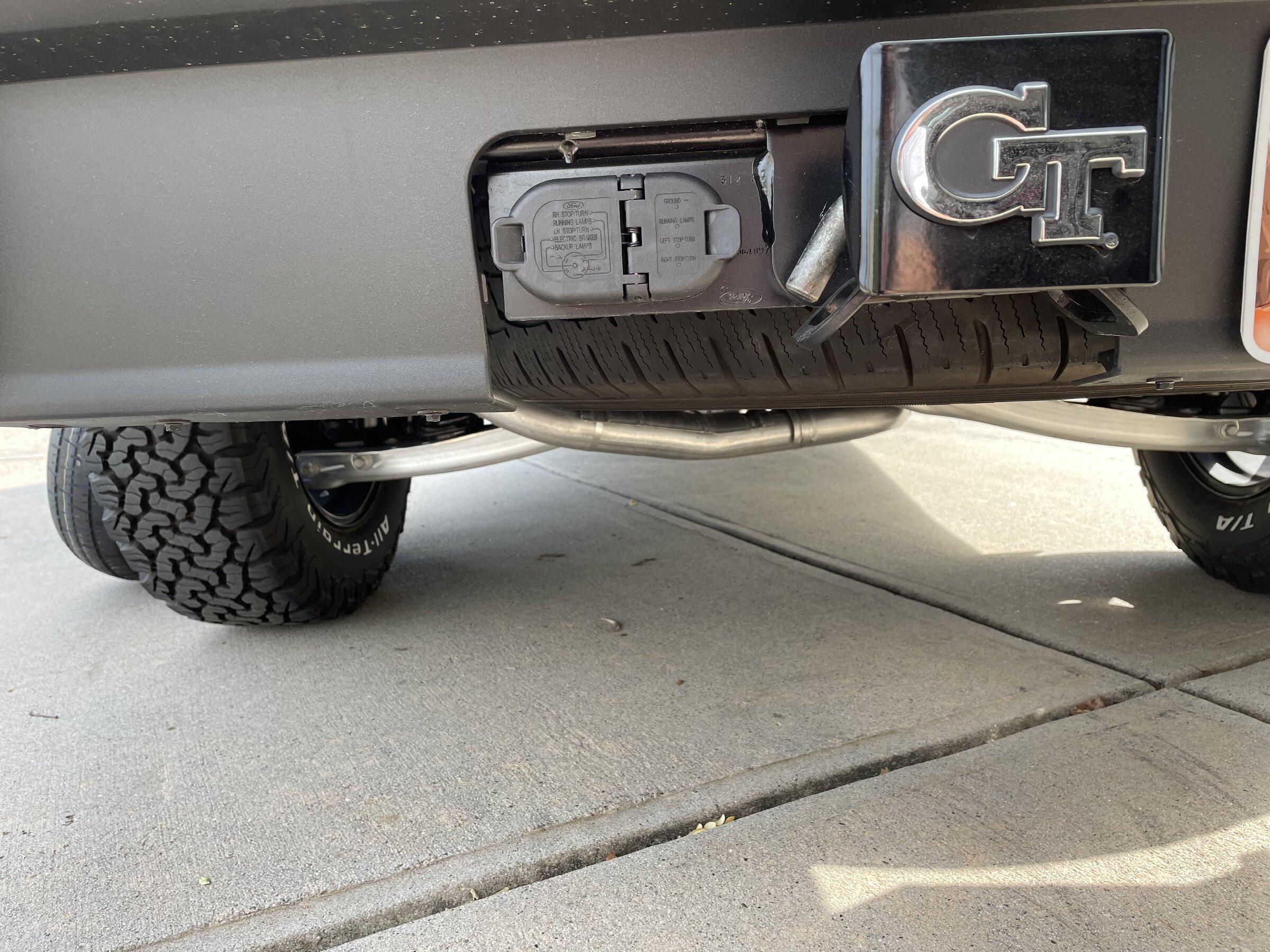

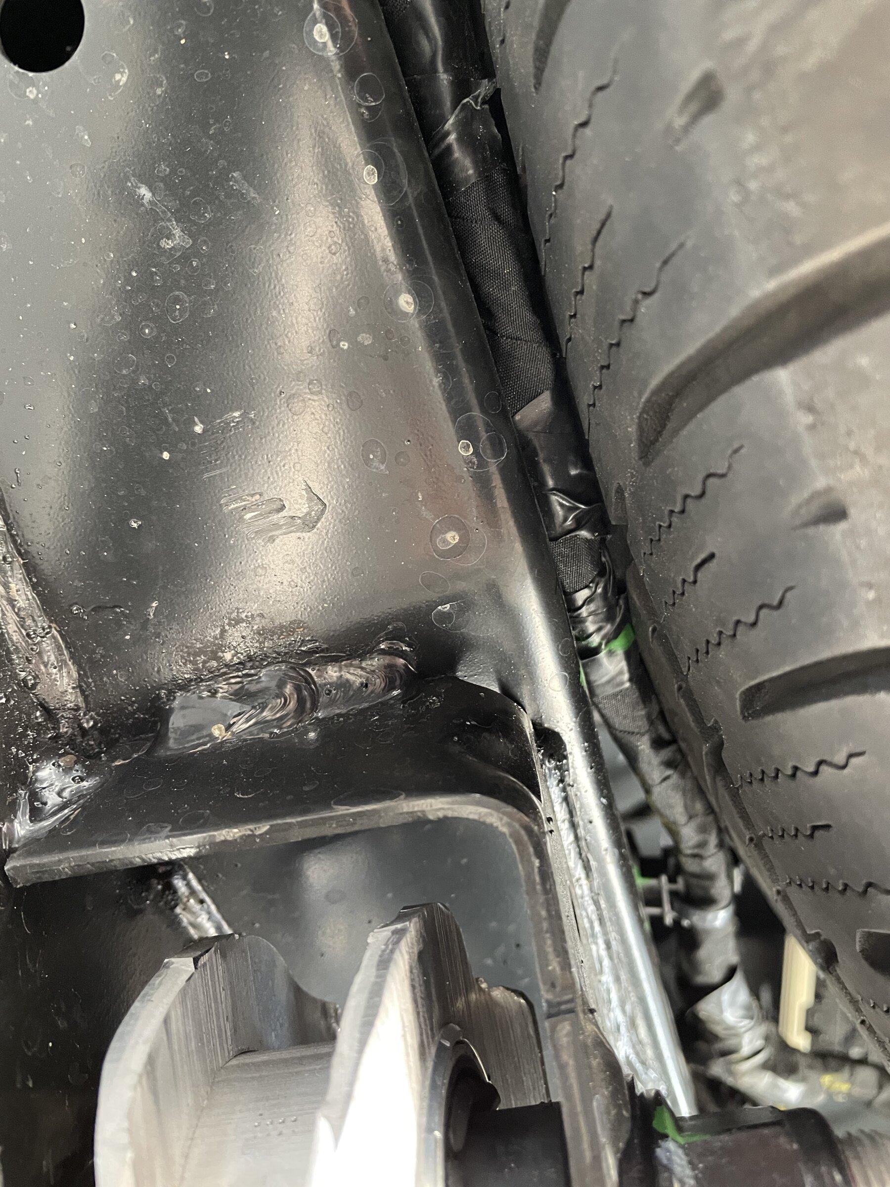

One of the first upgrades that I did to my Maverick was a 2in level/lift and put larger tires on. The tires I put on are 245/70/R17 BFG KO2s.
As part of that upgrade, I wanted to add a spare that is the same size as the rest of the tires. When I measured the spare tire well, It was going to be close, so I took a chance. I ordered a steel wheel off ebay that was 6.5 in wide and the correct lug pattern (roughly $85). I then went to a local used tire shop and found a used 245/70/R17 ($45 installed and balanced on the rim).
Then the moment of truth. . . IT FITS . . . Well, sorta. I did have to re-locate some wires that were getting pinched towards the front of the vehicle. I think it is safe to say that this is the largest tire size you can fit in the spare tire well. And it would probably be close if you had a new AT tire with more tread.
Hopefully this info and the attached pictures will help answer some questions out there. I tried to document the sizes, tolerances, and the wires that needed re-locating.

yeah, I'd be thinking 255/60 18 w/ a 1" front lift and 3/4" rear lift (kind of an equalizing a bit) so I'd have no rubbing issues.... but a matching diameter full size spare could in fact be an issue...
225/65 17 (standard size XL/XLT) has a diamter of 28.5"
225/60 18 (standard lariat size) has a diamter of 28.6"
235/65 17 (max diameter for optional stock tire) has a diameter of 29"
245/65 17 (mentioned by a poster) has a diameter of 29.5"
255/60 18 (mentioned by me) has a diameter of 30"
245/70 17 (mentioned by OP) has a diameter of 30.5"
OP mentions AWD and 4K tow... so more going on underneath than some other trucks. however freebird has the same stuff going on underneath and he couldn't make larger tires fit. Interesting!

Can you take another pic showing the clearance between those teeth and the tire?
I guess this is causing some confusion. I did not get the tire to fit so that the teeth would do their job in case of a rear end collision. This tire is "on top" of them when pulled up under the car. The tire fits between the rear axel and the hitch.
Hopefully that helps.

My first ever car ride home from the hospital as a baby was a Ford Pinto, so exploding gas tanks from rear end collisions don't phase me. I put my full size 245/65R17 full size spare up in there just fine. YOLO!
