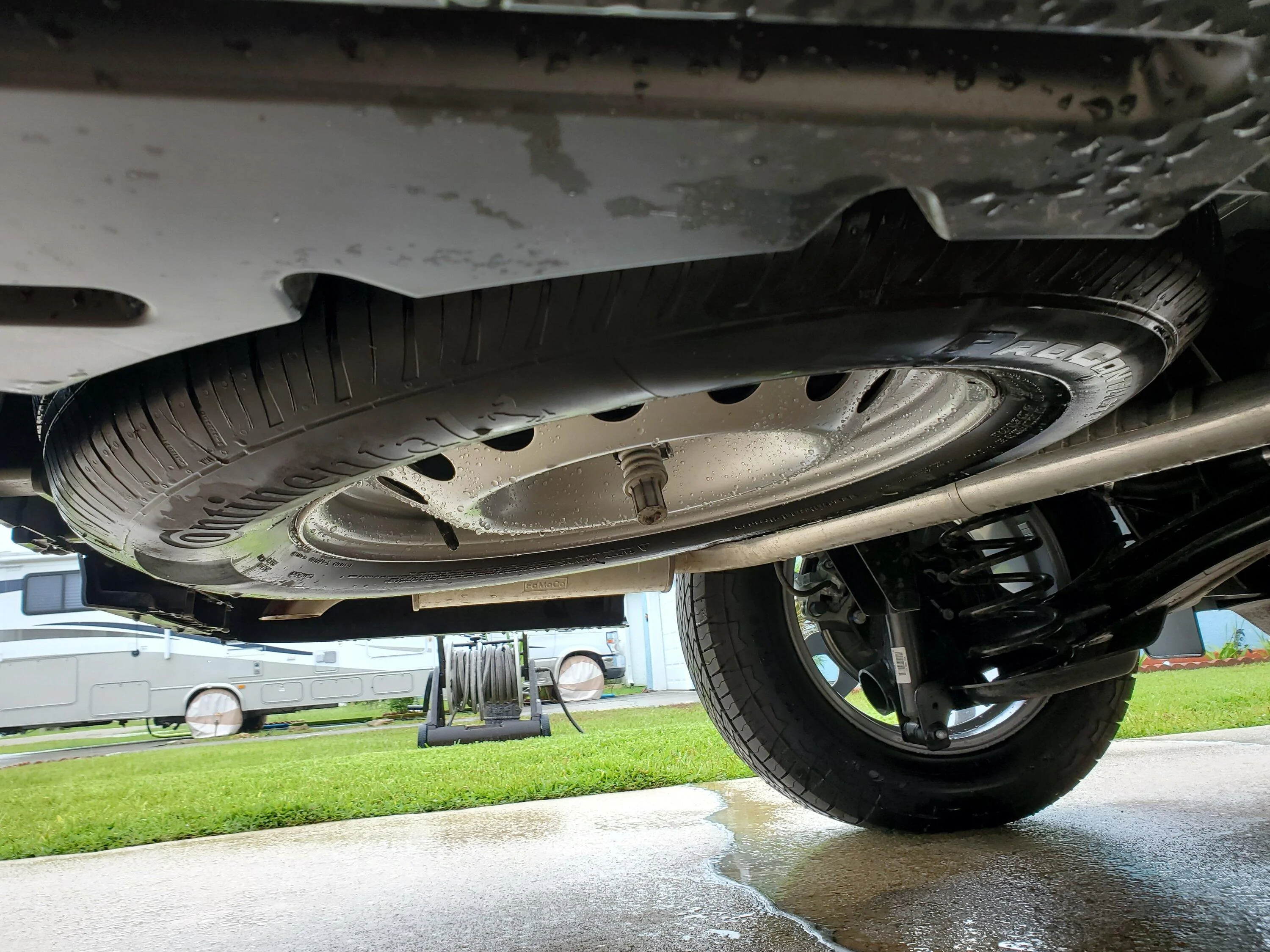

Setting aside spare size for the moment, is anyone worried the location of the spare? Seems like it has zero protection from the elements/road salt and will eventually get rusted to all hell.

It will rust and eventually not be able to wind down to remove it from the hanger. It happens on basically every pickup and full size SUV if you live in the salt belt.
Are you worried about the location of your other 4 tires that drive you through dirt, rain, snow, salt etc?

Looks like all Mavericks come with two different spare tires:
1. a space saver spare tire, donut, or temporary tire, size T155/70D17
2. If you purchase a hybrid or pay extra for a so called "Full Size Spare" surprise, the size is 215/60R17 . This is not the same as the OEM tire/rim on any Maverick.
Please note, the spare does not have a Ford OEM TPMS factory sensor.
This information is shown on the Placard located on the driver side door jam.
