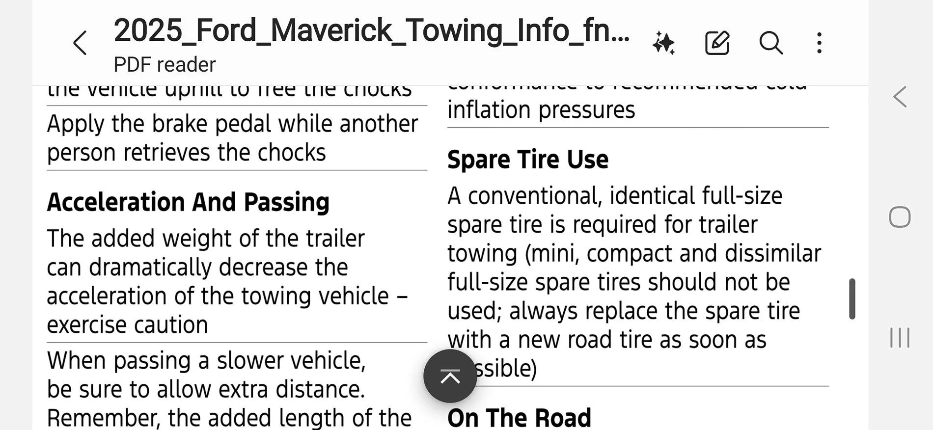

Ford changed the terminology from "full size" to "conventional" spare.

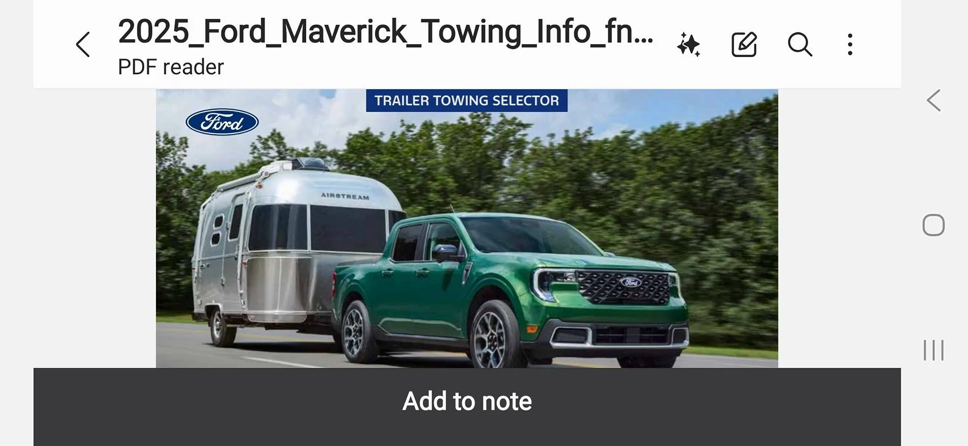

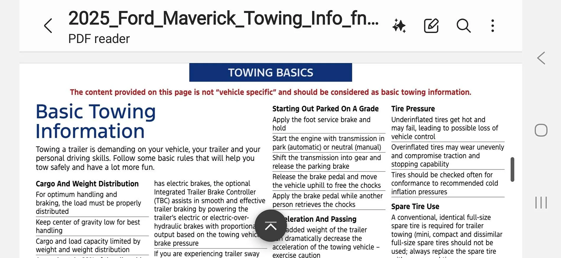

But, for the sake clarity, this is what Ford says what your spare tire should be, if towing.
Ford Maverick Full size spare tire Screenshot_20250601_080540_Samsung Notes
Ford Maverick Full size spare tire Screenshot_20250601_080524_Samsung Notes
Ford Maverick Full size spare tire Screenshot_20250601_080512_Samsung Notes

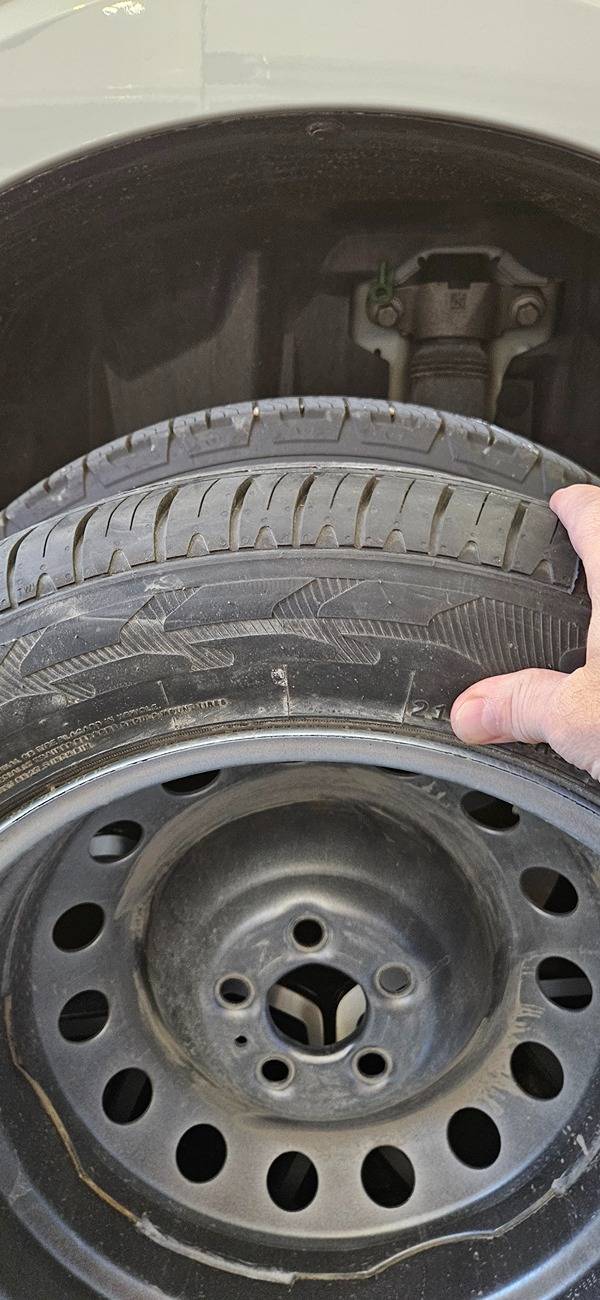

My truck tire and spare...
Ford Maverick Full size spare tire 20250525_132105

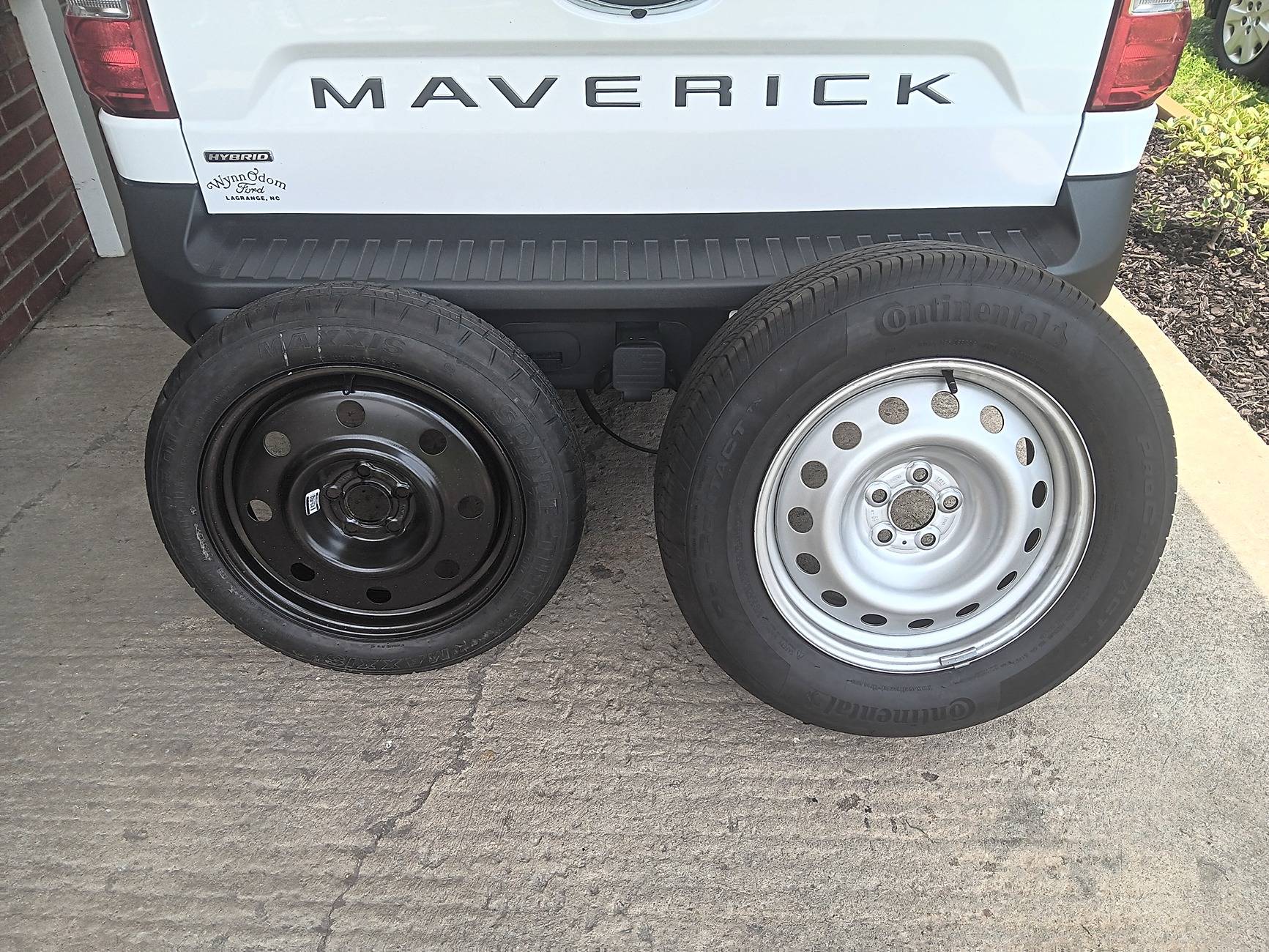

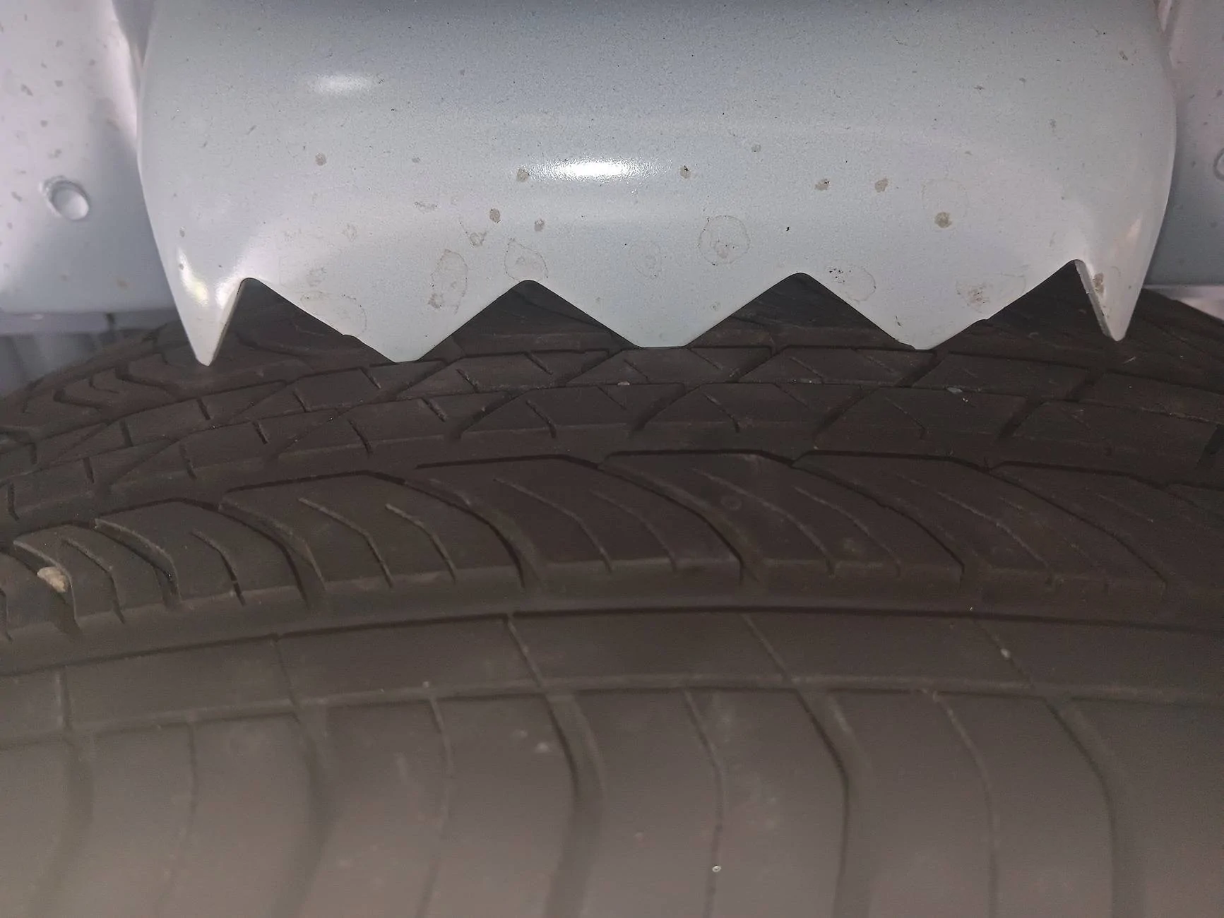

Sorry but I disagree, I switched out the spare with my oem continental 225/65r17 take offs yesterday with no modification to the shark jaw. I did let out about 2 psi but I carry a Dewalt jump starter/air compressor under my rear seat. I snugged it up tight so the teeth fit in the tread groves. Those without a hitch will have more room so there's no need to reduce psi. It's tight but it fits.
I haven't tried it. I merely repeated what I've read in other topics. Looks like you have a good workaround.
Will folks who have 18s or 19s and would like a full size spare.
Have to grind down the teeth in order to make those size tires fit underneath the truck in the spare carry area?
I'm guessing those teeth are there next to the spare tire for some type of safety reason?? If the teeth are a safety device. Will removing them affect possibly the next owner, who may never tow with the vehicle. Yet a safety device has been permanently removed.
Perhaps the "safetyguy" can answer this.
My recommendation is that you leave all safety equipment intact on the truck. If you have a tire that needs to be replaced. You replace the tire with the spare. Ubhook the trailer so that it's "safe" to drive the truck and get yourself a replacement tire.
Personally I would just drive the truck with the trailer attached using the spare tire at a lower speed until I can get it replaced.
