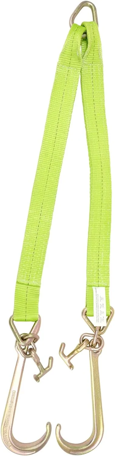

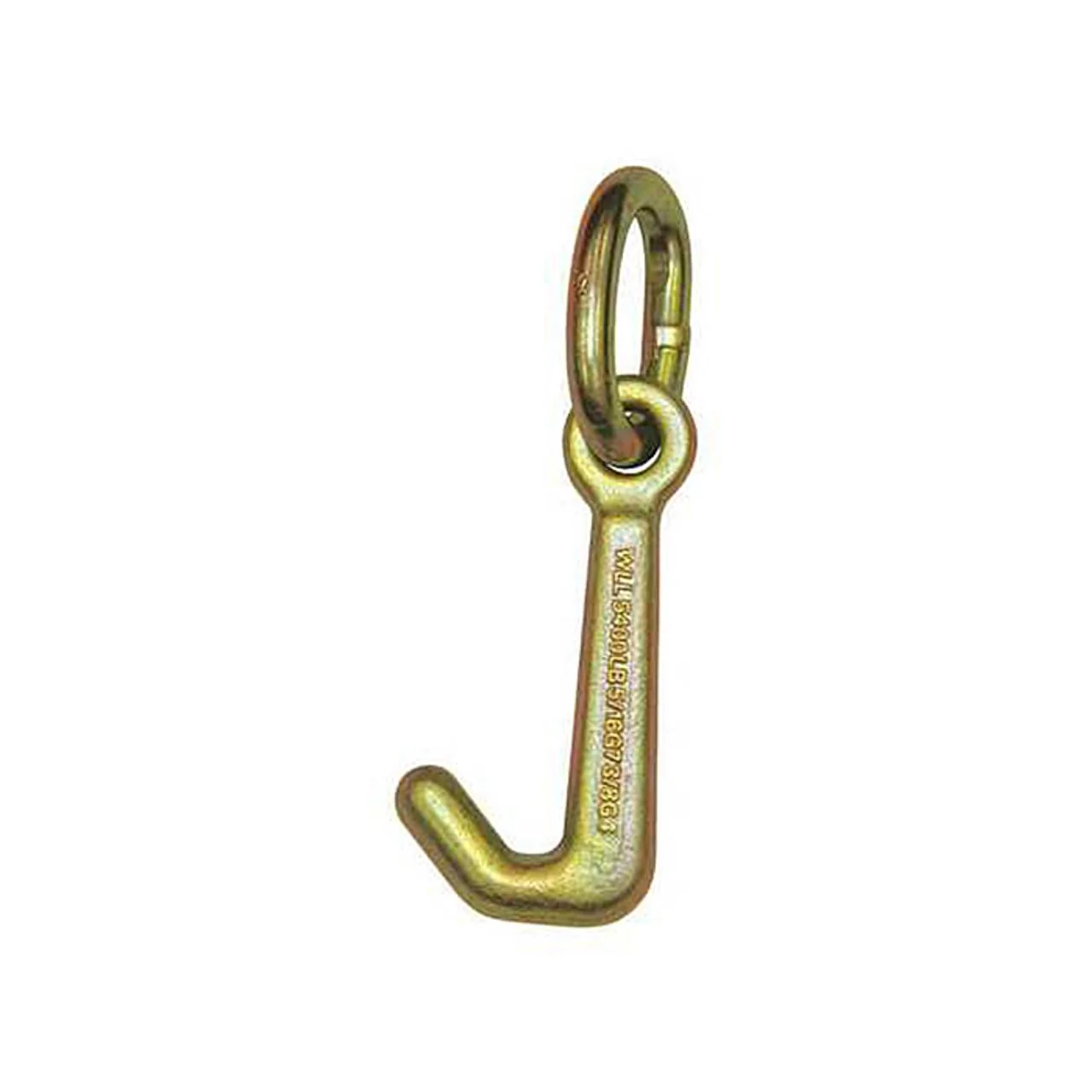

I think the mini-J hooks might be the ones,,,,,
HRG
This is what I'm going to try and find and attach to my tow strap ends.
My fear is they'll fall out when the tension is released and rip the bumper off when the tow vehicle gives its next little bump, but once I get them I'll see if there's a work around for that. Make sure they don't fall out of the hole.

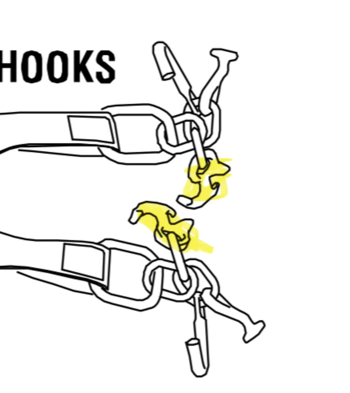

Incorrect.
Different fixtures.
Take a closer look.
I only got the ones highlighted in yellow. Those do not fit. One of the other shapes will.
Pictured is a 3-way "universal" device.

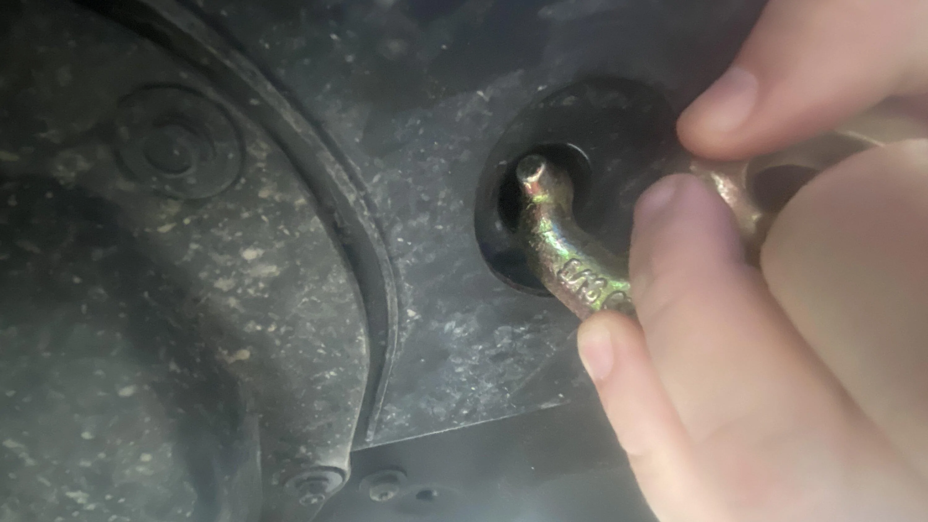

As maybe the only person who is in this thread who actually has those and have used them to get my maverick unstuck, I can add some input, use it as you will. The R hook does not work correctly, the J hook works but will fall out if slack is in the line. The T shaped one in the middle is the best I have found. It barely fits notched in at an angle and it doesn't fall out with slack. Those are plenty strong enough to pull the maverick out of anything it may get stuck in. You aren't going mud bogging and probably aren't fully loaded. Even if you are fully loaded, I can confirm it pulls all 5100 lbs of gross vehicle weight. *Please remember to use both ends and both holes.*

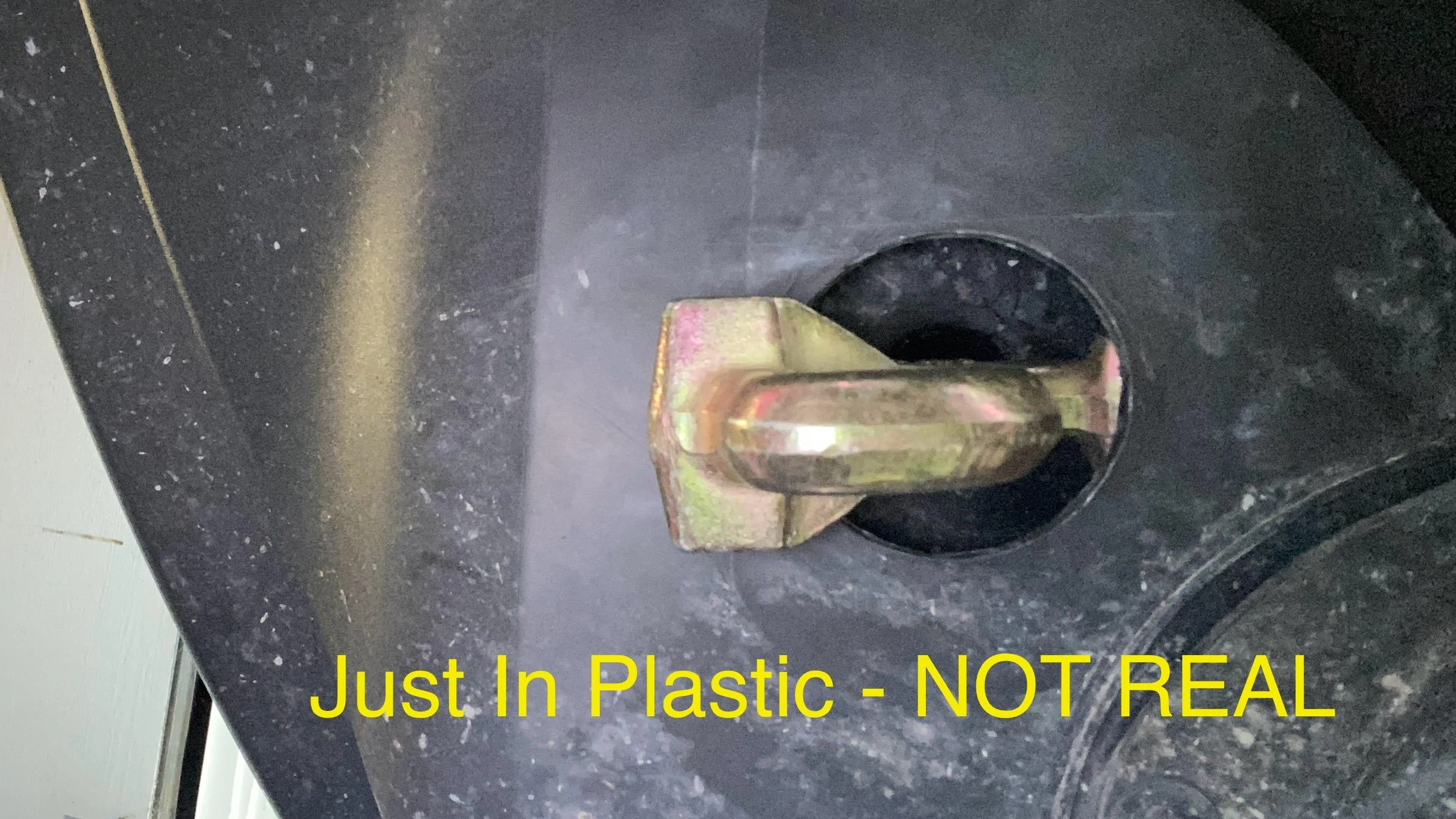

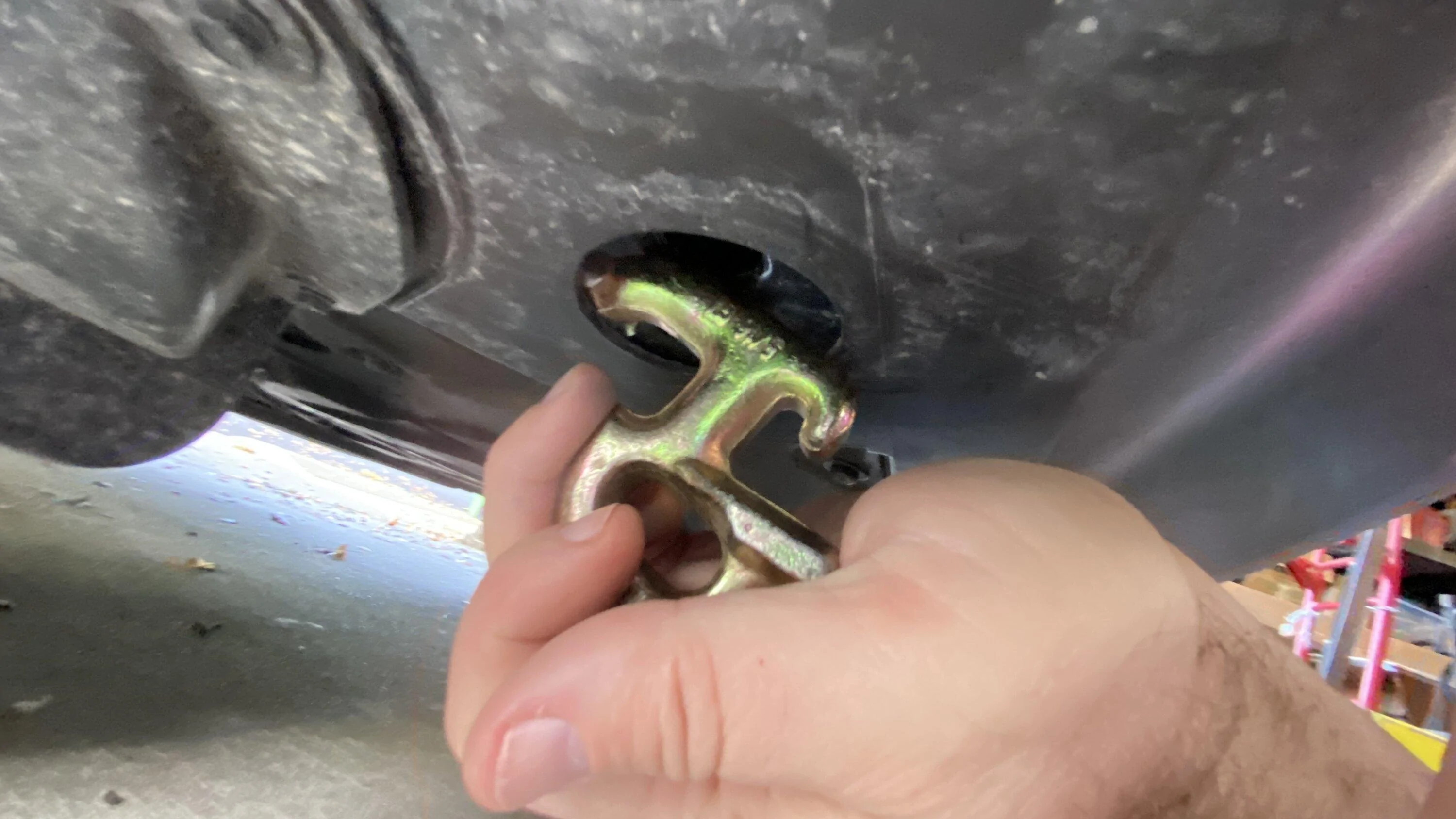

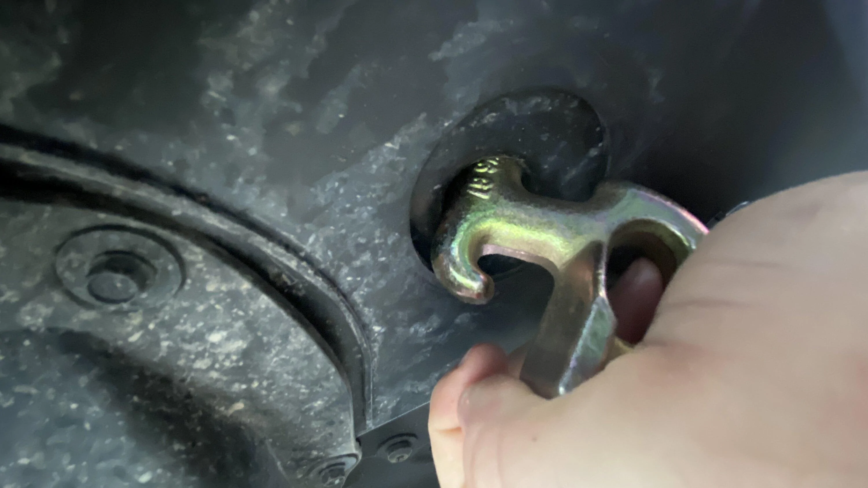

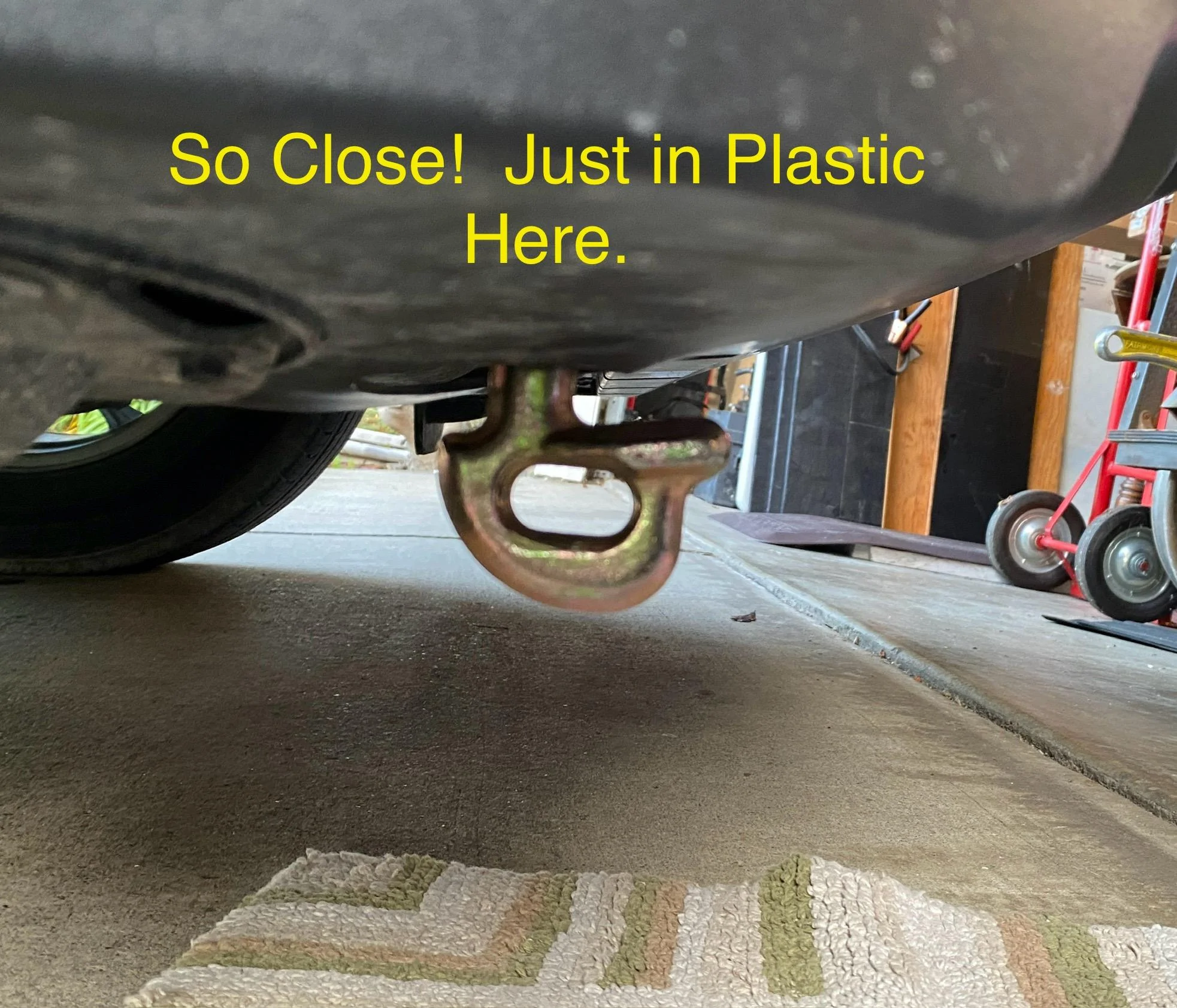

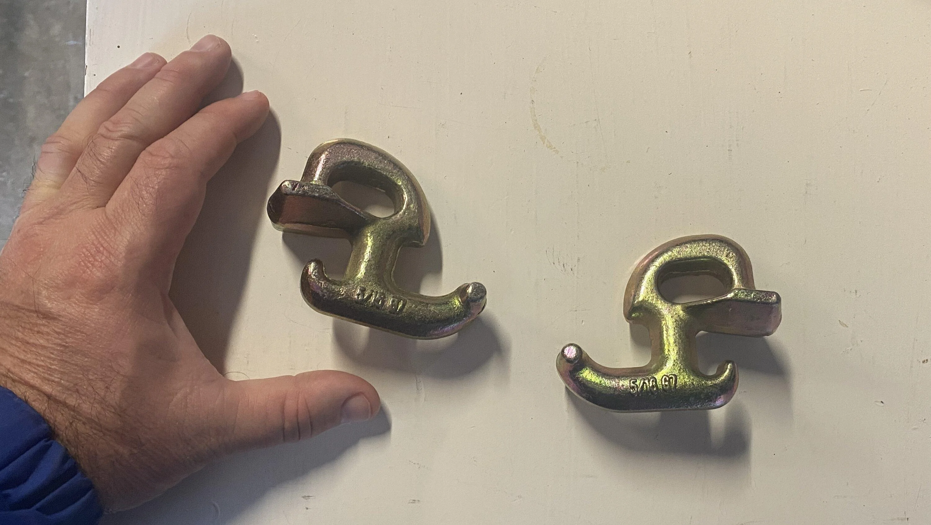

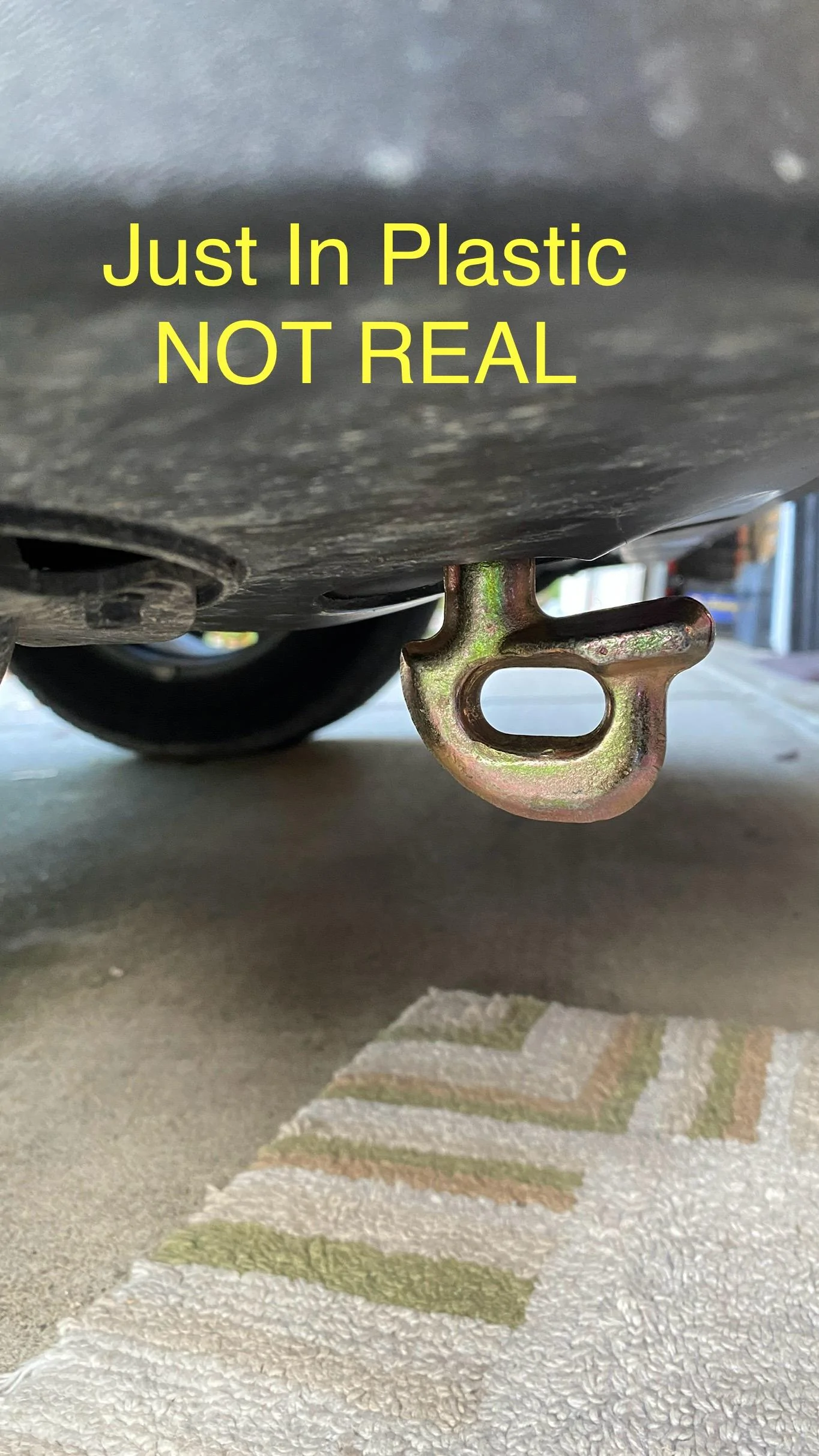

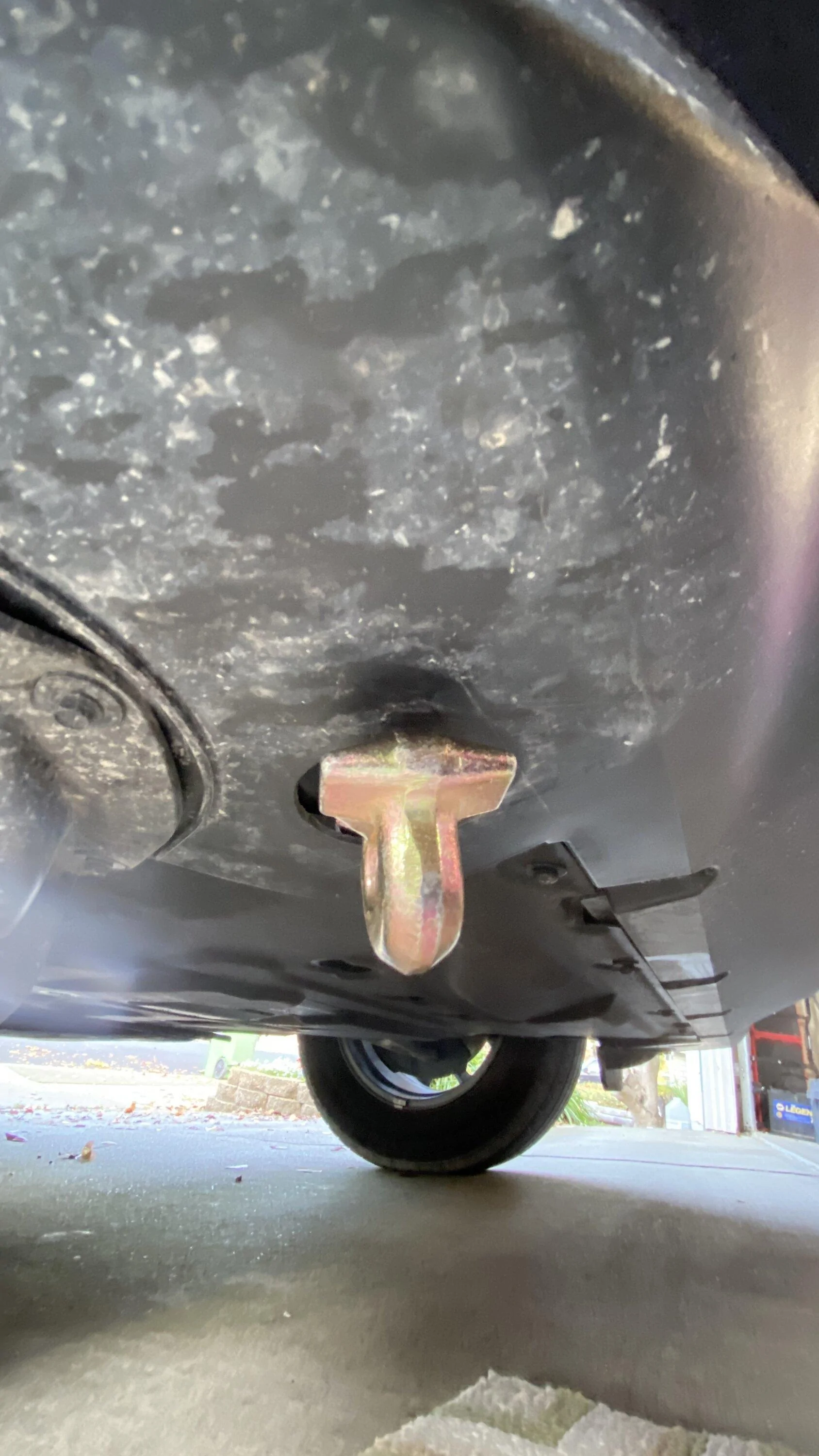

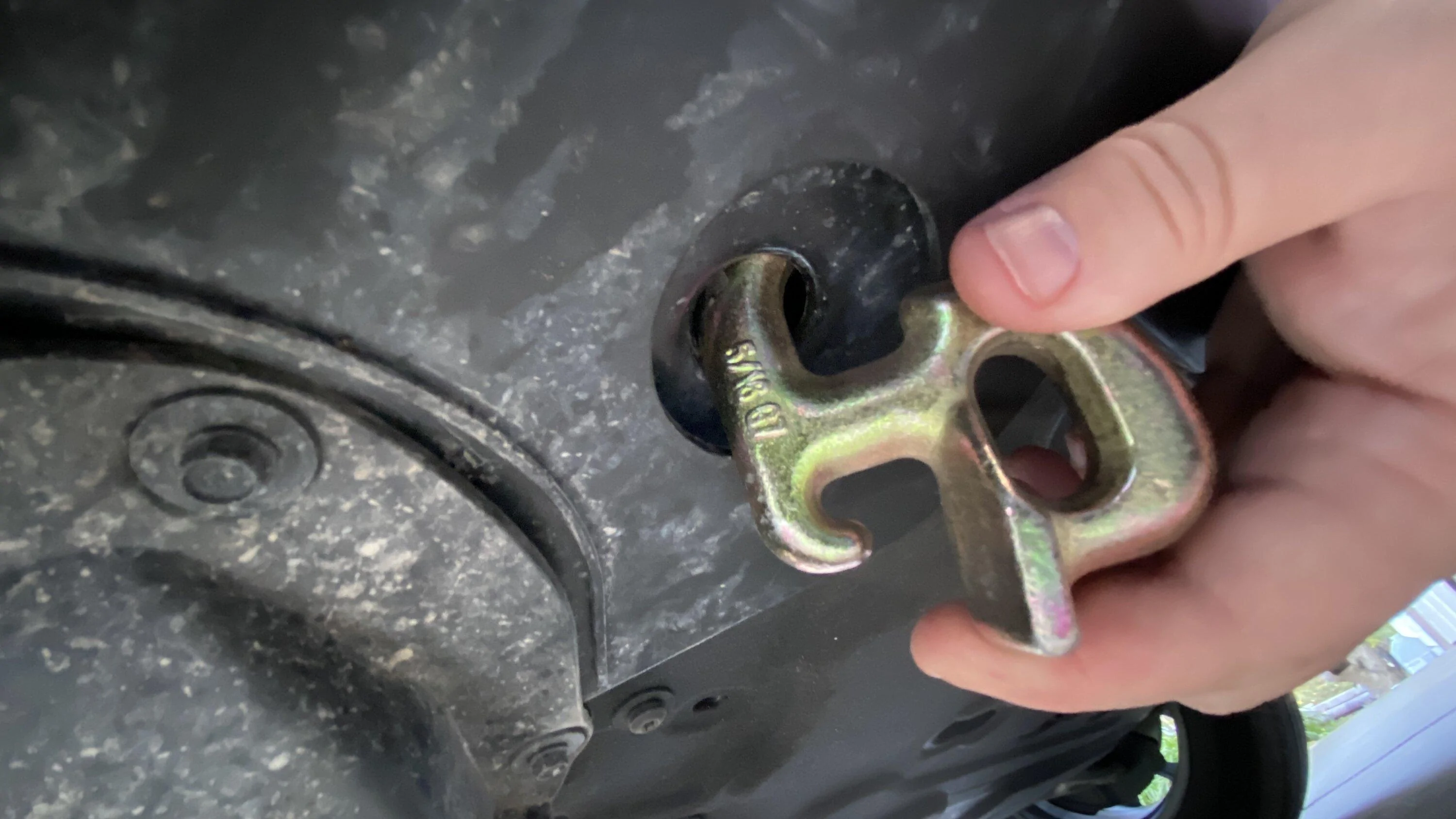

I got two of the "R" hooks in the mail.
The "winch point" hole in the Maverick is very small by comparison.
Big cutout is plastic cowling.
Small hole is in major steel member.
Will it fit??
Wiggle and contort, but a no go.
Hmm... either the hook is too big or the hole is too small. I'd rather grind off 2 millimeters of the tab on the hook. So I did.
A couple mm off the right "horn" and a couple of mm off the left horn. Should do the trick.
Ah! Success! But short lived.
While the first end went in, there's no way to get the opposite "single" horn inside the hole. I think the concept is correct, just the hole in the Ford is too small, or perhaps someone makes smaller R hooks for these smaller vehicles.
Using the larger cut out in the plastic for proof of concept, the concept works nicely.

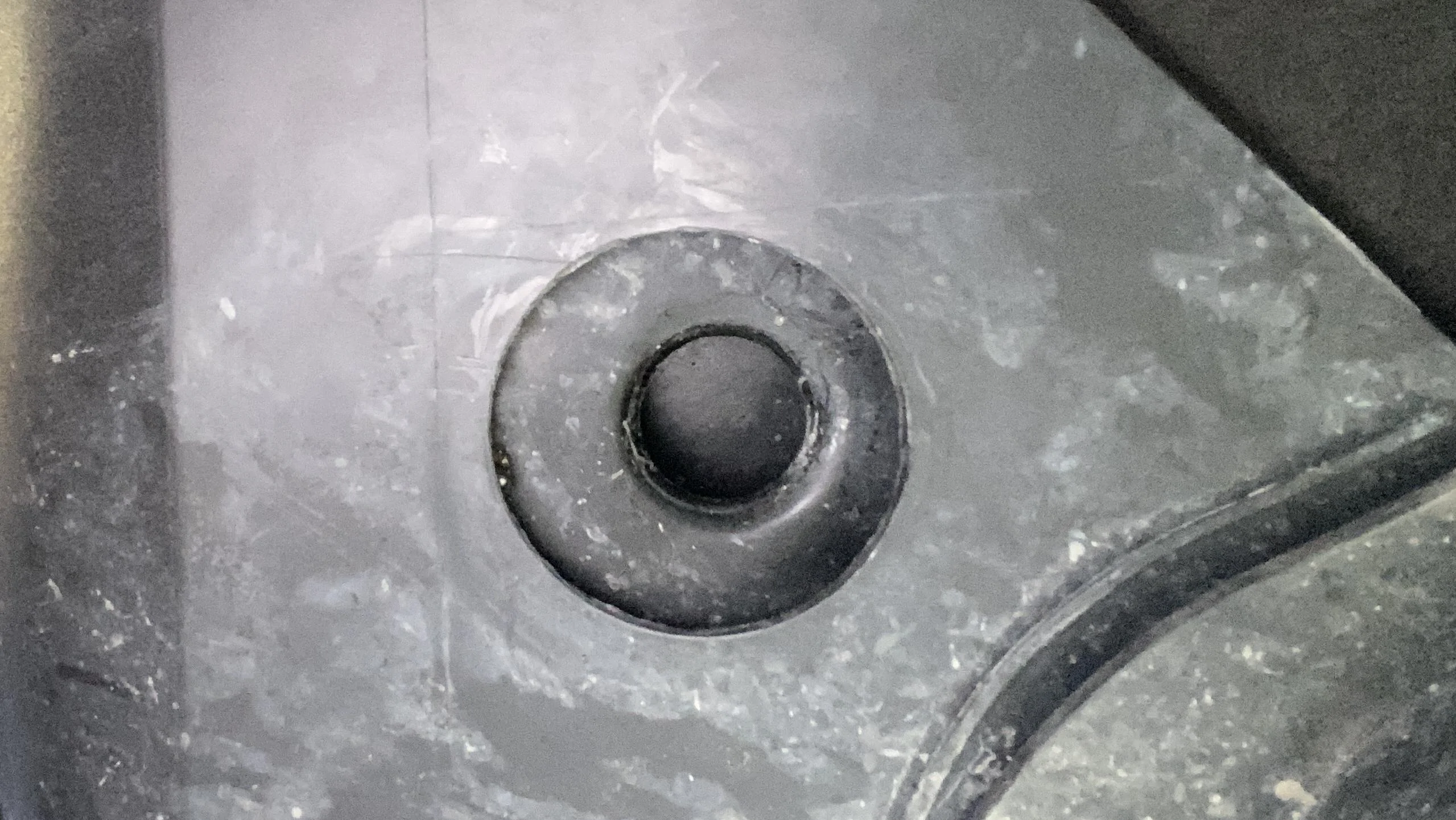

There is an older post that is closed, trying to revive the question. The pic below shows one of the 2 holes in the front (the old post had some discussion on their use but didn't answer the question). The Ford instructions tell you NOT to use chains, cables or straps "WITH METAL HOOK ENDS"!
Can anyone shed light on what is to be used, that is not metal, to tow a hybrid Maverick when stuck?

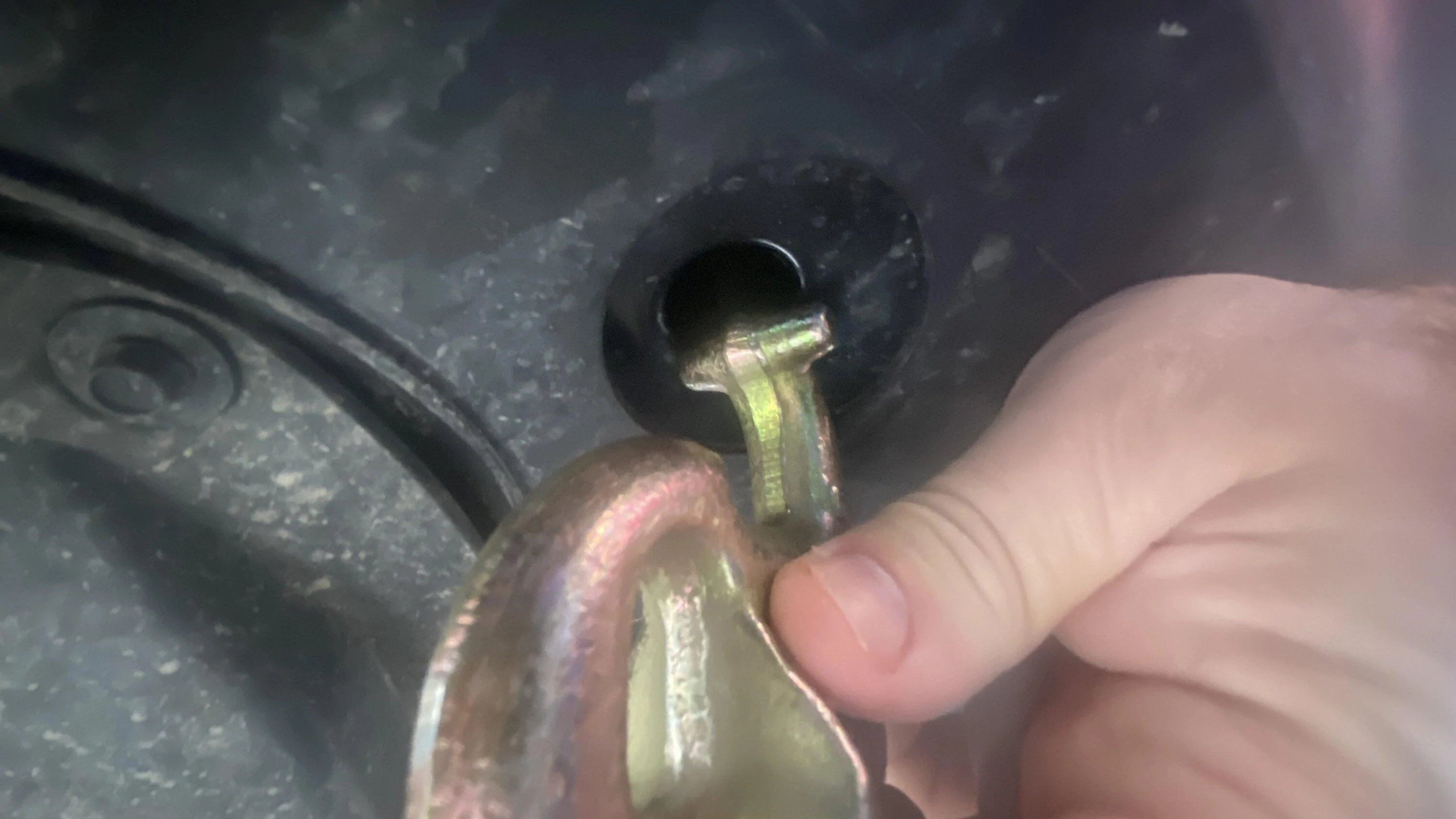

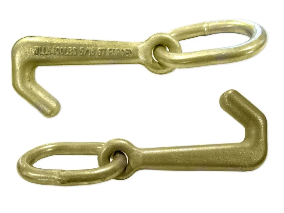

I think it has been resolved. A document was posted from Ford for professional wrecker operators to use metal ends with samples shown. I purchased these from ebay, they fit nice and don't fall out easily. https://www.ebay.com/itm/164233277991
I just ordered a couple of these, too. I'm going to see if I can attach a mini bungee to each and see if there's something easy to hook them to that'll keep the tension pulling forward on the hooks so they won't fall out. I'll do a test run before I actually need them.
Worth a try.:unsure:

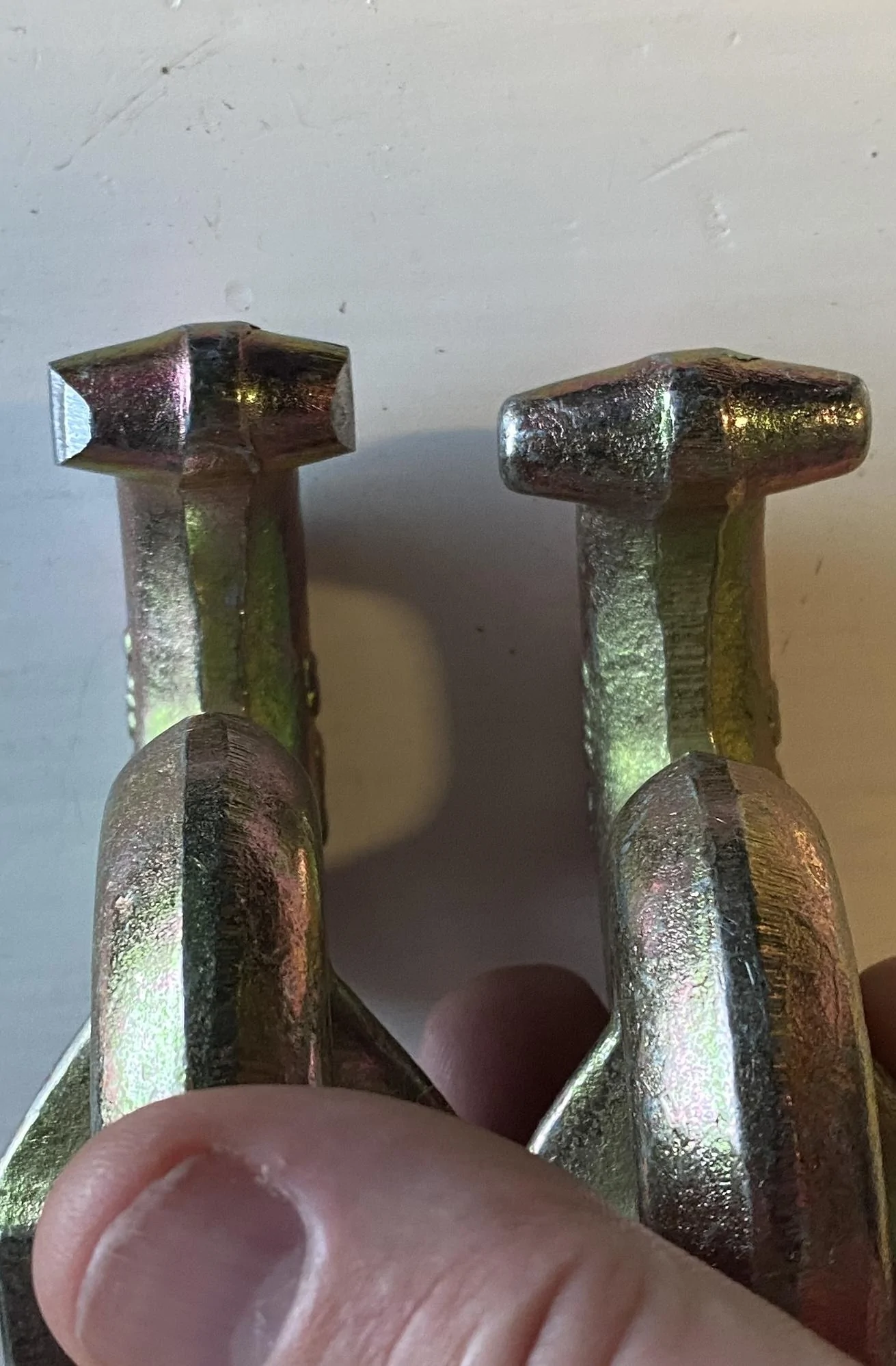

They are listed as 5/16" but to me they are equal in size to a 1/2" hook-BIG!. I engaged it in the recovery hole and shook it around, it doesn't fall out easily.
My picture may even be actual size
