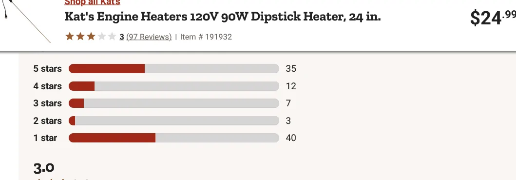

Looks like dipstick engine block oil heaters are out!
This is a screenshot from Tractor Supply Co. website - Very Scary reviews!
https://www.tractorsupply.com/tsc/product/kats-engine-heaters-dip-stick-heater
So 90W for the end of a little stick in the oil.
So my 20-30W cable over the whole oil pan really isn't far off, just needs a way to attach since magnets are out.
Hmmmm.
Scroll compressor on the heat pumps it was designed for used a big flat metal clamp around the whole thing. Oil pan bigger than that probably, how big can those clamps go, so it wraps around the bottom edge of pan with cable under it. Some high heat foam insulation so not a total pinch point - or pre-bend the metal to the corners.
Hmmmm.
I like the heat tape and clamp idea, but I would only use a non-conductive clamp. Also, I'm looking for a quick heat solution, not something that would have to be left unintended over night.
I was a bit skeptical about 90W being able to do the job in the two hour heating-time that I have been thinking about! I don't think 30W would be near enough.
I may look into heat tape for roof gutters, I think I saw those for sale years ago. They must be flame throwers, Lol!

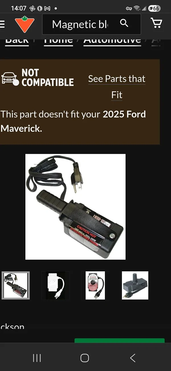

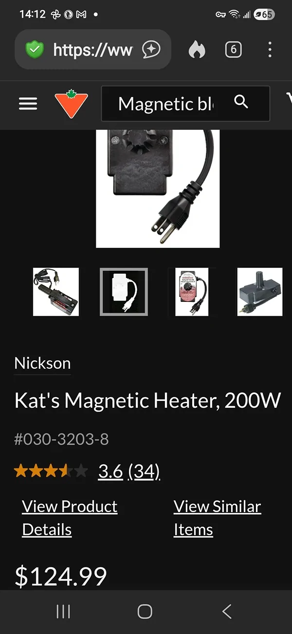

Reading your possible solution made me put on a couple coats of think and come up with my alternate possible solution.
Disclaimer-I don't know jack, I shouldn't be held in great esteem as a Subject Matter Expert, yada-yada! I have not tried this myself but really, it isn't rocket science if some one wants to give it a go and let's us know how it goes!
Earlier in this thread it was stated that our Mavericks have an aluminum oil pan. This means a magnetic block heater will not attach to it, of course.
So how about this...adhere a steel plate of appropriate size to the oil pan in an appropriate location so that it will not interfere with anything else and allow the heat to transfer through the plate, then the oil pan and then warm the engine oil safely.
To attach the steel plate to the aluminum I would think a product like a thin layer of JB Weld would work quite nicely.
That steel plate should never come off and a magnetic block Heater should be able to do its job.
Have a good one,
Andy
PS Here is an example of a magnetic block heater available here.
