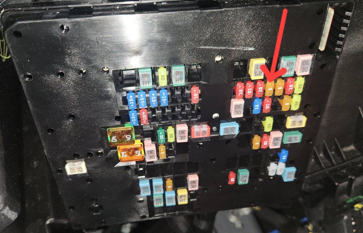

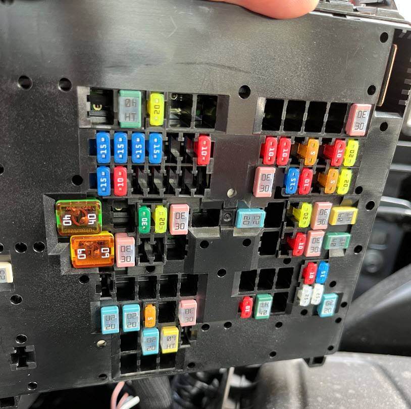

From another Maverick hybrid I see the High Temperature MCase+ 40A, 60A, 40A fuses for the PTCs on the top row.

I haven't pulled apart my hybrid's BJB to look at it.
I did on my previous 23 2.0L Ecoboost and those fuses not installed since no PTCs:
Ford Maverick does 24 hybrid have the supplemental heater for 23 Maverick 2.0L Ecoboost BJB Fuses-1

It's in engine compartment.
Bit of a puzzle to open and have to make sure it reconnects correctly to bottom half.
Look in Owners Manual on how to unlatch fuse box from bottom junction box and open its lid.
I'd have to agree it's a "dufus" design.
I began opening that, and it looked like it had 3 large plugs under it. I closed it back up 😂 I'll have to dig in deeper

The large plugs are the power distribution from the "bottom" of the fuse box. You unlatch the two tabs and the whole thing flips over towards the front of the truck (this disconnects the BJB from the main power bus in the process) and remove another cover to access the fuses themselves.
