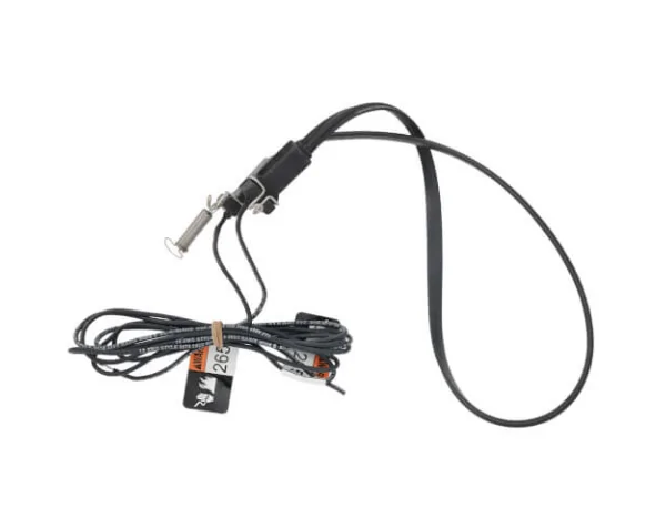

heat pump compressor heater wire - Google search.
Got one of those and ended up not using it.
Meant for 240V at the unit, I wired a standard 120V wall plug on it, so half the watts.
It turns on and ramps up the resistance/heat as the temp decreases past a set point - automatically.
Mine seemed longer than this picture, maybe not.
Used in outside cat house under blankets for a couple visiting cats in winter.
If it could be held to the oil pan with magnets, and cable out front zip tied safely - not sure if the 20-25 watts would be enough. Under shield would keep it safer at least.
You can buy with varying turn-on temps, and max power.
