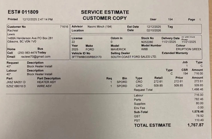

That does not include the 7hrs labour's involved in it. Maybe just park it in your garage.
Aww c'mon, it's only money. Here's a quote I found (12/2025), in CA dollars though.

I think only DANG! describes my reaction to that invoice appropriately.
The block heater installs tight under the exhaust manifold, so it has to come off, the cat converter off with its wiring, and a whole bunch of other stuff. Its a nasty 7hr job that makes it impractical to do after purchase. Just buy a truck with the option installed before they put the manifold on the engine at the factory.
You are right about it being way too much work as a retrofit with a ridiculous price tag.
The problem is that you can't get the truck with the block heater as there is a recall, no replacements parts are available, and they can't build the truck with it installed, unless that changed recently.
