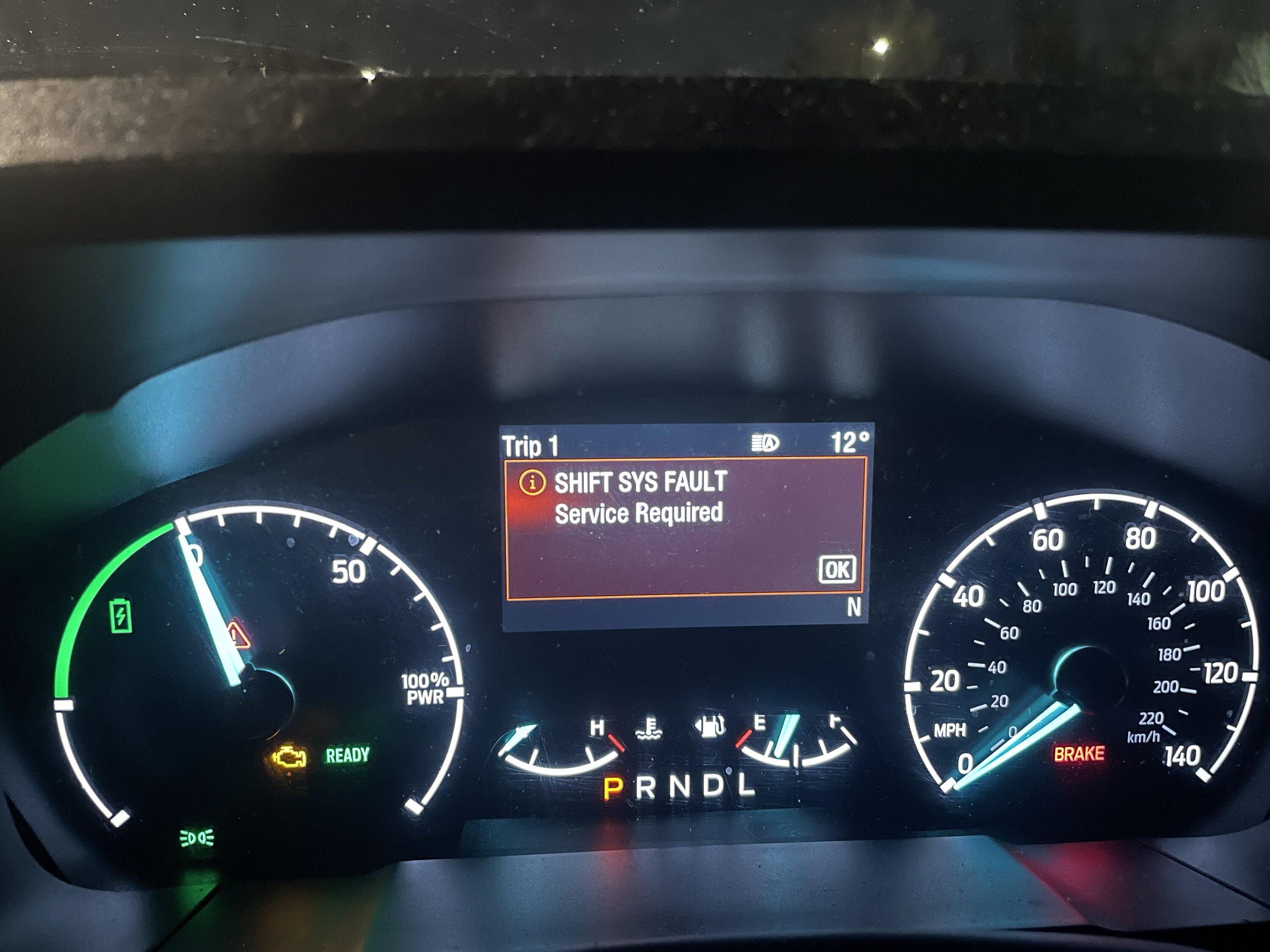

It’s all lights, anything electric. Locks, overhead lights, dash, airbag sensor. Got a jump yesterday and was able to drive it for a bit to the store. When I got back in I got a message to stop the car immediately and received a “SHIFT SYS FAULT” and it forced the parking brake so I couldn’t move. After about 10 attempts it let me remove the parking brake and I was able to drive home but I guess I’m getting in touch with the dealer on Monday.
Ford Maverick Maverick completely dead in the cold, best options? B5E9838B-666E-4426-89A8-D1B36A0E5D3B
