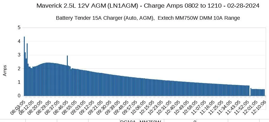

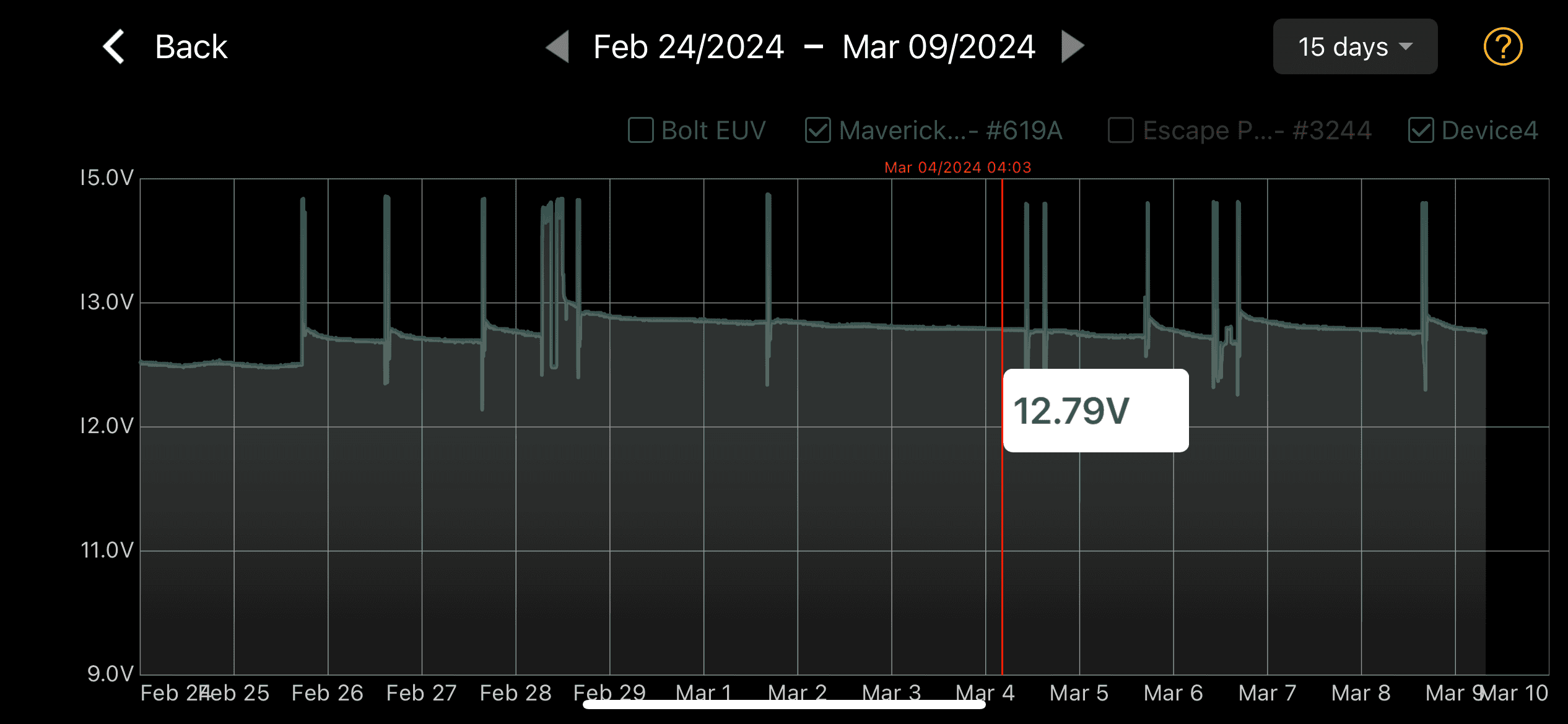

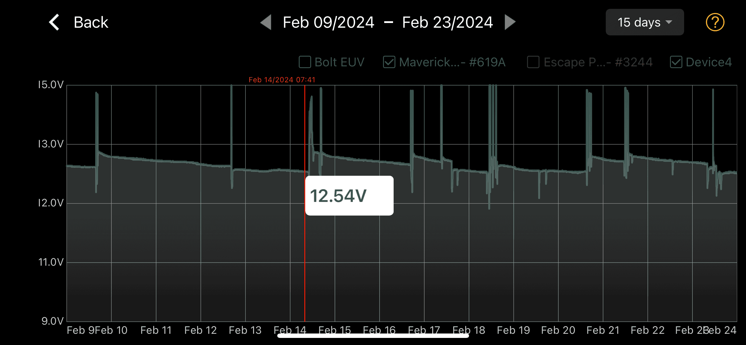

Which one did you get? Did it fix it? The last problem I had was when it was really cold back in February. Luckily, after it got warmer, I haven't a problem since.
I got the instrument cluster recall updated about a month ago. Now, I see there's finally a battery recall update for Mavericks/Broncos now. A battery issue can actually shut the vehicle off while driving or something. Maybe that's related to the battery drain too?
I'm gonna do another recall update for the battery this time when the Ford dealer contacts me again and stick with riding it out until the winter and see if it will keep holding a charge. Could they possibly have a fix? Either way you can't go wrong getting the AGM.
I got the Interstate AGM, H6 size (I have an ECO Mav). A lot of the Hybrid owners are getting Die Hard, AC-Delco and the EverStart Platium (H5 size). This did fix my battery issue (along with changing the charge level with ForScan).

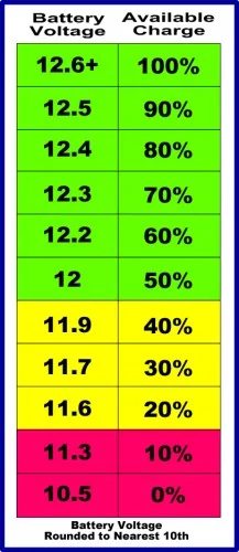

This. It really doesn't matter. It's an issue with the system. No amount of battery changes across any FORD Forum plagued by this issue have solved it. There are some AGM batteries that are essentially double what FORD offers, but it doesn't change much if you are constantly below 11.4 volts.
Unfortunately the only real solution I have ever seen reported that actually works - is a battery tender (charger). AGM's may handle the FORD's nonsense a bit better, but the issues are still reported by many drivers with AGM's.
