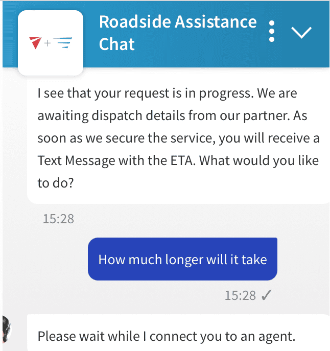

Mine has been dead since Thursday, dealer had me hold off until this week due to Christmas. Now Ford Roadside Assistance is supposedly dispatching a "partner" to tow my vehicle to the dealership but that hasn't happened after hours of waiting and status updates go unanswered (never connected to agent):
Ford Maverick Maverick completely dead in the cold, best options? 1672173902104
