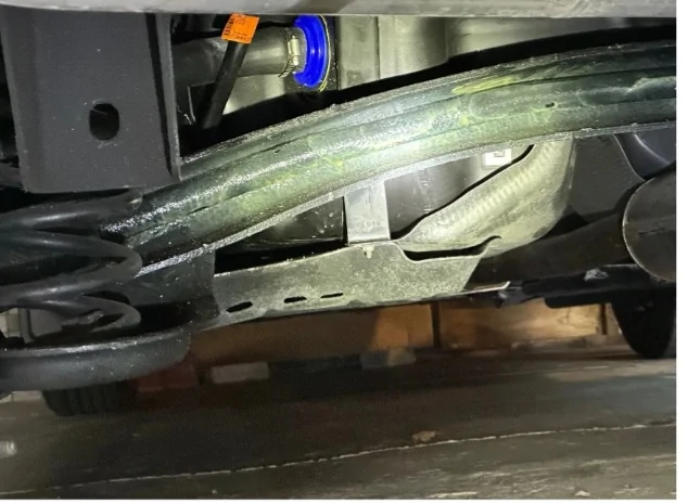

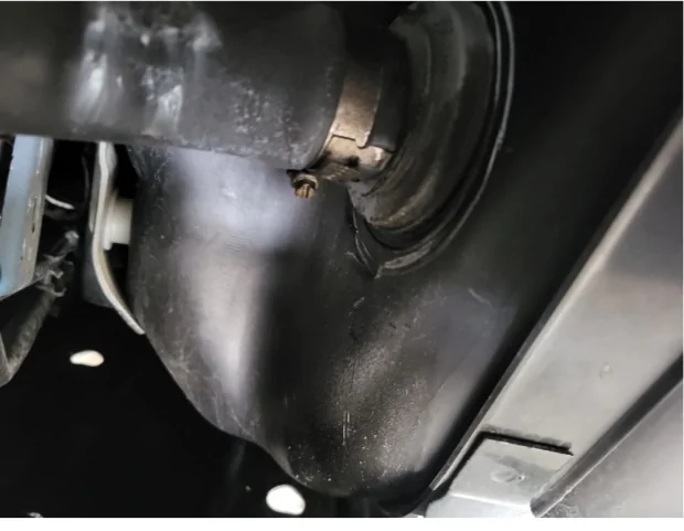

Well I guess that takes care of the latch locking mechanism being bad.
I'm now leaning towards scenario #1 you have a leaking fuel tank. The common and obviously leaking point is pretty easy to see.
You may want to take a look underneath with your phone and take a picture. Plz keep us updated.
Ford Maverick Manual fuel door release.... 20260215_134626
☝☝Old style seal.
Updated blue seal👇👇
Ford Maverick Manual fuel door release.... 20260215_134556
Good Luck.

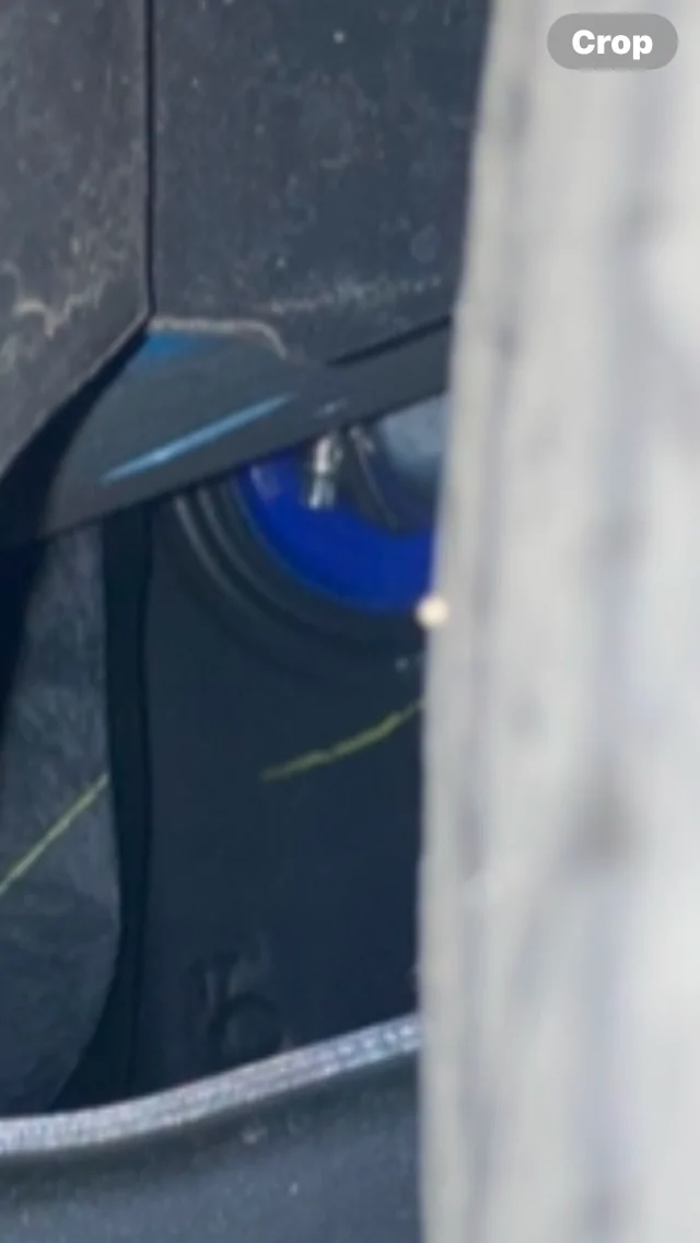

I think "Matso" ☝is referring to 👇👇
Ford Maverick Manual fuel door release.... 20260216_124003

Actually reading a post before commenting on it would be helpful.

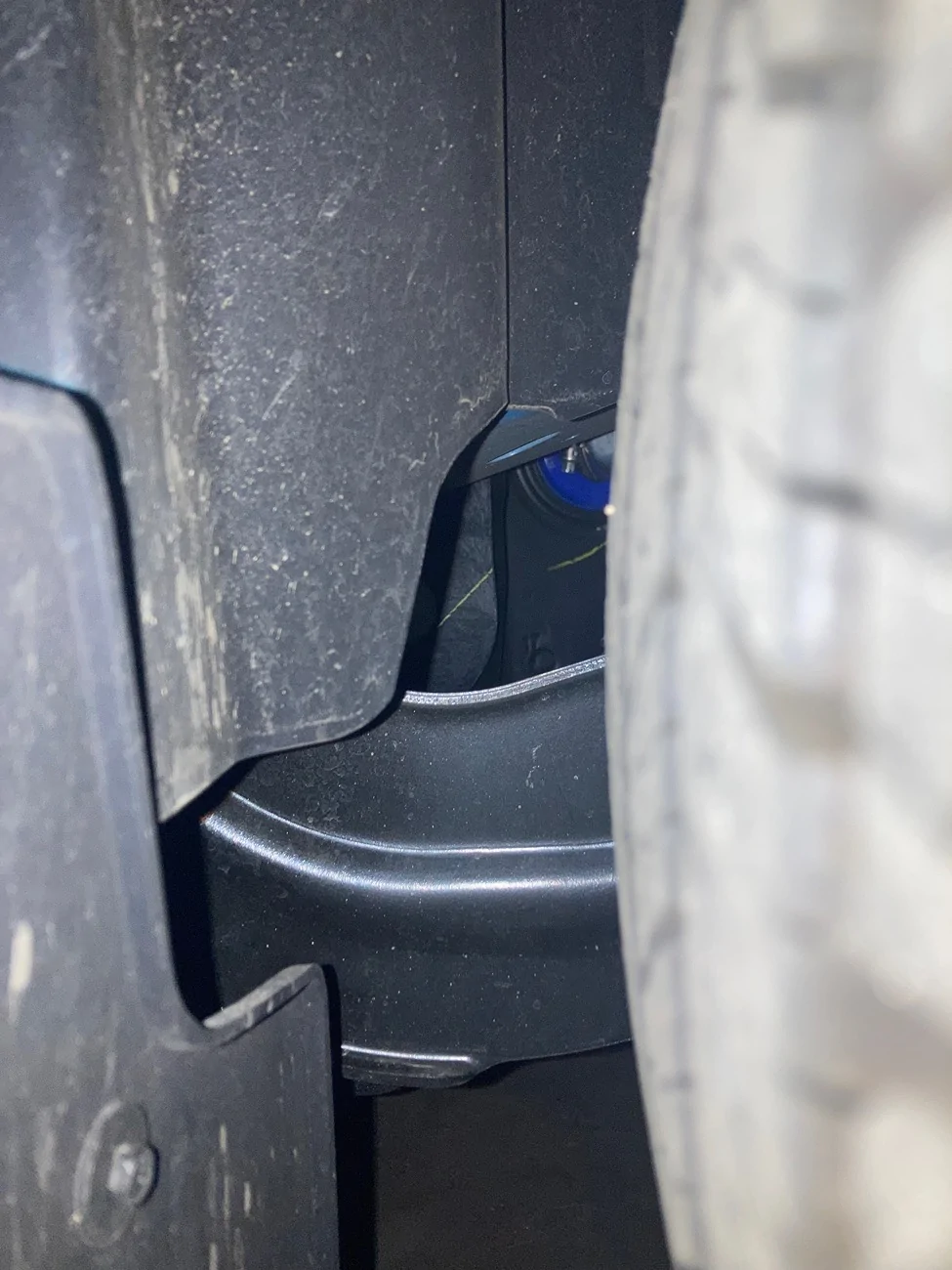

I think the “blue seal” is on 2025+?
My 25 Lobo has the blue seal - visible through the gap in the driver side rear wheel well….will need a flashlight;)
Ford Maverick Manual fuel door release.... IMG_0543
Ford Maverick Manual fuel door release.... IMG_0534
