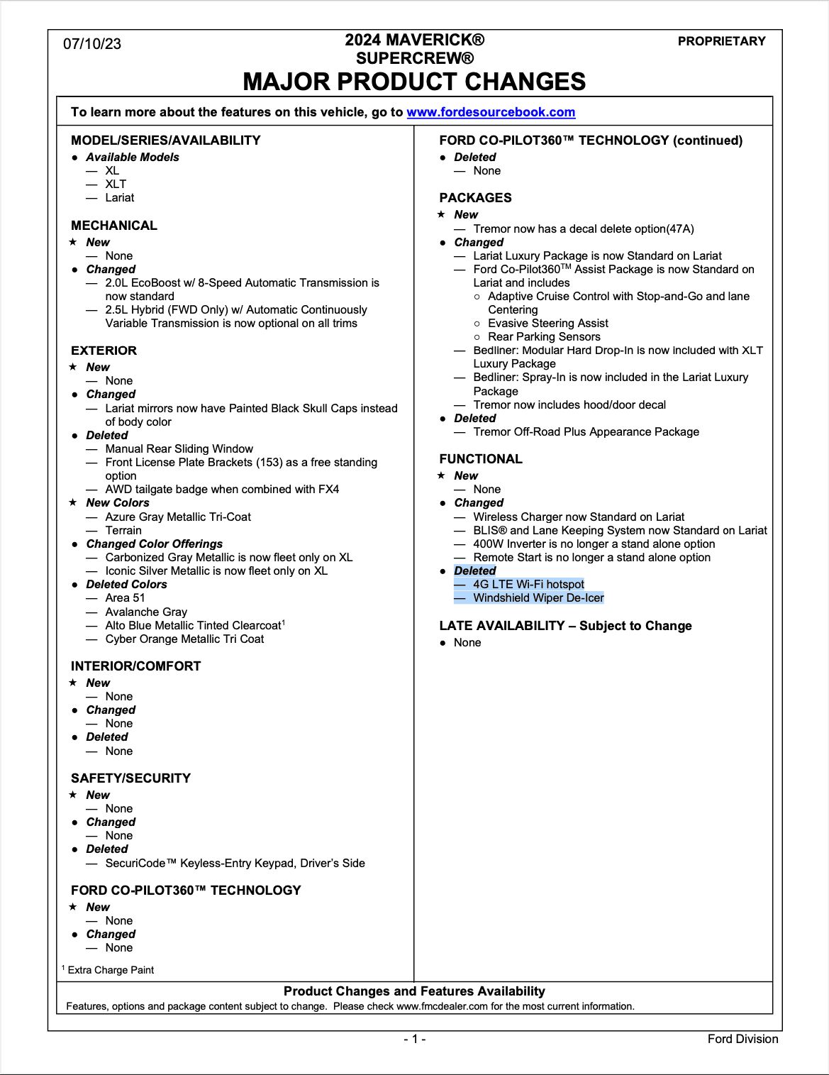

Was a '23 now a '24 Lariat Lux

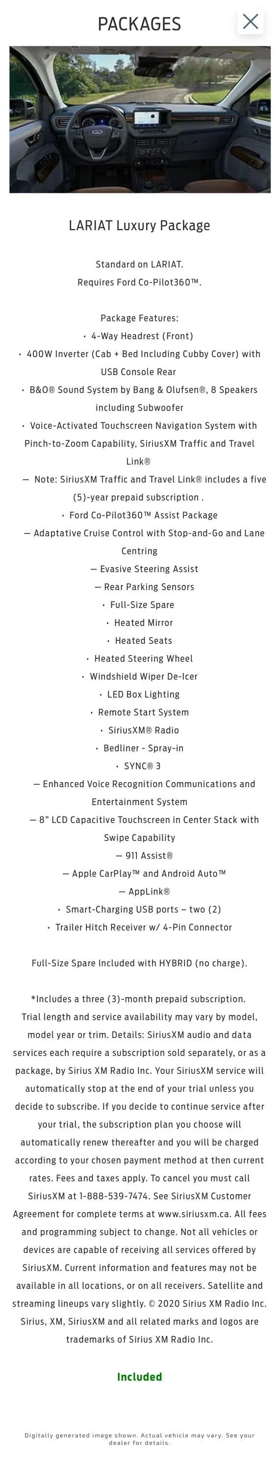

…The heated wiper park required the Luxury Packages (XLT or Lariat) for 2022-23MY and has been discontinued for 2024 MY.
Unless windshield wiper de-icer is something different it is still listed in the Lariat package for My24.

Well that’s a slight disappointment, but I will get over it. We get more rain than snow and ice on the Wet Coast of Canada!
As a fellow Canadian wet coaster, with a Maverick with that feature, I can tell you the heating element doesn't do much with snow. With frost it helps and it also helps keep ice from forming on the wipers while you are driving. Nice, but nowhere near as nice as the much more important heated steering wheel and seats in the lux package.
