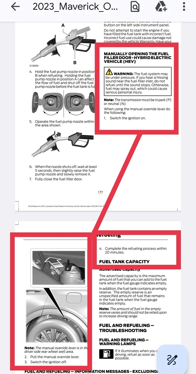

I thought that thing you pull was for 2.0 gas only engine not hybrid so there is one for hybrid?? I guess I have to look on mine.
As far as key in ignition NEVER has the key been in when I hit button. I pull up to gas pump remove keys open driver door THEN hit button to see gas door pop open.
I’ve been on MTC for a year now and some of the stuff, no most of the stuff just confuses me that gets posted. My 24 Eco has never had a little green tampon string in the wheel well for the fuel door, my OWNERS MANUAL told me so! It said HYBRID ONLY. I thank my parents for sending me to “Skule” so I could learn to read. 😉

You have to have keys in the ignition and on to use the emergency fuel door tether.
You do not need keys or fob to open the hybrids fuel door, just press the button once you're inside the vehicle.
In post #1 the OP never said he was locked out or didn't have keys.
Glen is a very helpful guy.

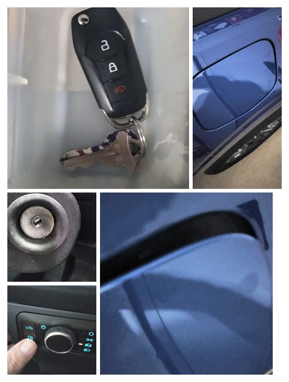

But Glen, you read the book but didn't do your homework.
The green pull tab is completely mechanical. No keys needed. No ignition power needed. Nada. Pull tab, door opens.
I just verified. Truck was locked. No keys within 100 yards.
Shhhhhh. Don't tell the kids.
(Unknown it you'd need keys and power to refuel or siphon, because it's dark out and I don't feel like trying either.)
I believed the manual.
May Ford needs to be notify of your discovery. I wonder what fords reasoning was.
Good to know
