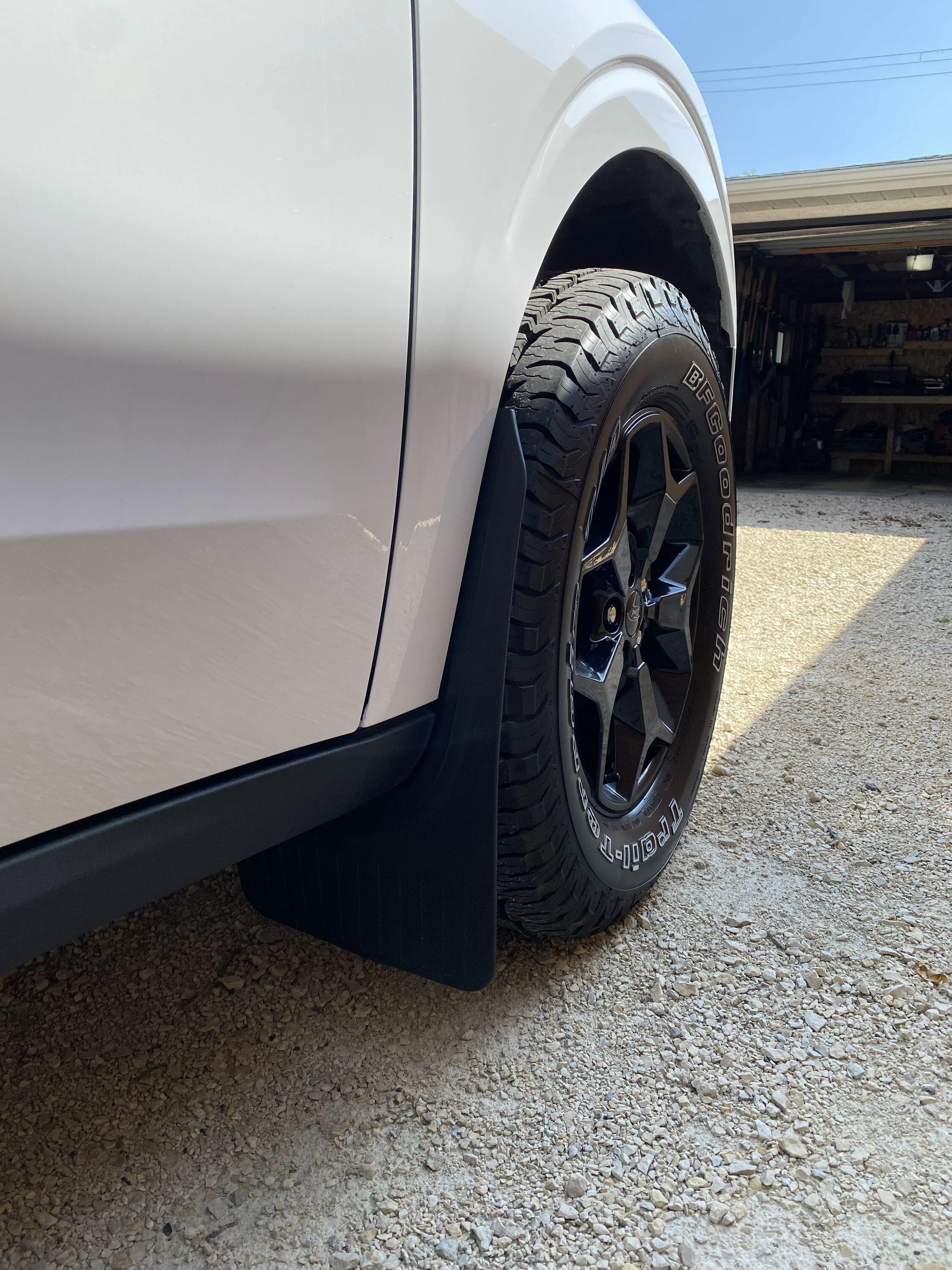

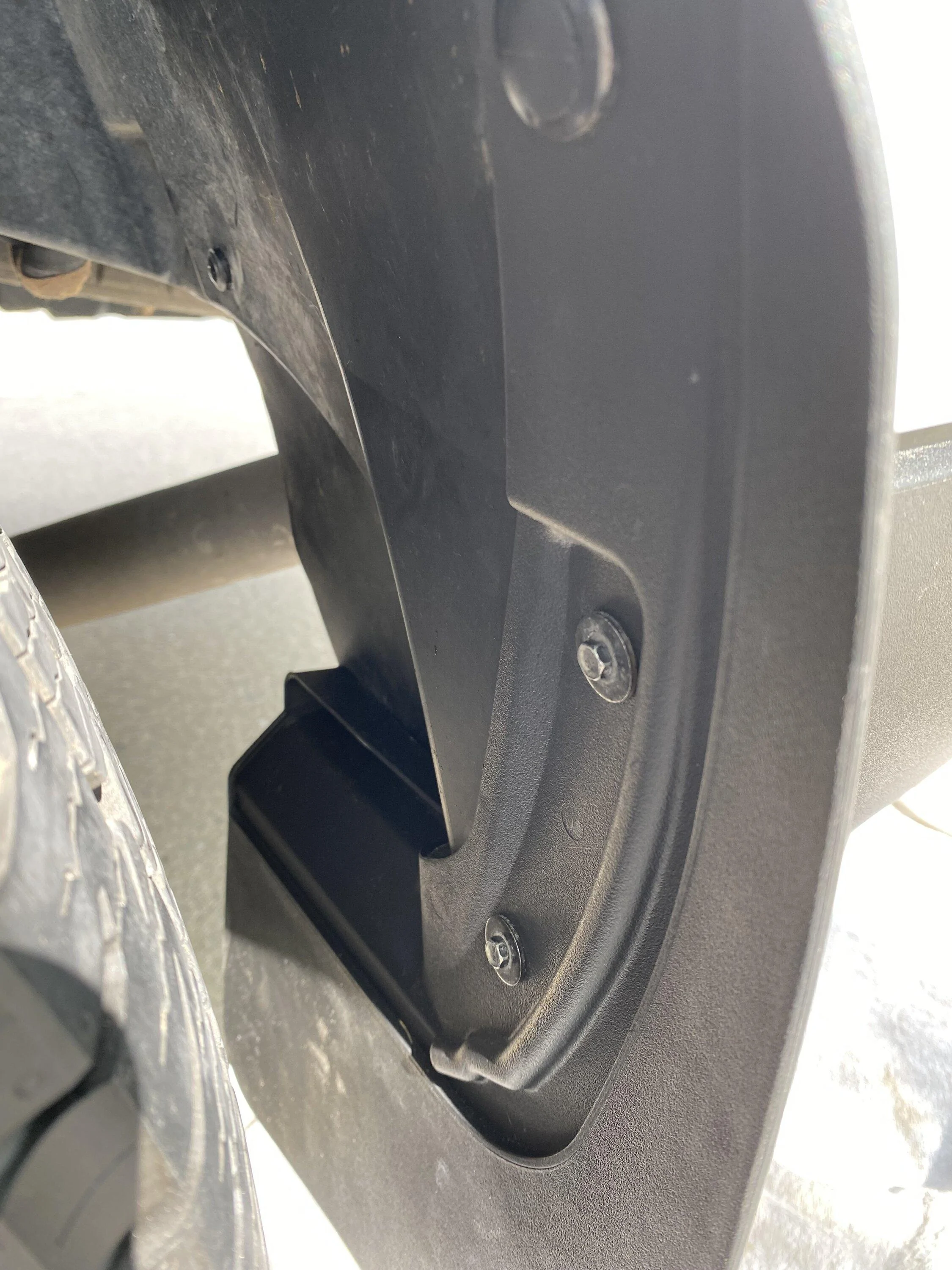

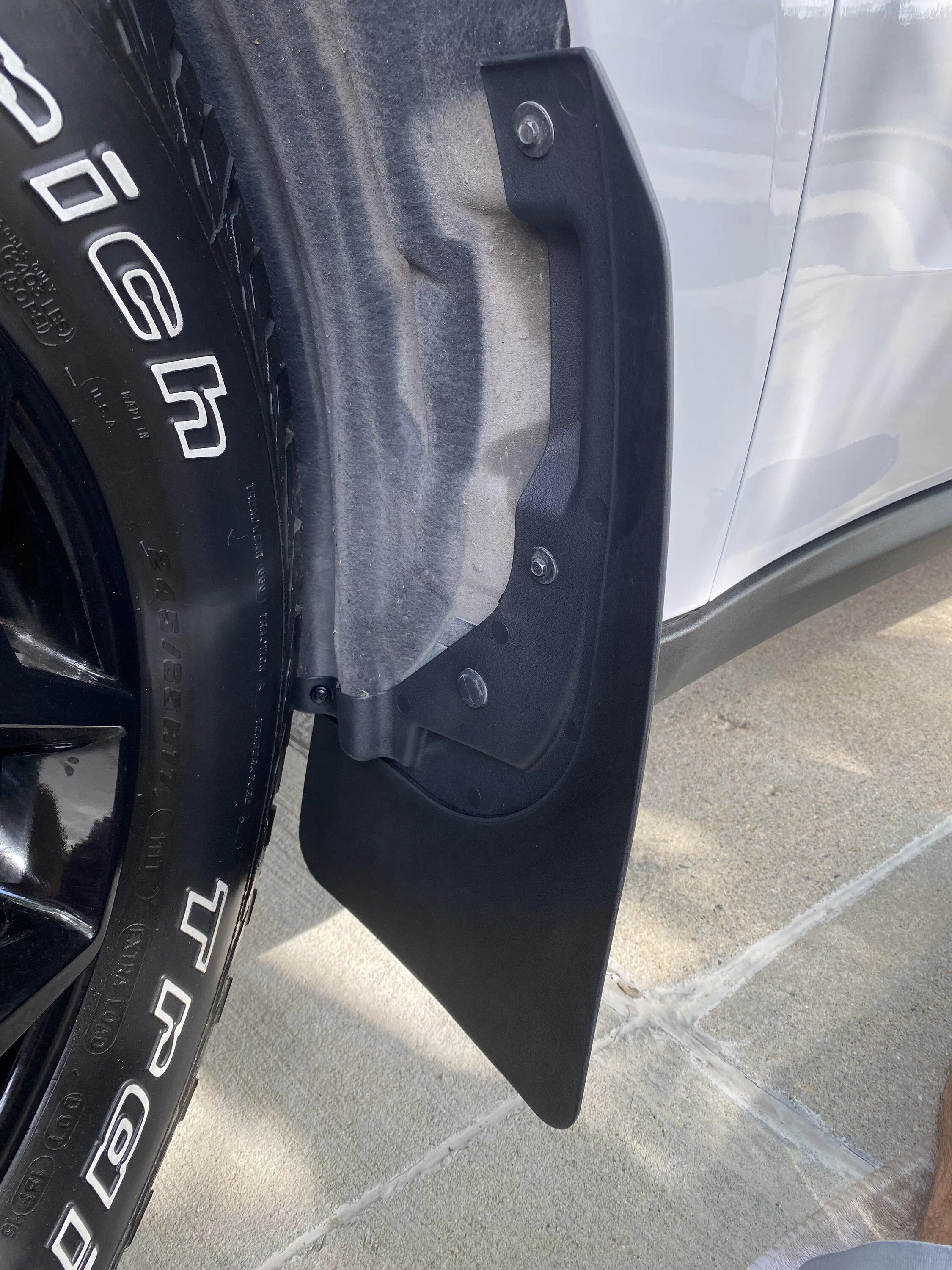

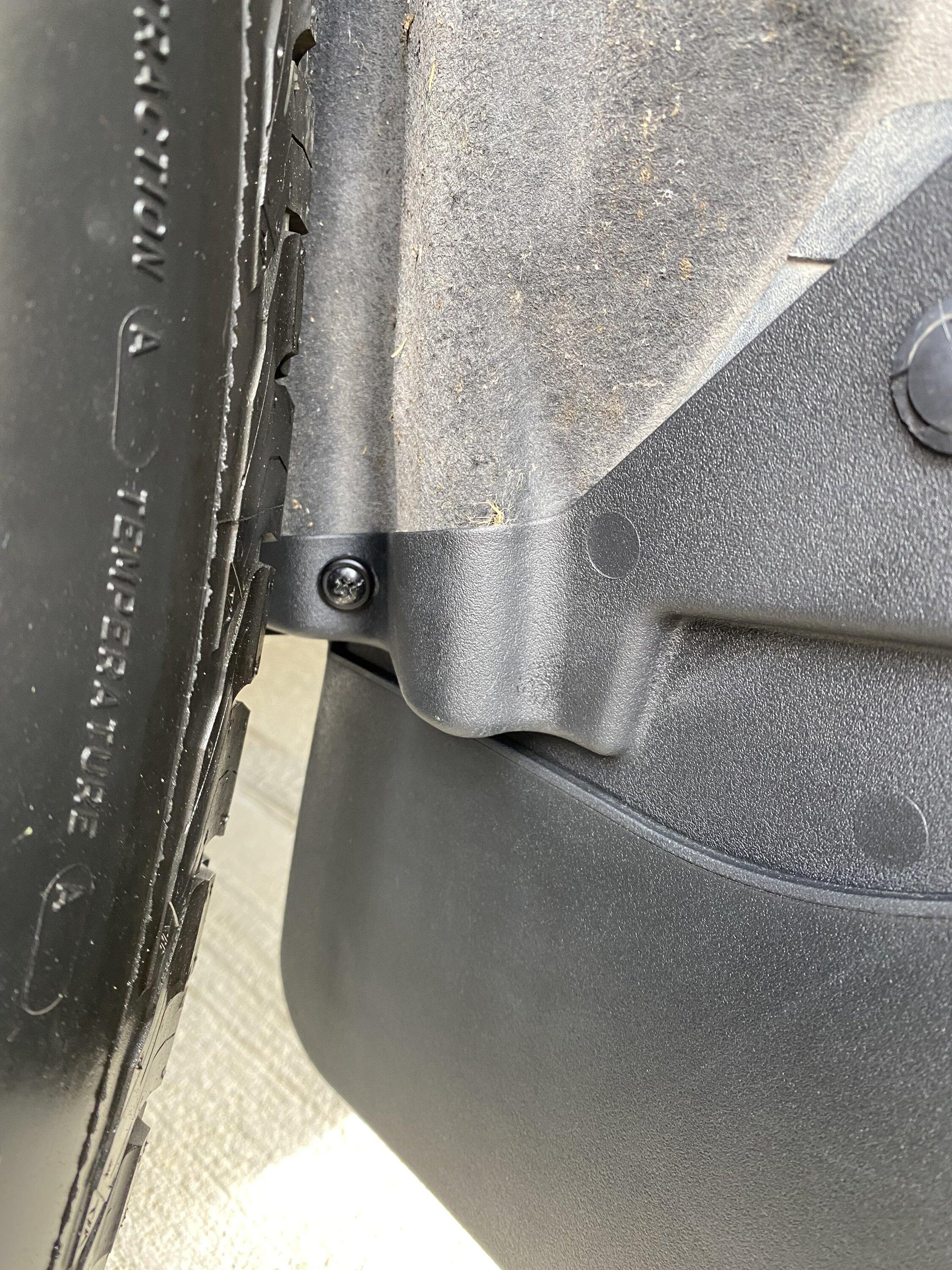

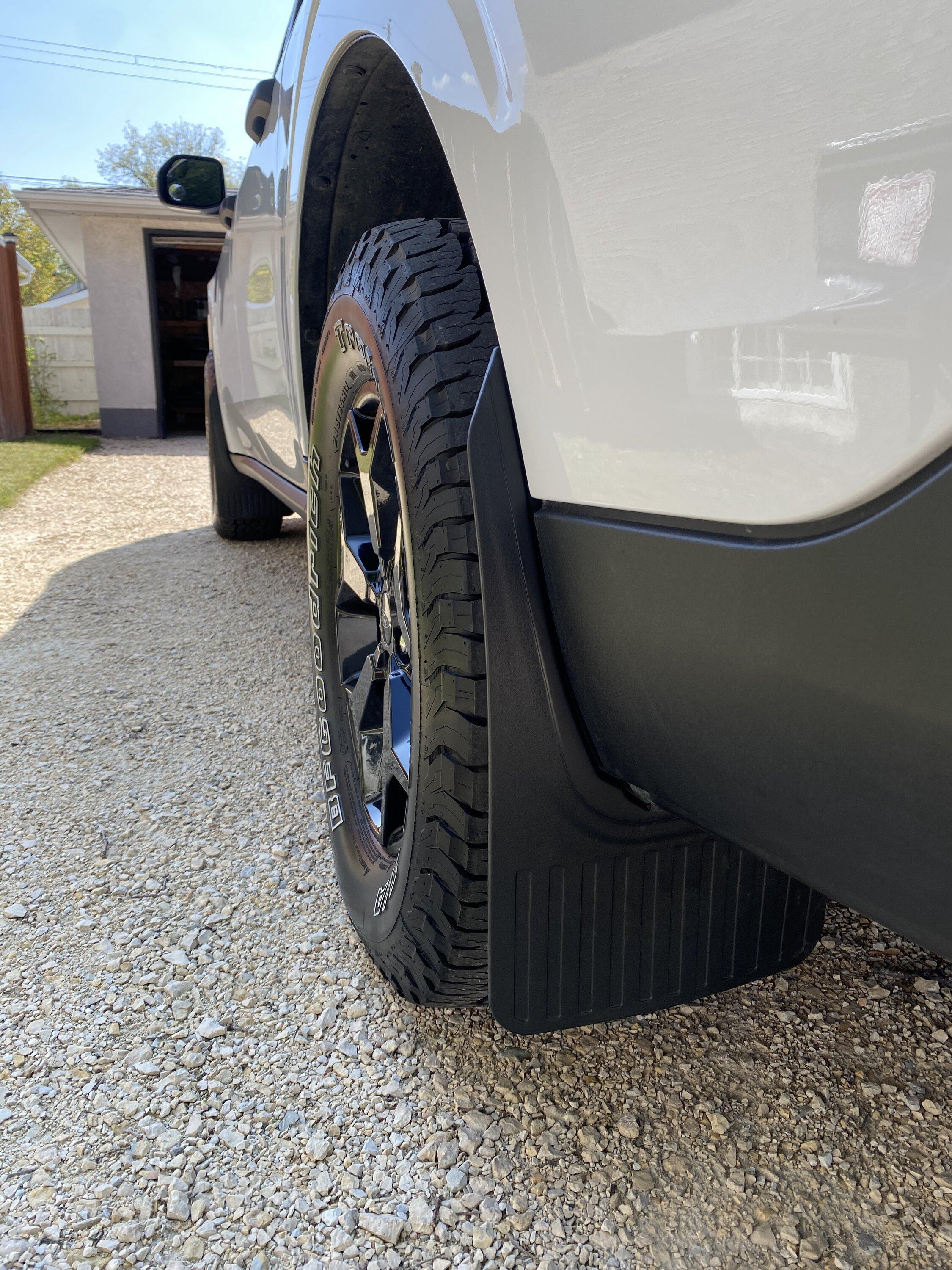

Just installed these today, with wider tires I think they look better then the stock flaps as they have better coverage. I also added screws on the inside of the flaps which fastened them much better. I wish they came with screws to begin with. Covered the rear drivers side hole too while I installed these. In the pictures you can see how much wider they are than stock.

Yeah, I’m going to put in screws before they fly off in a rainstorm…I have the screws and mollys. So I have no reason to not change with the plastics…which are loose.

I also installed screws to the little bottom projection. Should have been in the instructions, but the guy that created them has probably never seen a Maverick.
