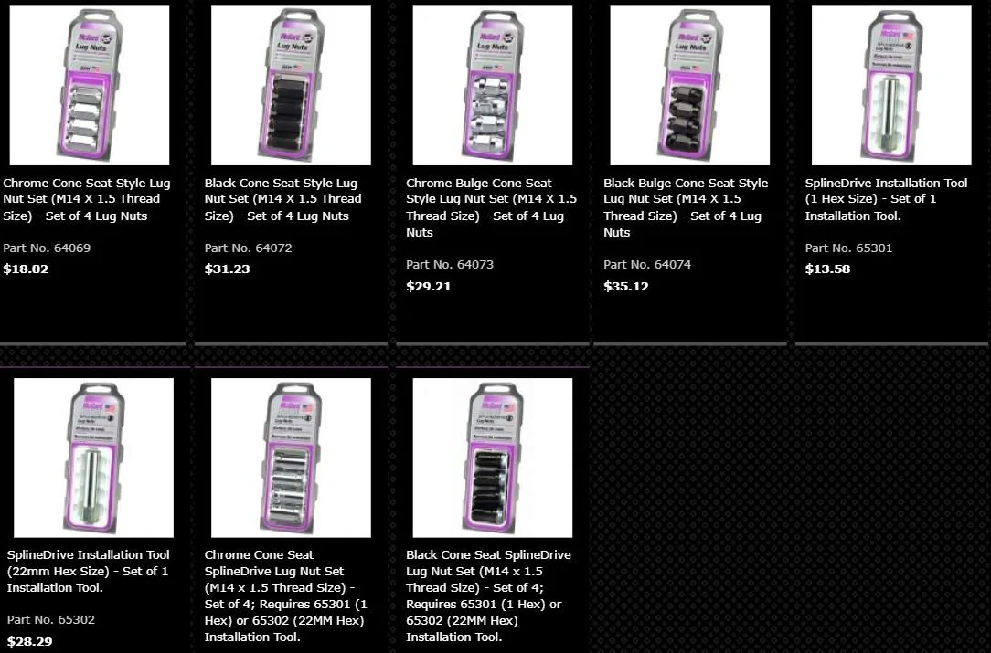

This is what Gorilla sent me yesterday, for a Maverick.
HRG
Gorillas are good, McGard is probably better.
Reasons:
McGards r made in the U.S.A., Gorillas in Taiwan. Taiwan is a democratic ally at least, so not bad. Some Amazon reviewers got a "dump bag" of Gorillas and had some complaints about QC (quality control) defects seen. If you order the clamshell Gorillas (Amazon links below for reference), maybe there will be less problems with quality and possible counterfeiting when ordered(?).
McGard is only about 50 cents more per lug nut on Amazon than Gorilla. McGard's reputation is impeccable, maybe worth the extra dimes.
I would avoid ones made on the Chinese mainland, and Amazon usually tells you where they come from. Why: Quality? Safety? Thread dimensions right? Metallurgy? You know, all the engineering stuff. There are a lot of fly-by-night China brands on Amazon, with weird marketing names, and oddly-worded descriptions.
Gorillas (genuine, not counterfeit) bought in the clamshell package is good.
Go with McGards if you want better.
If the Amazon links below don't work: I say get McGard 64073 & McGard 24515 locks, or the second choice is Gorilla 61147CX for your google or Amazon searches.

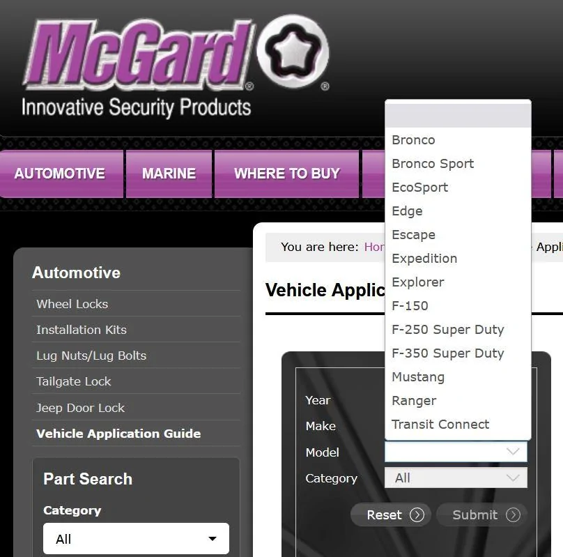

Maybe, after a year, you can convince McGard to update their application info, so people don't have to try and determine on their own what model # to use? -- HRG
Annoying, isn't it? I had to put in a 2021 Ford Edge, which uses the same 14 x 1.5 thread, cone seat, popular Ford-style acorn bulge style lug nuts.
I would stick to the "bulge" ones since it allows a little more seating area to spread the load against those soft aluminum wheels. I'm told the non-bulge ones are OK, but preferable would be the acorn bulge cone seat ones.

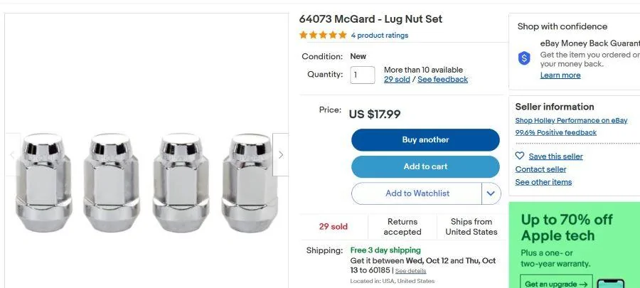

Holley Performance is selling the McGard 64073 on ebay for $17.99 w/free shipping.

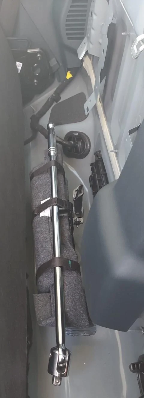

As for the lug wrench carried behind the back seat in the "kit", with me in case of a flat that a fix-a-flat spray-goo can won't cure, I think I'll pack my old Husky 24231 17"-long 1/2"-drive breaker bar back there, along with a special "Titan Products 21094 1/2in Drive 22mm Non-Marring Lug Nut Socket".
On second thought, might as well get Harbor Freight Pittsburgh Pro 25" breaker bar for extra leverage on a rainy night by the side of the road!
The breaker bar and non-marring socket will be nice for roadside flats, after some tire technician puts on the full 148 lb-ft lug nut tightening torque, and for tire rotations in my garage.
(Note: I don't think the factory put on 148 lb-ft torque. I recently took 1 front wheel off & it didn't seem to be on their too tight.)
Getting the breaker bar, wrapped in some old cloth behind the back seat, right next to Ford's Maverick flat tire jack etc., with the non-marring 22 mm socket in a ziplock bag with the McGard locking lug nut removal key too. Roadside emergencies and at-home DIY tire rotations.
Then it'll be fine using the McGard 64037 22mm lug nuts. Those McGard's are like chrome jewels, & the aluminum wheels are too soft, so a non-marring socket is nice anyway to have.
Edit: That 25" breaker bar (leverage) I got fits tightly under the velcro and crank-strap of the tire changing kit behind the back seat Now I just need to put the McGard wheel lock key & 22mm non-marring socket in a padded bag behind it.
