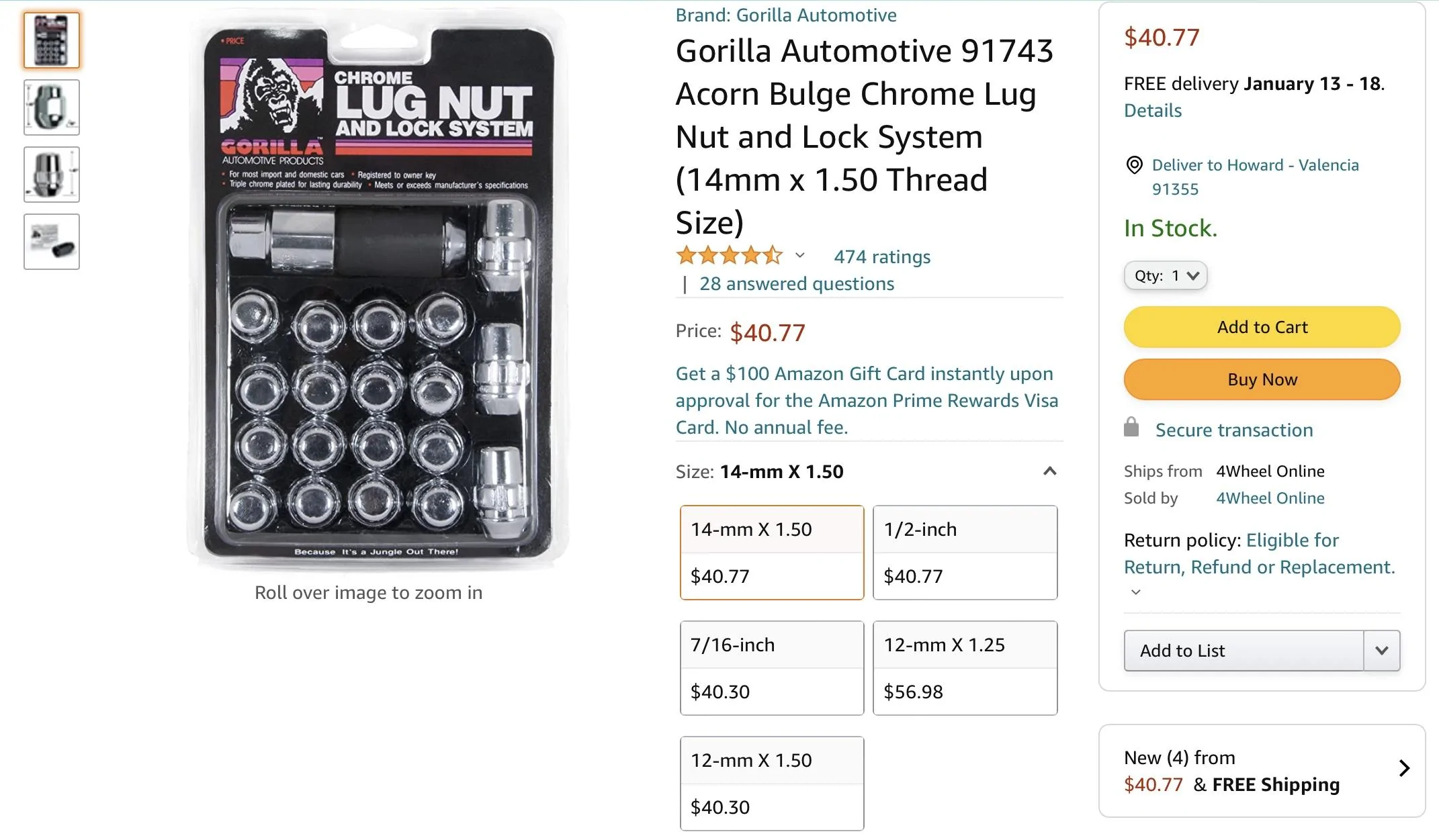

They did not fit mine cause I have center caps. They were too tall. They fit the hole but I couldn’t get the cap on so I went with open ended gorilla nuts

What length did you end up going with?

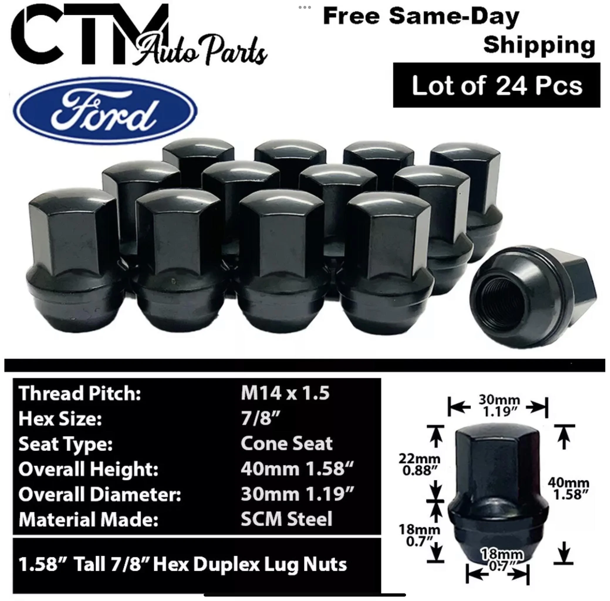

Yes, they are a little longer than the stock lugs. I think they look fine.
Bingo! Exactly what I was looking for. Lol, thanks for doing the 'leg-work'. They will replace the stock chrome factory ones on the stock XLT black wheels.
