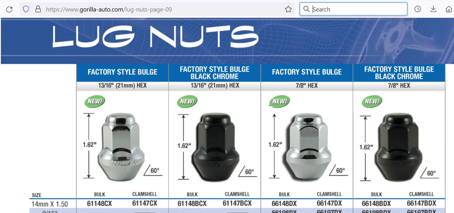

Just got this from Gorilla for Maverick.
HRG
These are not the two part lugs nuts that have swelling issues where the lug wrench no longer fits are they? I hate the cheap ones the OEM uses.

When I looked on the Gorilla lug nuts web site, it appeared that the correct parts were "14MM x 1.50, Acorn part # 71743"or "Acorn open end part # 70743", but I couldn't find those on Amazon.
I did find some similar ones, but nothing exact.
Which ones do I need?

This is what Gorilla sent me yesterday, for a Maverick.

So both black ones are the same? The measurements seem off, as 7/8 is bigger than 13/16.

You get your choice, if you want 7/8" OR 13/16" hex size. These aftermarket lugnut makers offer a lot more flexibility.

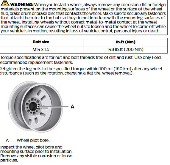

You better check that torque spec.its way to high.should be around 75-80 ft lbs
Wheel torque is 148ft lbs
