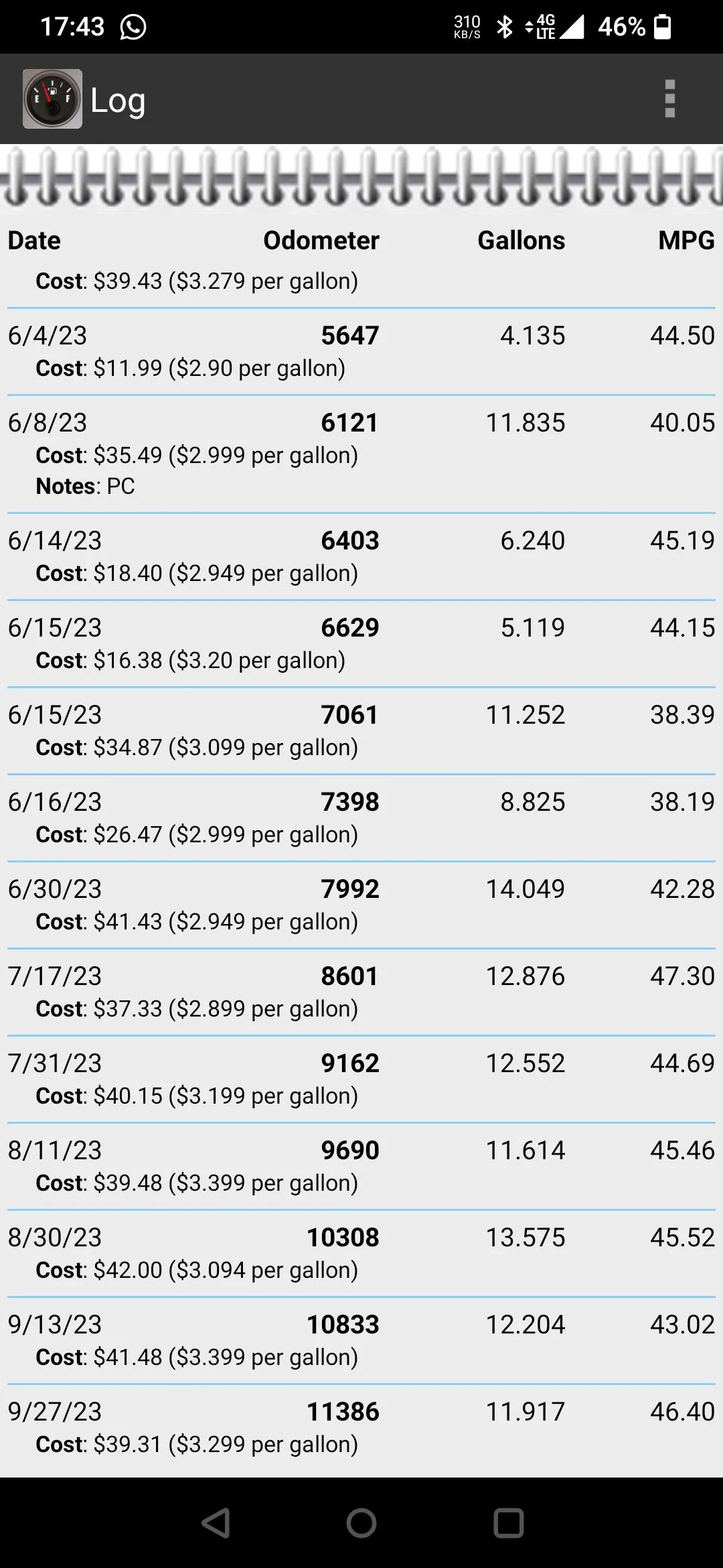

Just as I was saying... It will be hard to notice difference. It is hard to have stable reading with 87 to start with. I only use 87 as manual recommended. And it's hot in Oklahoma as you know...not issues with knocking or performance.
Ford Maverick Lower Octane Fuel Screenshot_20230929-174322
