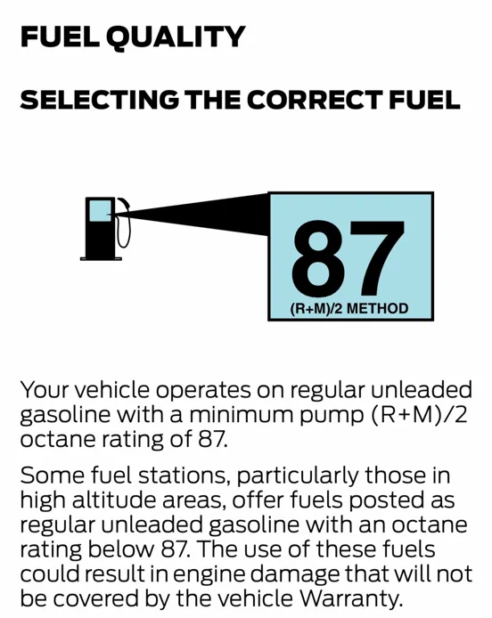

The manual is clear on this. Minimum 87 octane is not a "recommendation."
Just because "many people" believe something doesn't mean it is true, especially if they aren't warrantying your truck. :wink:
That was copied and pasted by FORD as common boilerplate for all vehicles.
My manual also tells me to check the under hood battery in my Maverick. I don't have an under hood battery.
