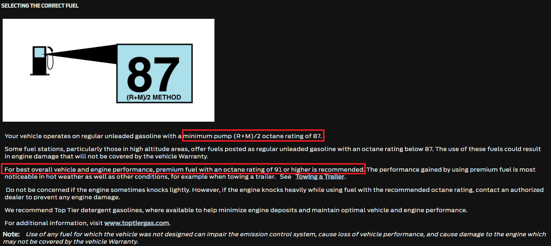

No it does not.
The manual says the Maverick runs on a minimum pump octane rating of 87, meaning don't use anything less than 87.
The manual does recommend using 91 or higher for best overall vehicle and engine performance.
Whether an owner feels it is worth their money to fill with a top tier fuel an octane rating above 91 is entirely up to them.
Ford recommends it, but owners can get by on the minimum too.

No it does not.
Whether an owner feels it is worth their money to fill with a top tier fuel and octane rating above 91 is entirely up to them.

It says you can use 87 and considering the cost I dont need to spend more than the inflated prices anyway. I would like to see dyno results that show the power gains from using premium.
It isn't power gains from using 91 or 93 - it is power lost using 87.
The torque ratings are from using 91.
