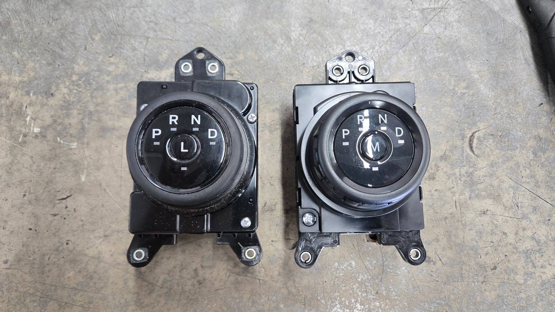

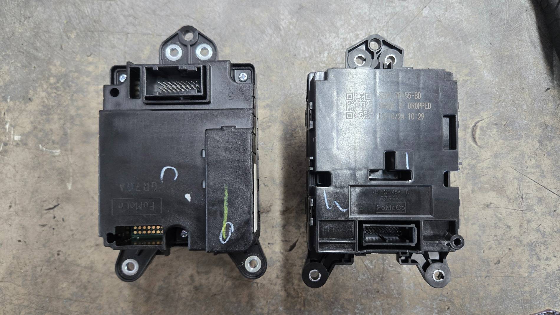

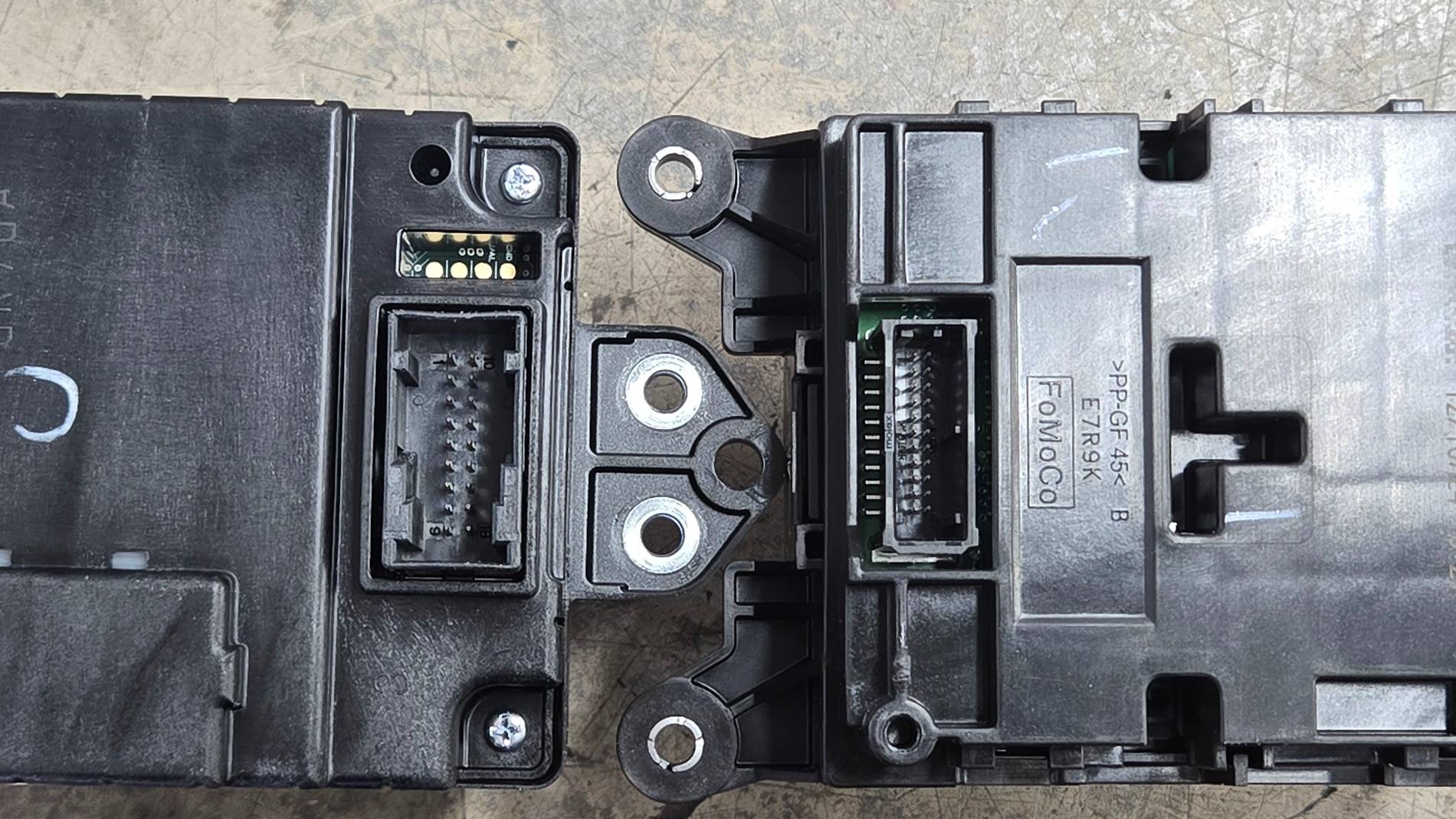

Well if anyone else was wondering if the LOBO shift dial would work in the 22-24 Mavericks you'll be sorely disappointed like me. The 25+ Gear Shift Module (GSM) has a smaller, 22-pin connector compared to the 18-pin connector from the 22-24 Mavericks.

Bummer. Do you at least think it's possible to crack open those two shifters and swap the "L" button for an "M" button? If people eventually figure out how to program the button function to activate a manual mode, I'd still be a stickler for wanting the right letter on it. :D

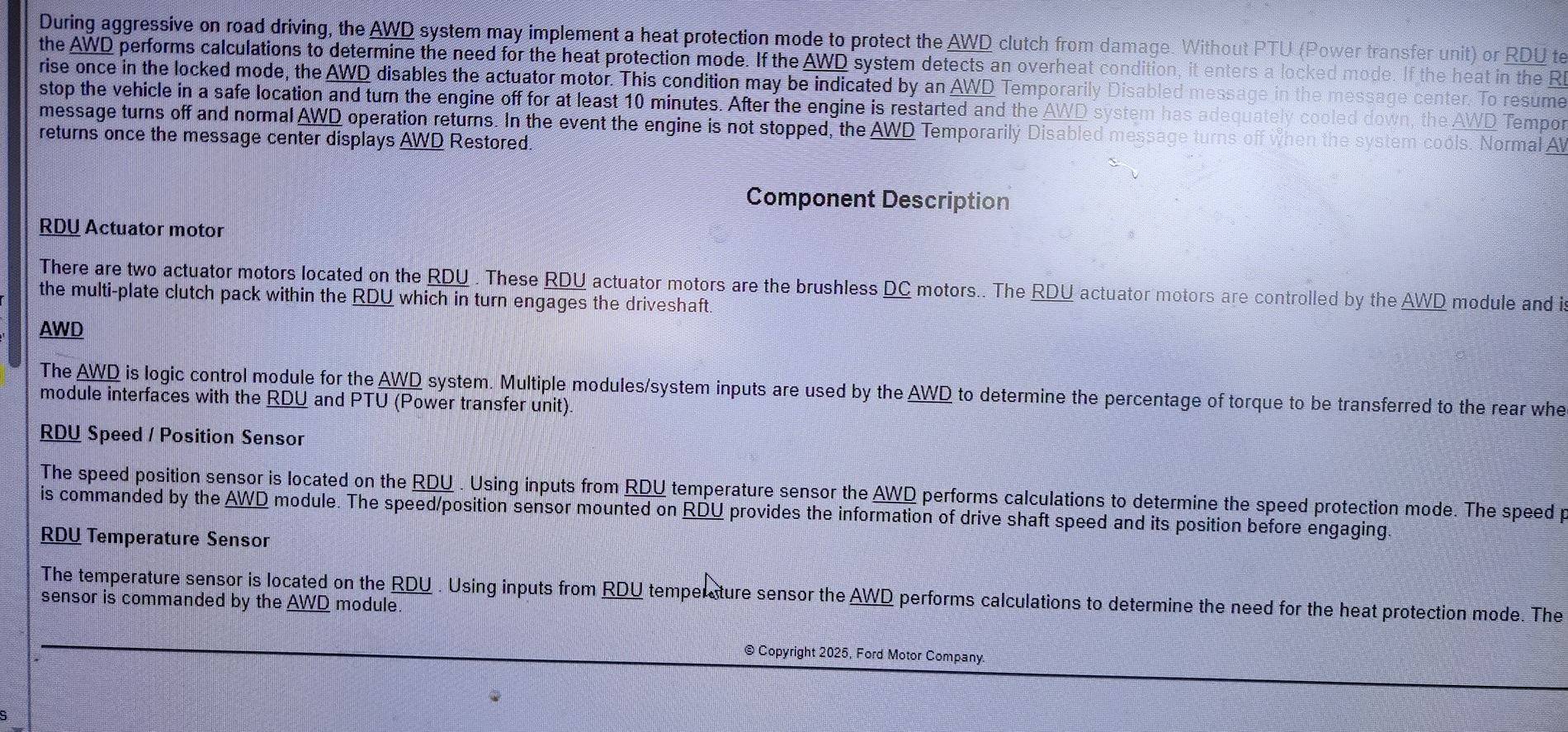

Does the 2025 LOBO have differences in the physical AWD system compared to the standard 2025 Maverick AWD? Several lines of coding have differences regarding the AWD system when comparing the as built data.
Same but diffrent configuration du to the new rear differential been doble motor.
