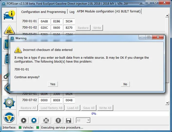

2. What is meant by "let Forscan correct the checksum"? I've made changes before and I don't recall clicking anything
about "let Forscan correct the checksum". Where is this?

So when the OP writes "...let Forscan correct the checksum", he really means click YES to "Continue anyway" as Forscan isn't correcting anything?

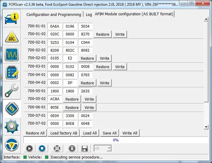

One final question. After making the changes is it necessary to click either "Load All", "Save All" or "Write All" showing toward the bottom?
Write All will make the changes to the truck. I'm not sure what Load All or Save All does. I do know that the Load Factory AB button is supposed to go out to the Ford site and reload all of the factory settings for that section, which you can then write back to the truck.
