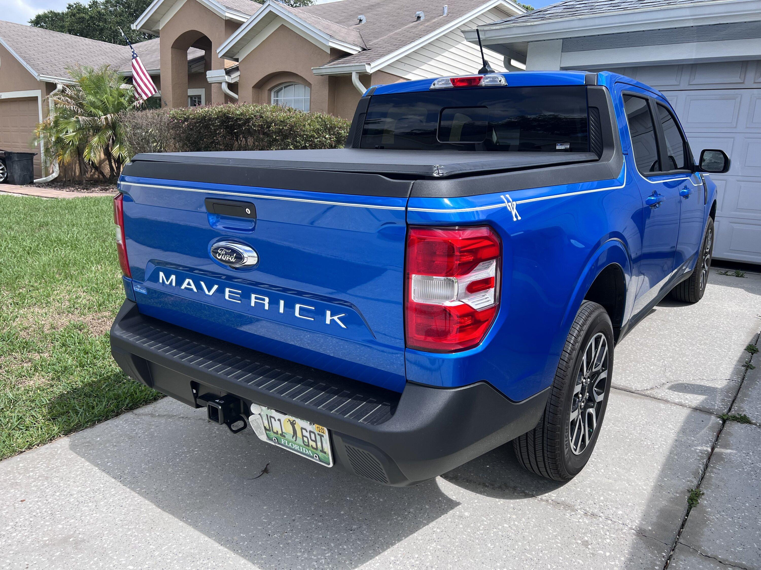

I have an EB Lariat in central Florida. Get 24-27 mpg running around as I am retired. Last August I got 32 mpg from a road trip to Louisville KY. I am very happy with the Lariat’s performance as I drive in economy all the time.
Ford Maverick Let's talk numbers. Hybrid vs Ecoboost $$,$$$ 7090AC24-118B-4116-AB85-0785B5AEED48

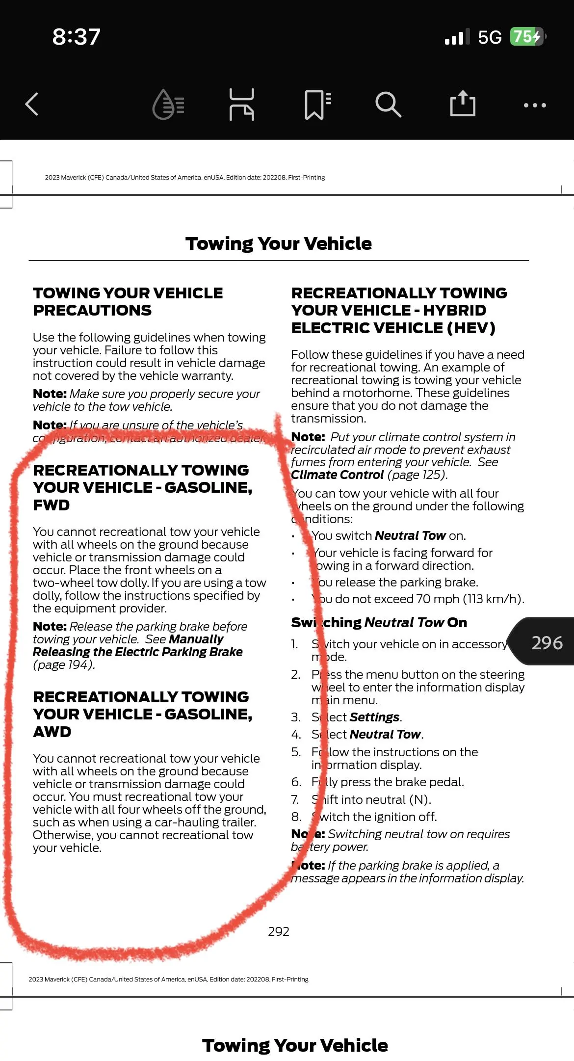

Dang, really??? Fuel mileage? You should all drive what I drive… a 32’ class C motor home, E450 chassis, v-10 triton. On a good day, 9 mpg. But the real reason we want the hybrid is because it is flat towable behind the motor home where the EB can not be. It has to be on a tow dolly or a trailer… in the mean while while we wait on it, we are driving and towing our 2007 Honda CRV.
Not true. The EB also comes in a 2 wheel drive.
