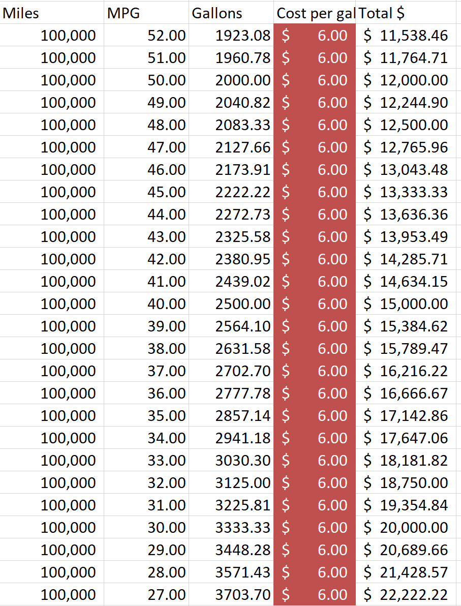

Some hybrid owners need a n additional chart, almost 4000 miles and only one fill up below 50 mpg figured by calculator.
no problem, Here is up to 52 mpg

Next, I got home and asked myself. Why I got 2WD ? I always had AWD or 4x4. my answer was simple. I wanted to save money. I wanted a car under 20k that takes 42 mpg. I WAS WRONG.
I should have put those numbers in excel before i purchase hybrid. i could pay 5k more and get ecoboost 4x4 option and spend extra
$2,604 in fuel per 100k.
I assumed cost per gallon in $3.50. Driving hybrid 100k miles will cost $8,333 on EB 100k $10,937. Depending how and where you drive what are your calculations? Why would you choose EB vs Hybrid or Hybrid vs EB? Thank you!
but at 24MPG it is $14,500, My current auto has 260,000 miles on it

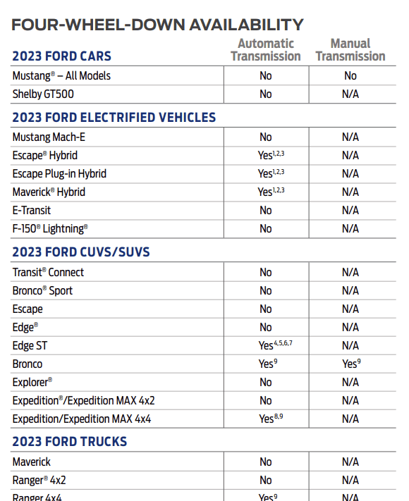

Are you all sure about the 4-wheel RV tow? The guide specifically states that 4-wheel is not an option and only FWD can be dolly towed.
https://www.fleet.ford.com/content/...2023_Ford_RVandTrailerTowingGuide_r1_Dec1.pdf (pg. 15 and 16)
The ONLY Maverick that can be flat towed ( all four wheels on the ground for extended mileage) is the Hybrid. Very clearly stated in the owners manual ( including the 2023 version ) and in the chart listed above. The "1,2,3" listed is about the process you have to go through in the menu to ready it for flat/rv towing. The front wheel drive Ecoboost Maverick CANNOT be flat towed, 8 speed automatic transmission won't allow it.
The Hybrid Maverick is indeed listed for tow dolly ( front wheels on dolly ). The front wheel drive Ecoboost should be on that list, probably an oversite by Ford. I have not heard of a front wheel drive vehicle that cannot be towed on a tow dolly with front wheels on dolly.
None of the All Wheel Drive Mavericks can be flat towed or tow dolly towed as they come from the factory. This applies to the Escape Hybrid and Ecoboost also.
