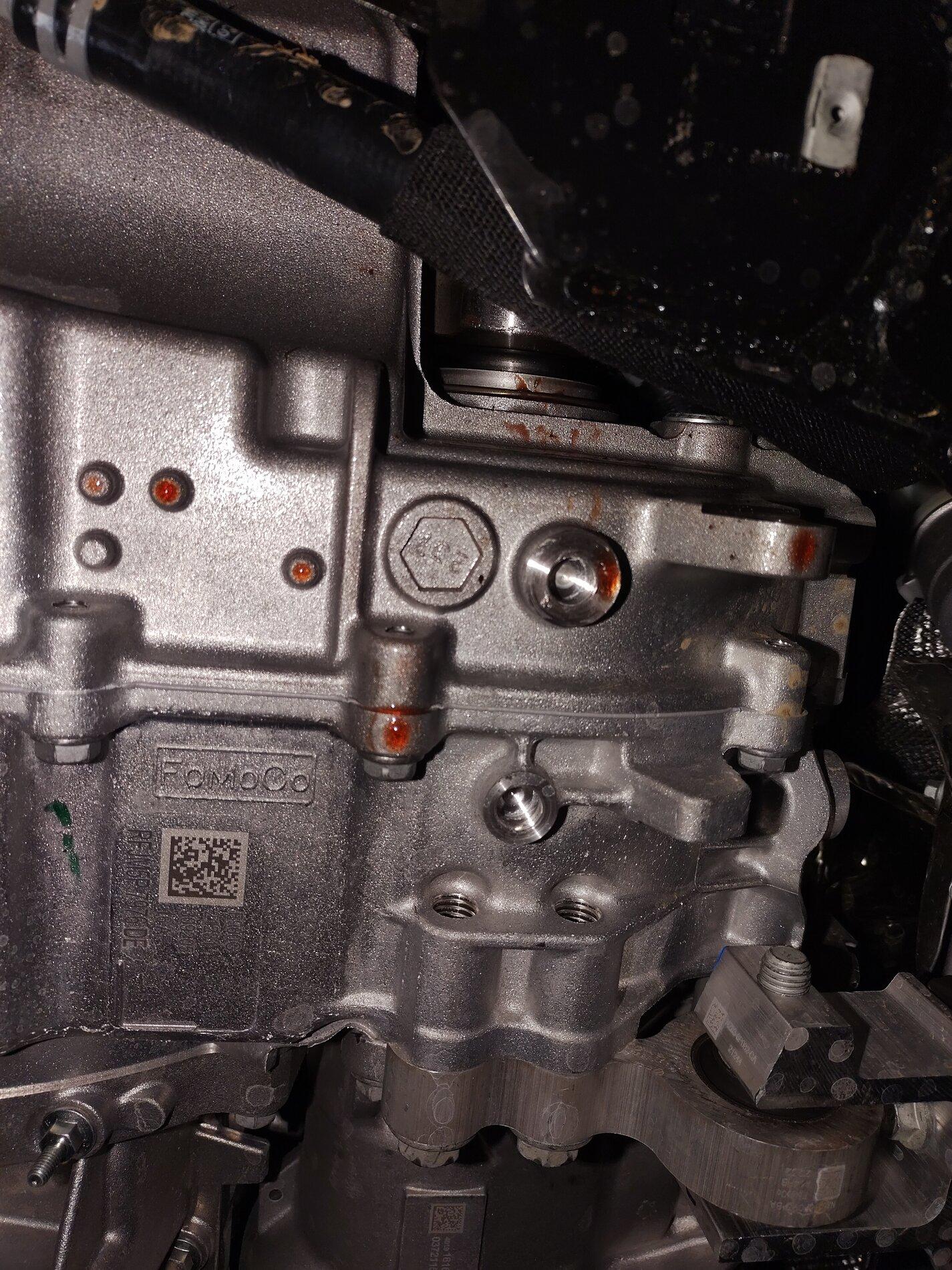

Update update update:
Just got it back from the dealer again after sending them 4 videos of the issue. They had it for over a months, replace a start/stop transmission module and just ended up replacing the transmission. So far so good.
Update update: I got it back from the dealer a couple days ago and now it started hesitating to shift and even slipping so bad it can barely move at 3000RPMs. Thats right the dealer managed the make it 100x worse. Beaides the transmission fluid I couldn't even tell it was leaking before.
Update: I took it in and am glad I did. It has a leaking Axle seal and its going to take 5 days for them to get one of the clips in.
I was In the process of doing the first oil change on the Maverick (1000 miles) only to find this after removing the felt cover. Any thoughts?
