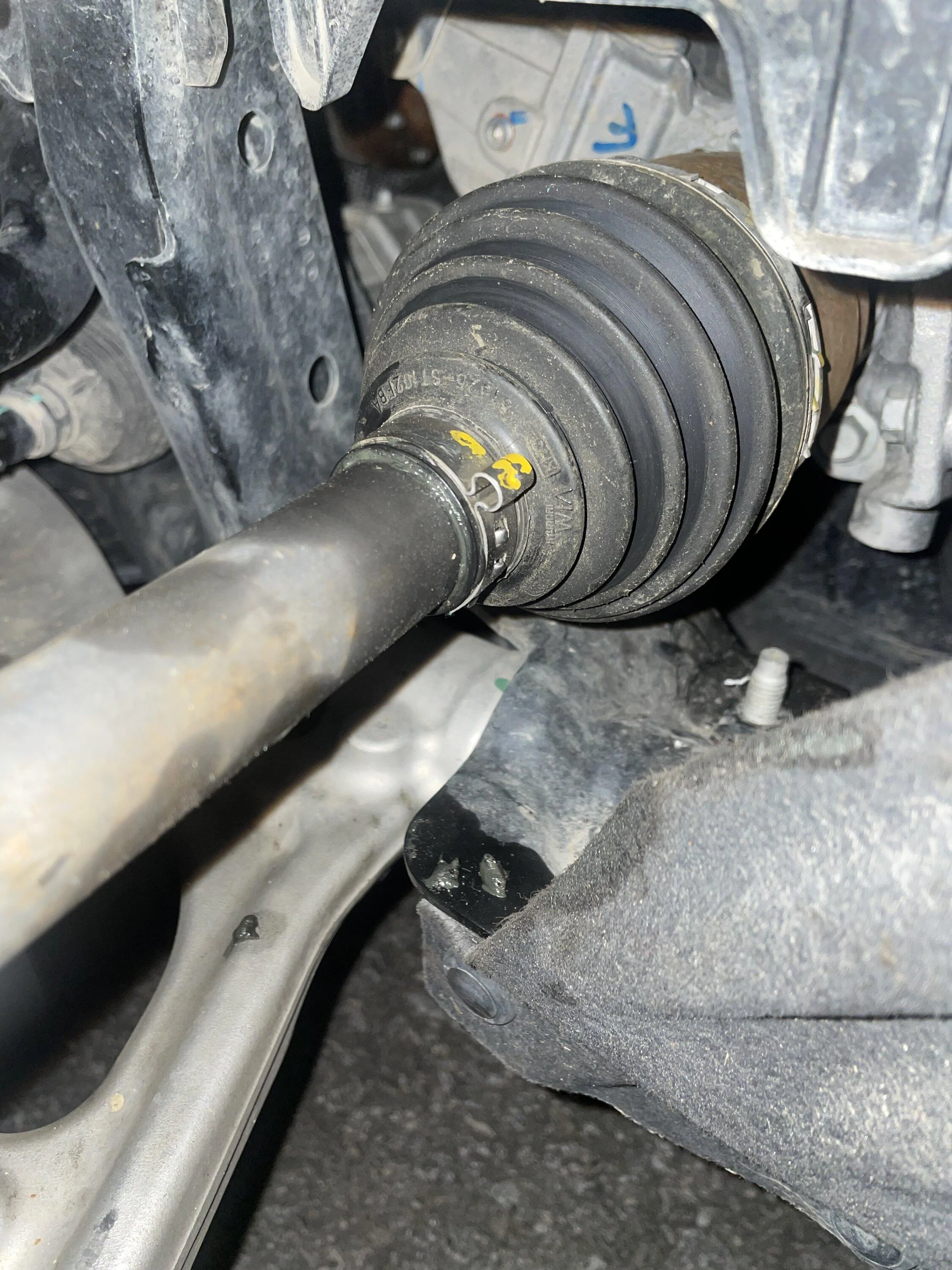

Axle leaking
NoVaJimmy
Apr 29, 2022
1,552
2,454
KCMO
Lexus GX 460
Lift Springs for the win -
I don't even have a lift and the boot is leaking, also, what makes you think the lift springs don't introduce similar axle angle issues? (I'll give you a hint, they do)
Also, the clamp isn't even clamped down properly, way to go Ford suppliers......

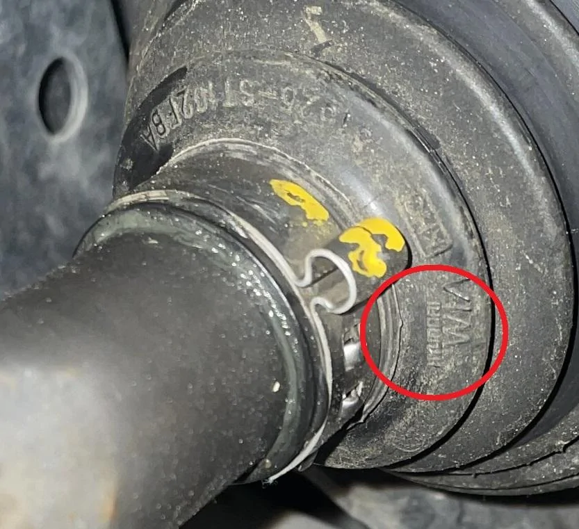

I zoomed in on the photo from page 1 and look at what I found! Like I said, that clamp is not properly fastened, it should be flat on top and I feel like the bottom part should be butted together. Maybe this is some corporate sabotage for a competing product? :ROFLMAO: You can also see the "KMC" which I believe is for Kia Motor Company

Hi, I believe that band clamp is tightened as much as possible (for that clamp). It appears the inner (bottom) hooks of the band band are tight against the (2) windows on the top portion (touching the left side of your red circle). I don’t think that an attempt to re-crimp would help. Perhaps a different clamp.?
That also doesn’t appear to be a traditional (Dorman, etc.) boot clamp. They are generally flat on top until the tool crushes/tightens it. That clamp pictured is completely round on top (yellow paint).
Good luck...

Okay but it clearly has "Hyundai" molded into it. Also, from my experience with these clamps the tool required for installing has an anvil that drops down as the bottom part is pinched together and it flattens the top I'm guessing for better strength. These clamps are not great anyway and supposedly the tension fold over style is superior but I'm not surprised to see that Ford skimped on yet another part of the Maverick. I would hope that part of the Tremor upgraded half shafts include better CV boots and clamps. Lastly, from a production standpoint, if your assessment is correct, having two different QC people with the same color QC marker would be the dumbest process ever.

Also, you're incorrect and so was I, KMC doesn't have anything like that listed on it's product page and I found out that the mark actually reads KHC, it's a Hyundai Kia part.....I found out because I was researching to see if leaking CV boots are a common problem with Hyundai products.
